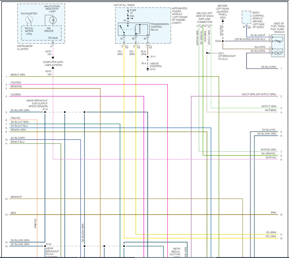

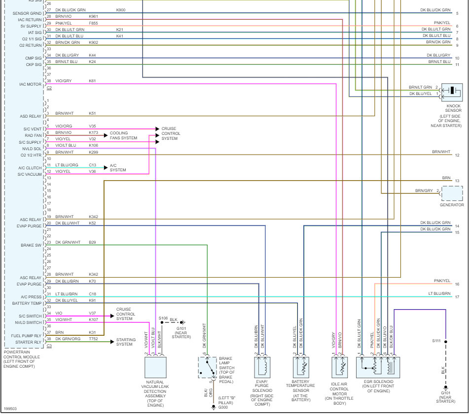

I have not been able to find connector diagrams. O2 connector to computer. No power to sensor.

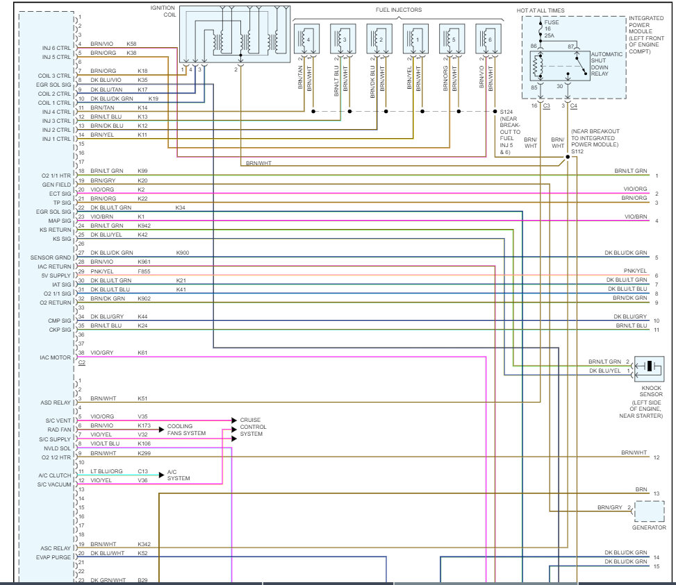

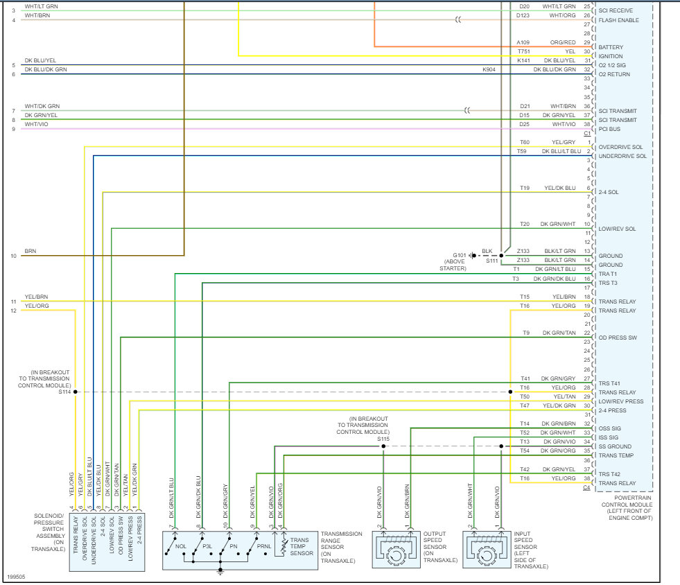

Here is the wiring diagram you requested. The H02 sensors are wired to the PCM (Power-train Control Module) I've attached engine wiring diagrams below. Here is a link for a tutorial showing how to test wiring:

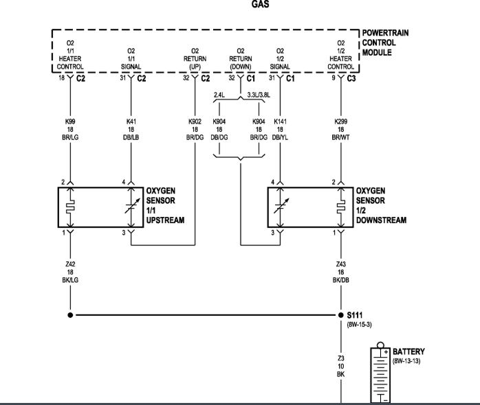

I need the connection at the other end. TIPM. Thanks

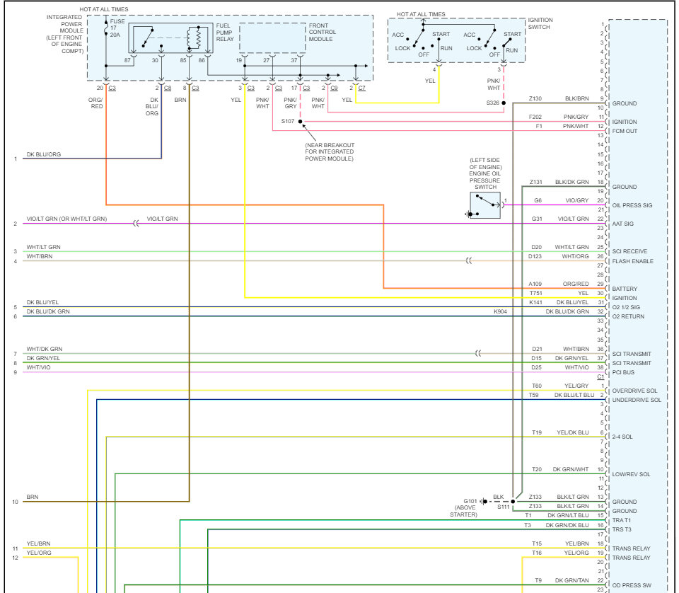

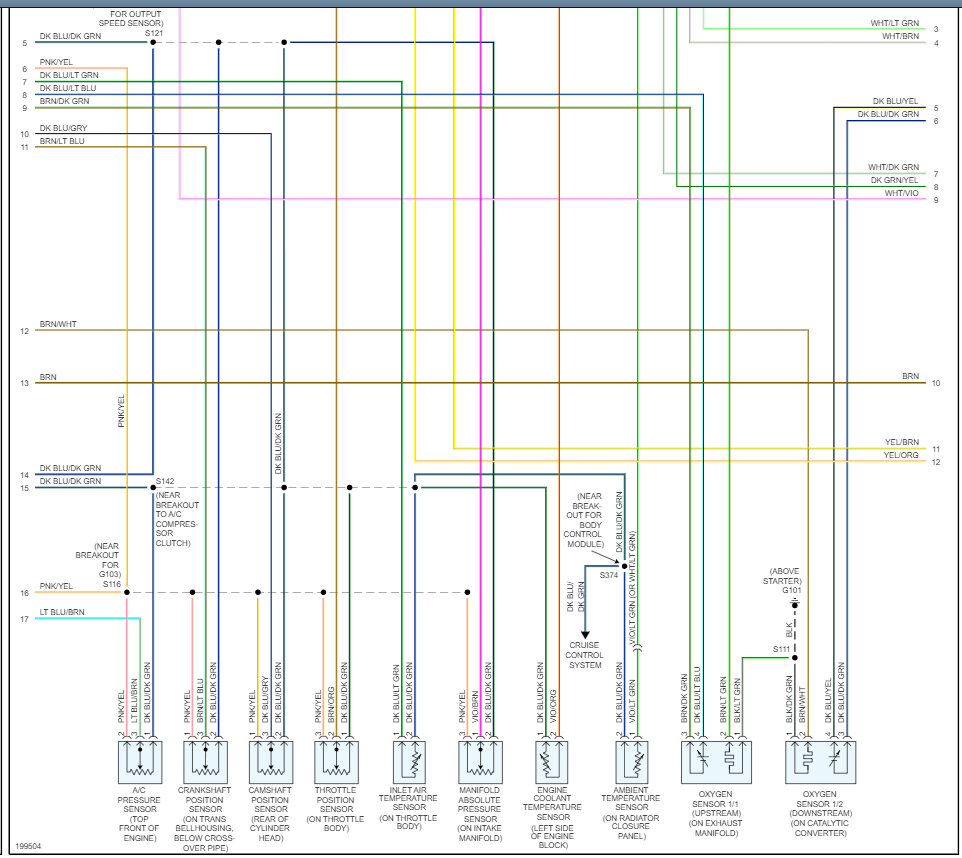

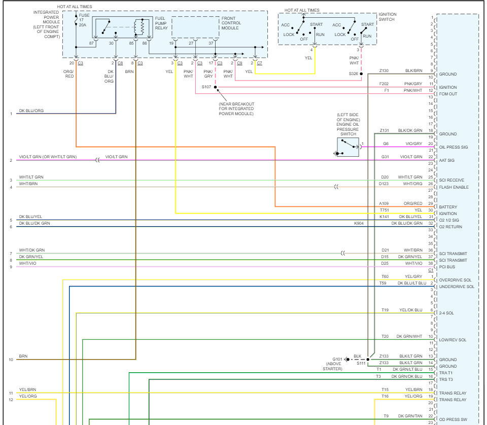

I attached the wire diagram for you to view.
it shows the O2 sensor's wiring back to the PCM.
The TIPM has no involvement in the operation of the O2 sensors.
