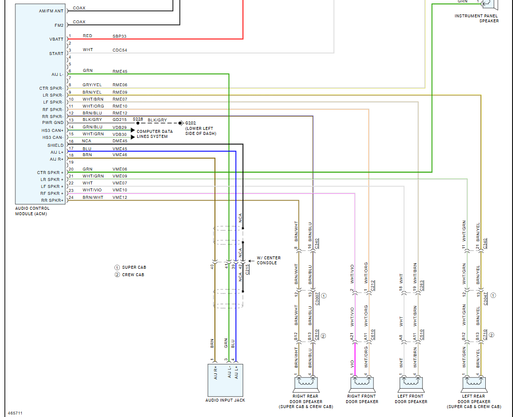

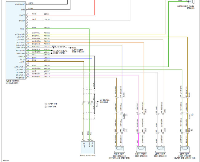

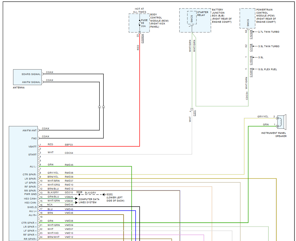

Wiring diagram for the radio climate, parking brake, reverse wire needed?
2015 FORD F-150
189,097 MILES • 3.5L • V6 • 4WD • AUTOMATIC
PLACES MARK
Looking for parking brake, reverse and speed control wire.
Sep 1, 2025 at 4:46 AM
  • 55,433 POSTS
We only handle one problem per thread. please start other threads for the additional systems. Here is he wiring for the radio. Please post your new question here, you must be logged in.
Check out the images (below). Let us know if you need anything else.
