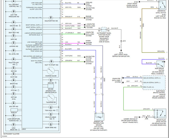

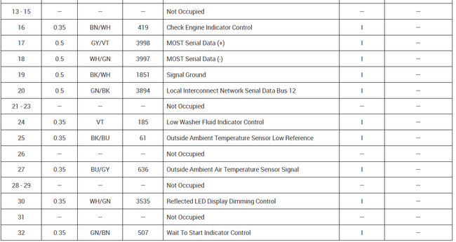

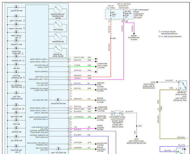

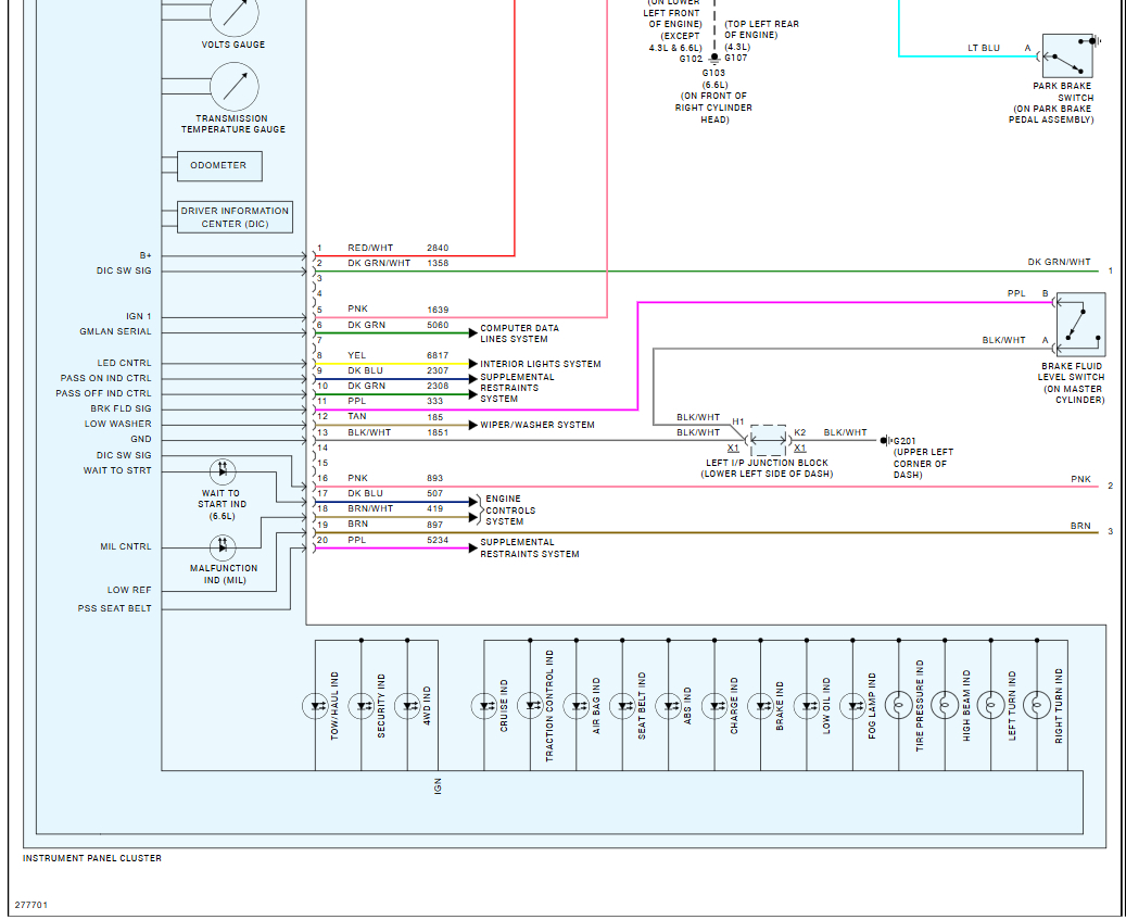

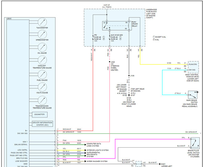

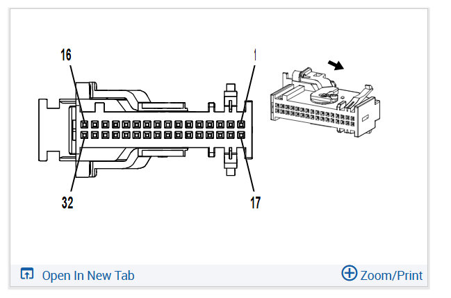

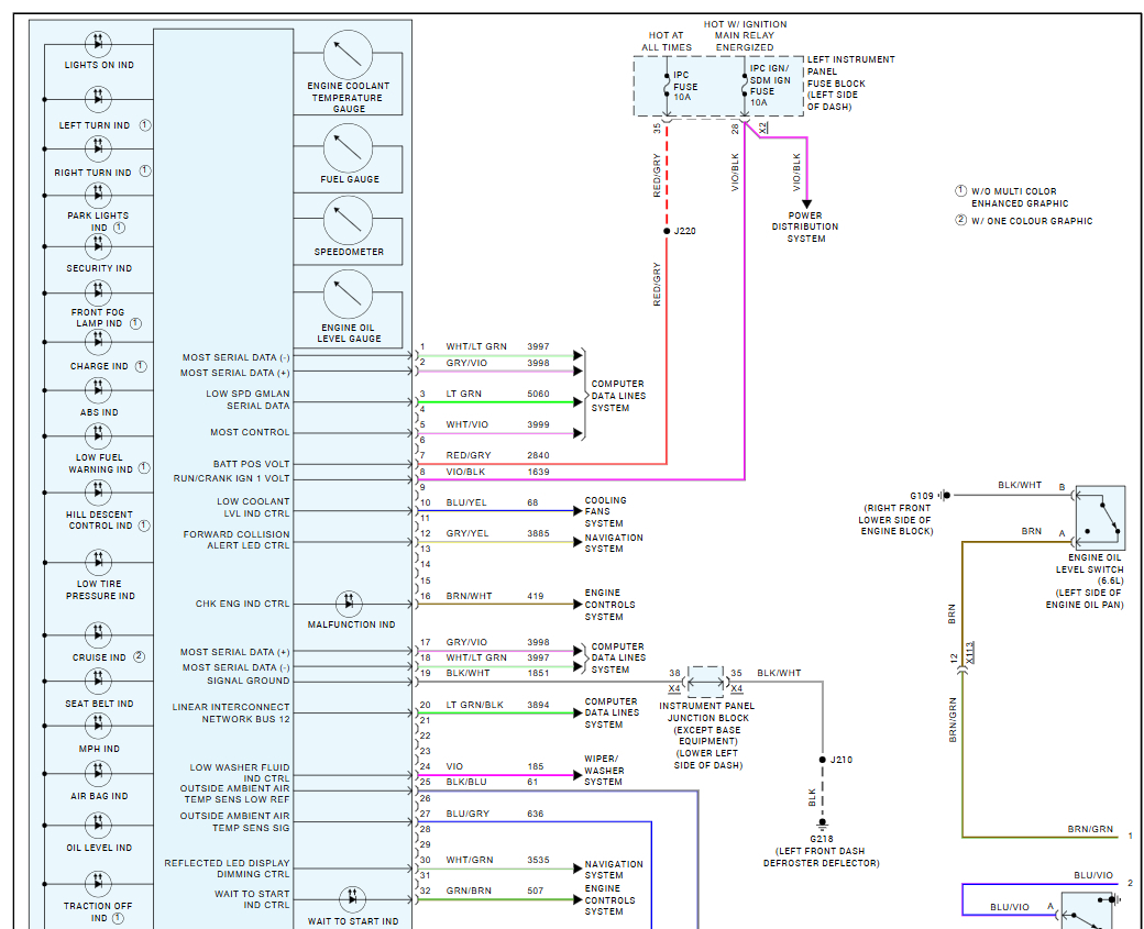

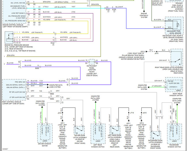

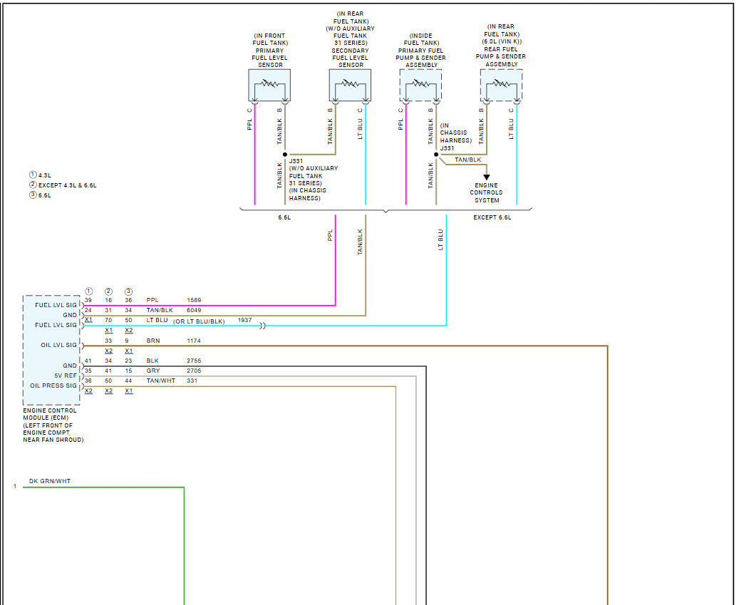

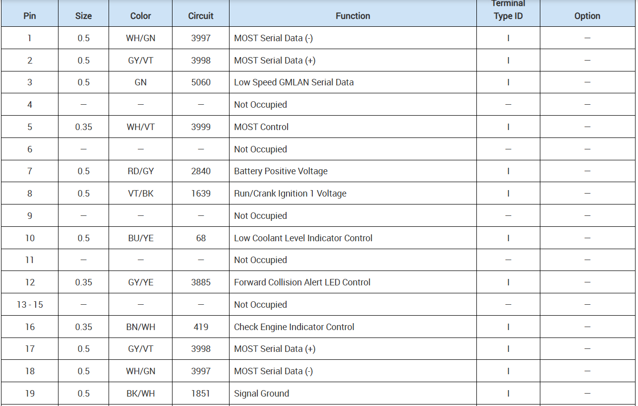

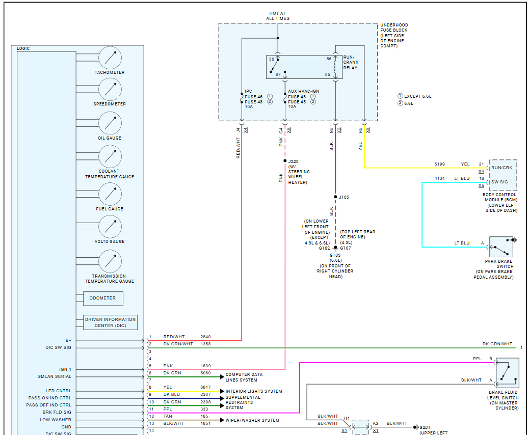

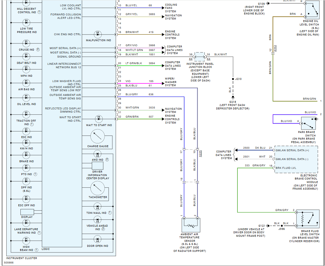

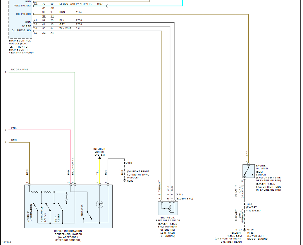

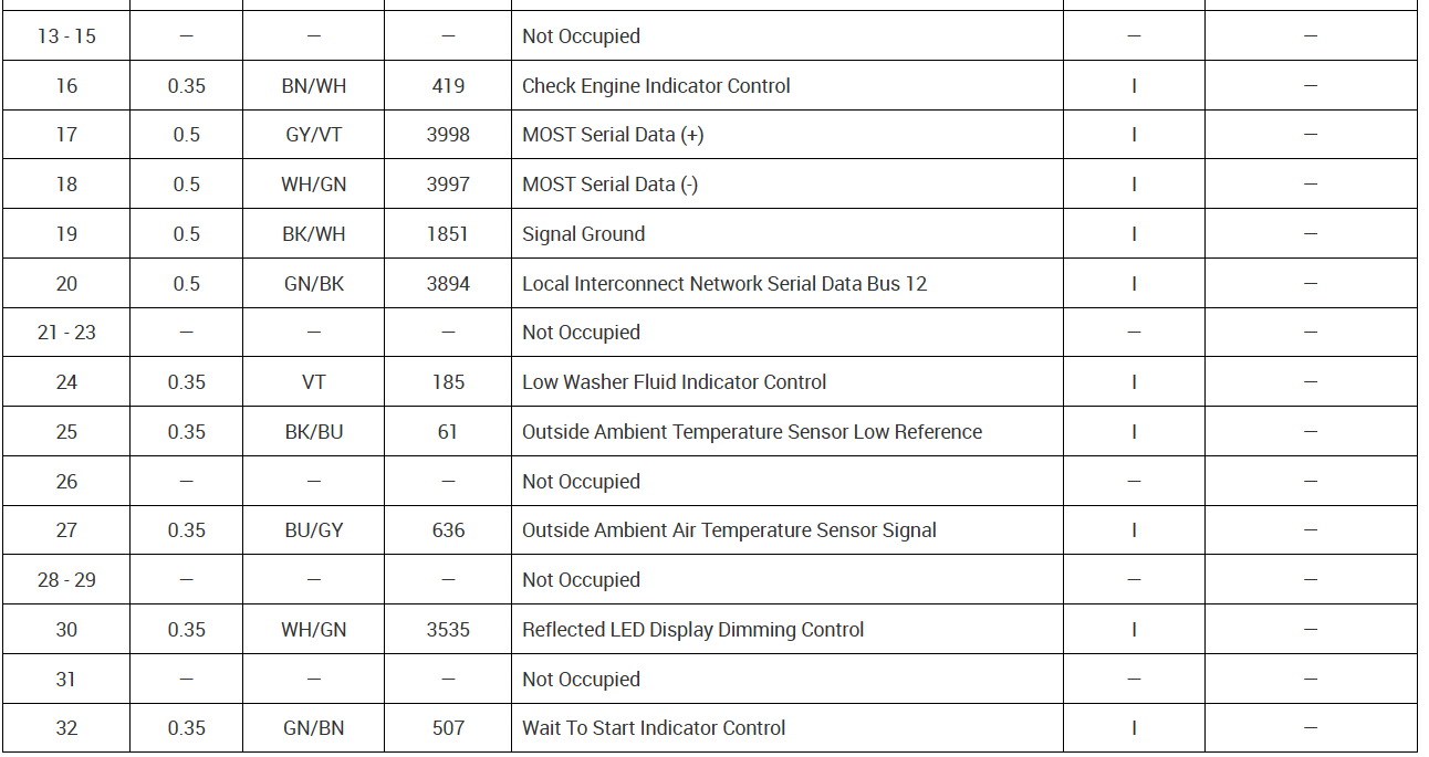

Hey guys, instrument cluster is not working. so, I am trying to find a wiring diagram/pinout on the instrument panel/cluster for the truck listed above. On the harness for the dash. where do all of the dash plugs run to? the BCM? Do they all connect into one plug that attaches to something or each individual plug plugs into a module or fuse block?
Nov 17, 2024 at 8:17 PM
  • 55,594 POSTS
This wiring diagram for the instrument cluster will show you where anything goes. Check out the images (below). Let us know if you need anything else.

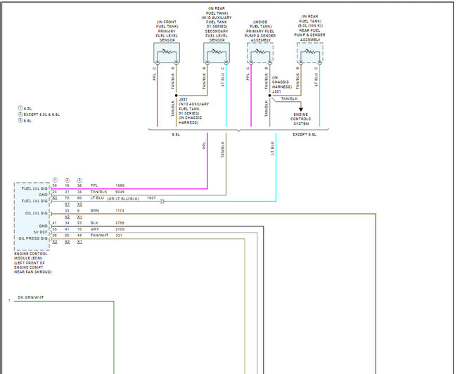

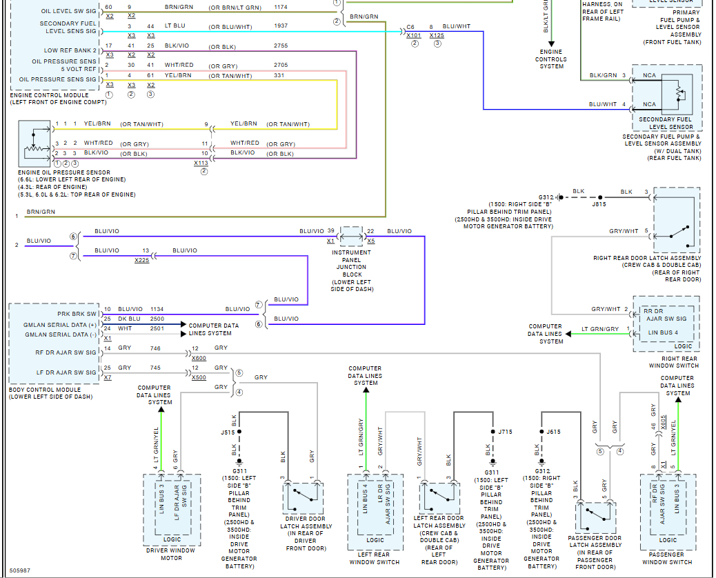

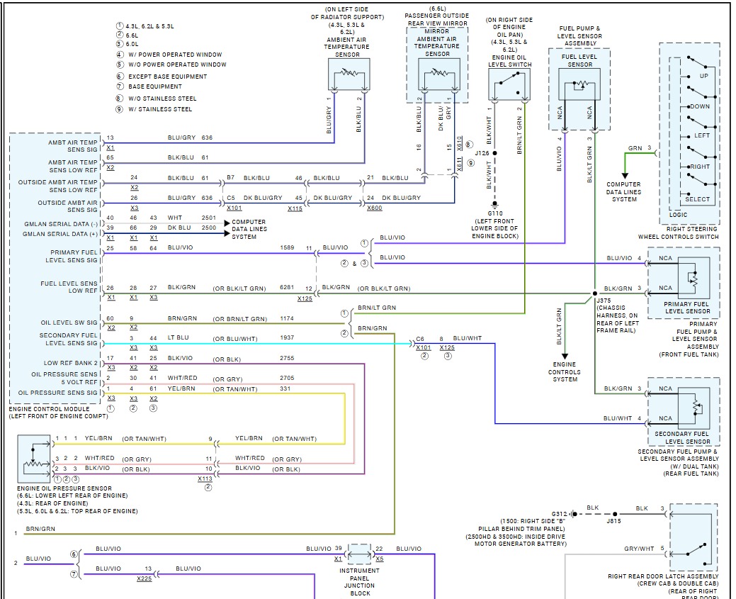

Awesome! Thank you. So, if I were to splice this instrument panel(the whole dash harness) in with a 2008 Chevy Silverado… what wires would not have a mate? I understand that this is a newer model dash that has more gadgets than my 2008… but all the power and ground wires should be the same, correct? After reading your other articles also, I am going to check the grounding from the fire wall to the motor along with the IPC fuses and fingers crossed I will get power soon.
Nov 23, 2024 at 2:08 PM
  • 55,594 POSTS
Some wires might be the same, here are the 2008 chevy truck instrument cluster wiring diagrams so you can compare. Check out the images (below). Let us know how it goes.
