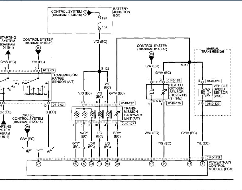

Hi Ken,
Need your help on wiring diagram from O2 sensor bank 1 to PCM.
Thanks
Aug 13, 2019 at 4:05 PM
DANNY L
  • 5,648 POSTS
Hello, I'm Danny.
Here is the wiring diagram attached below per your request. Here is a tutorial for checking wiring and oxygen sensor replacement:
https://www.2carpros.com/articles/how-to-replace-an-oxygen-sensor
Hope this helps and thanks for using 2CarPros.
Danny-
Aug 13, 2019 at 4:15 PM

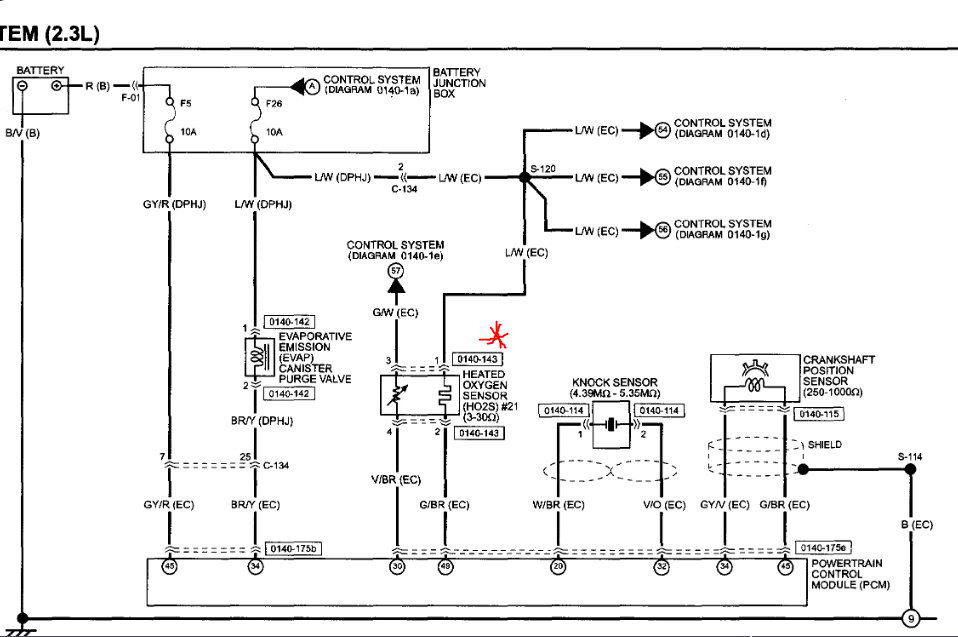

TAGZ
Hi Danny,

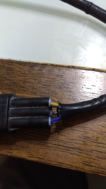

Thanks for the fast response. Here's what I have done to test the O2 sensor. Initially with P0134 code no activity bank 1 sensor 1.
1. Tested the sensor Okay with 3 ohms
2. Power is good on O2 connector.12v
3. No ground obly 4mv
Replaced the sensor and cleared with scanner still same code P0134.
My O2 sensor have 5 wires. Power is present on the Blue wire. Which one is the ground to PCM?
Wire color blue, yellow, white, grey and black.
thanks
Aug 13, 2019 at 4:34 PM
DANNY L
  • 5,648 POSTS
Hello again.
I've attached a wiring diagram below.Hope this helps and thanks again for using 2CarPros. Let me know if you need anything else.
Danny-
Aug 14, 2019 at 10:38 AM
