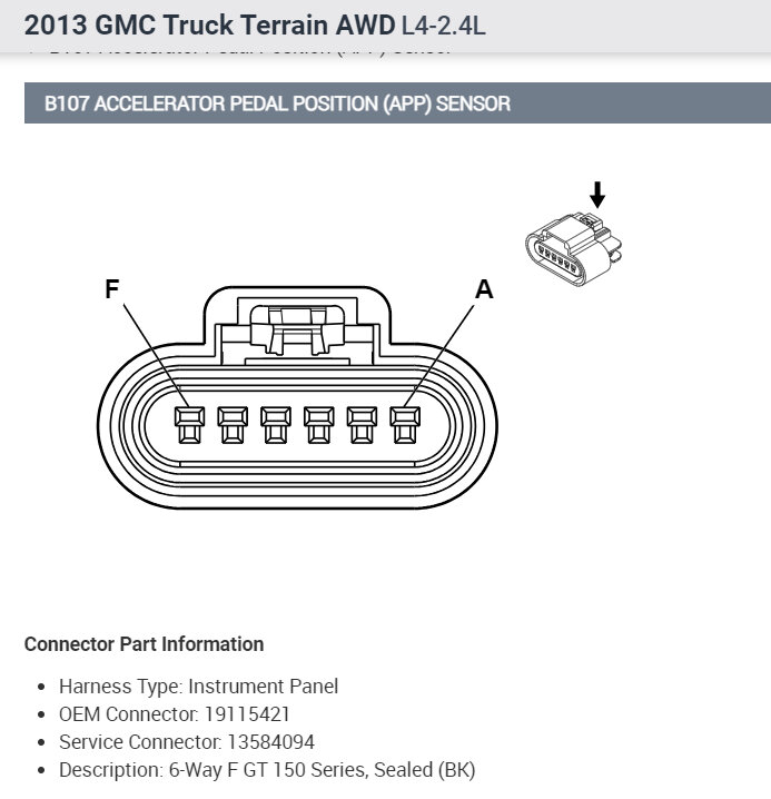

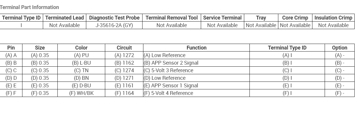

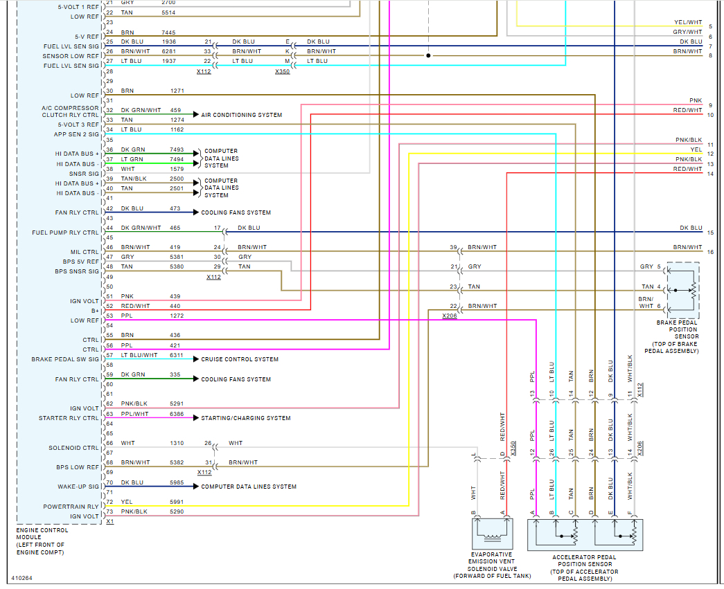

Wires on my car have been cut to the accelerator pedal position sensor and had to get a new connector. I don't know what the 5 wires actually are so how can I connect the connector without knowing the 6-pin wiring diagram.
Aug 3, 2023 at 12:46 AM
  • 55,845 POSTS

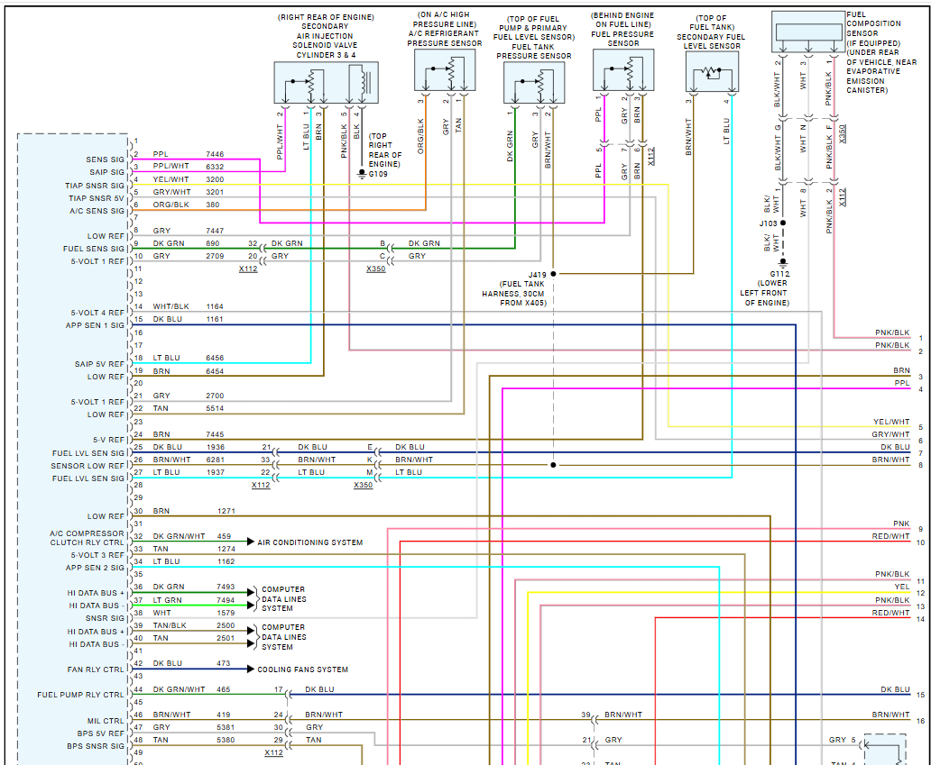

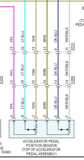

Here is the connector view and the wiring diagrams for the accelerator pedal position sensor. This guide can help you with the test of the connections:

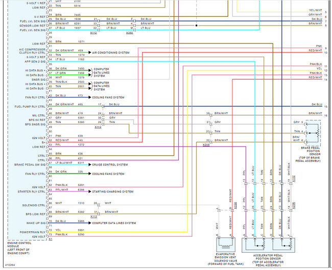

Hi Ken! I'm not Annette, but I was able to confirm the 5V reference voltage isn't being supplied to circuit 1274. Thank you very much for the information above!
I'm going to try to find where that circuit begins so I can isolate where on the wire I have damage. From what I saw, the unwrapped portion of cable seems to be in good condition between the engine bay connector and the pedal connector, but I'd like to verify continuity with my multimeter. Then it's from there back to whatever supply it gets.

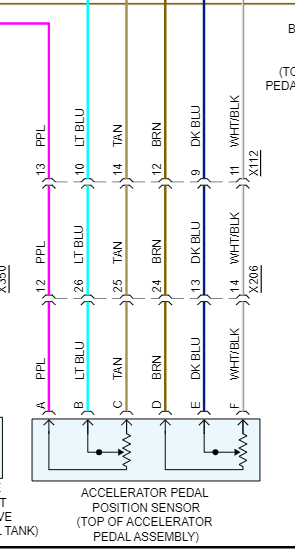

Here is the wiring daigrams for the accelerator position sensor and a guide to help you with the testing.
Sorry for the repeat, the site had a problem but it is fixed now. Check out the images (below). Let us know what you find.
Oct 7, 2025 at 4:01 AM
Suggested Repair
Use the accelerator pedal position sensor connector view and wiring diagram to identify the pins. Trace circuit 1274 for the missing 5V reference and verify continuity from the pedal connector back to the supply.
