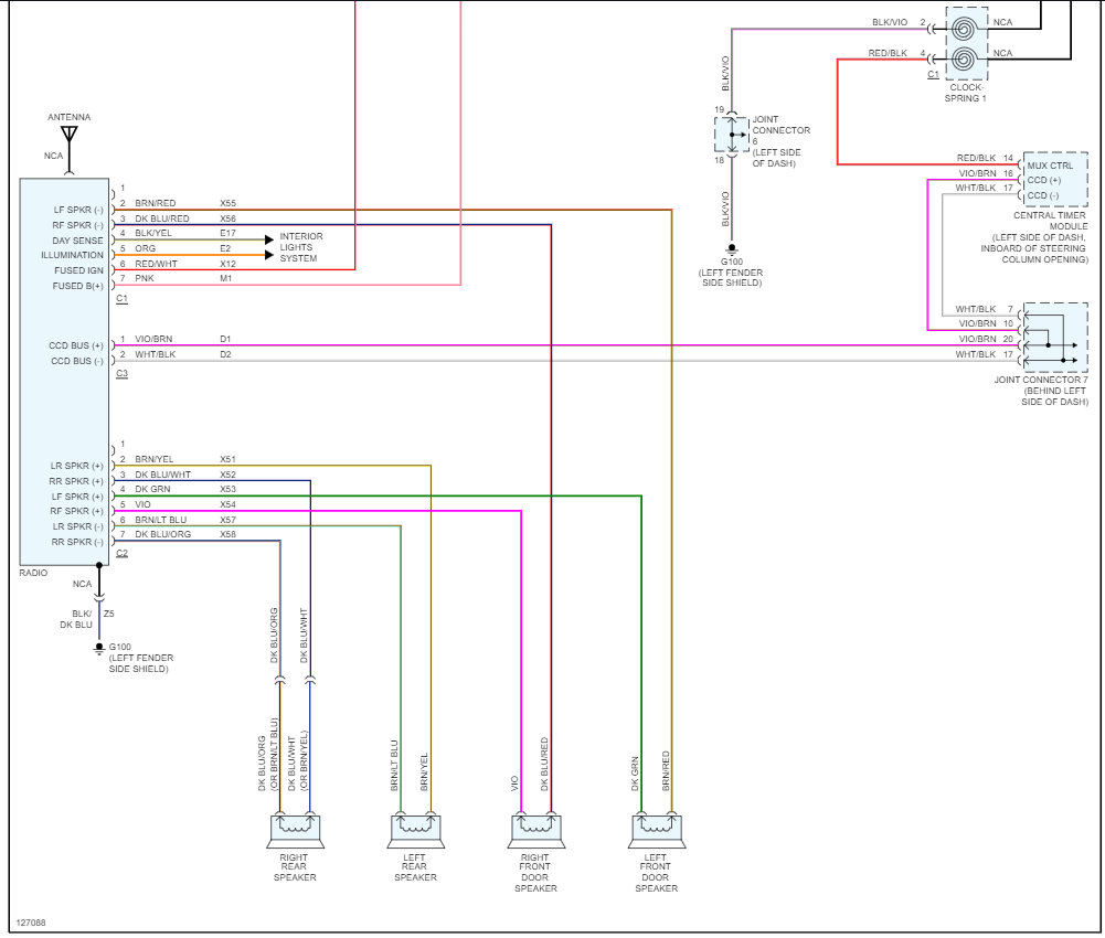

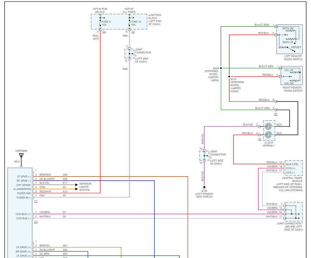

Can I get the wiring diagram for the radio cassette player?
2000 DODGE RAM
88,000 MILES • 5.9L • V8 • 2WD • AUTOMATIC
GOGO17

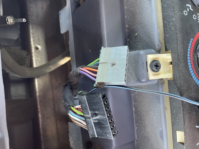

I’m replacing the existing radio with an aftermarket radio, I need to know the wiring diagram for the two seven pin plugs. Thanks
Jun 25, 2023 at 2:24 AM
  • 55,433 POSTS
Sure, here are the radio wiring diagrams as requested. Check out the images (below). Please let us know if you need anything else to get the problem fixed.
