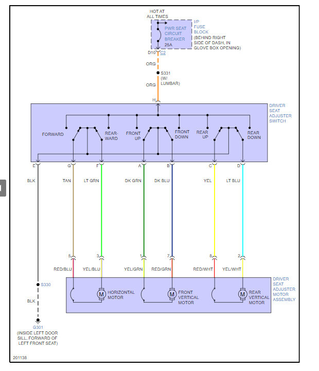

I need the wiring diagram for the driver seat power switch and motor. The seat was rusted and moves forward and backward with difficulty, but it does not move at all up or down. When the switch is turned on, the sound of the motor is heard but nothing happens. I am assuming mechanical problem but would like to test each motor separately.

Yep, what happens is the seat position motor drive cable can break but here are the wiring diagrams so you can test the system.
This guide can help test for power:
