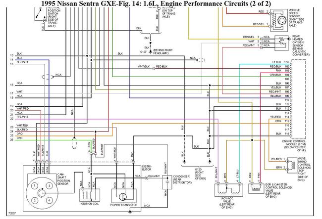

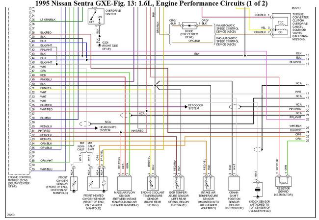

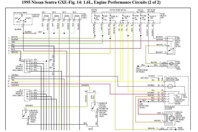

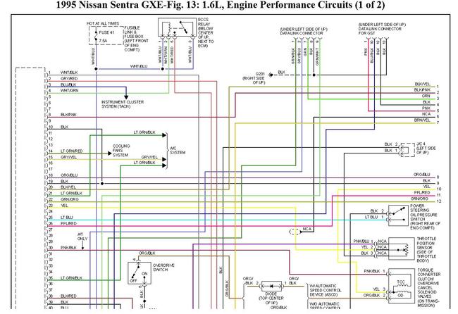

wiring problem, where the signal to the brain that need wiring diagram fuel supply to the engine for can find the wiring diagram for the car? I will be very grateful.
Aug 24, 2013 at 4:22 AM
KHLOW2008
  • 41,812 POSTS
Here are the engine wiring diagrams and a guide to help you test the connections
