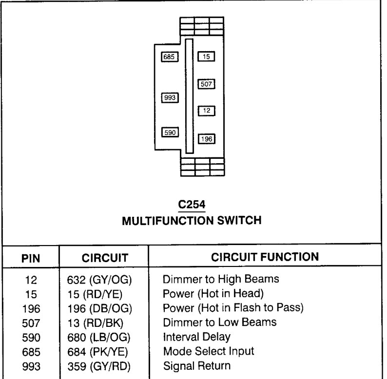

I was having an issue with the turn signals, not working when the tilt steering wheel was down, but when you tilted it all the way up, it started working again. My issue is that when I popped out the connector a couple of wires popped out as well and I am not sure as to where they go back in. I’ve been looking for wiring diagrams all over and couldn’t find anything and don’t want to start moving wires until I know which color goes where and really make a mess.

Sure, here is the connector view for the multi function switch, this should help fix the problem. Check out the images (below). Let us know if you need anything else.
