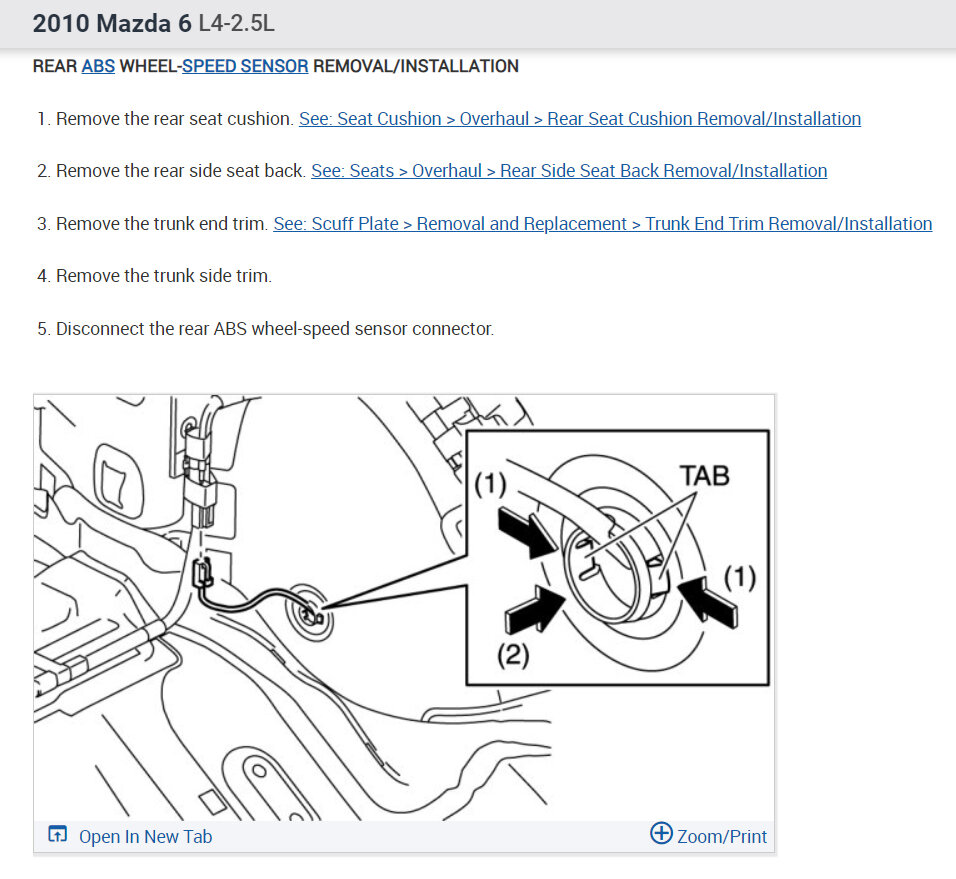

I am having an electrical issue and not sure if it's battery cable, connection, or just bad battery. I have a voltage meter and want to test the battery and sensors, etc. Also, my ABS light and traction control light are on. Any diagrams or information is greatly appreciated.

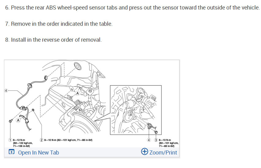

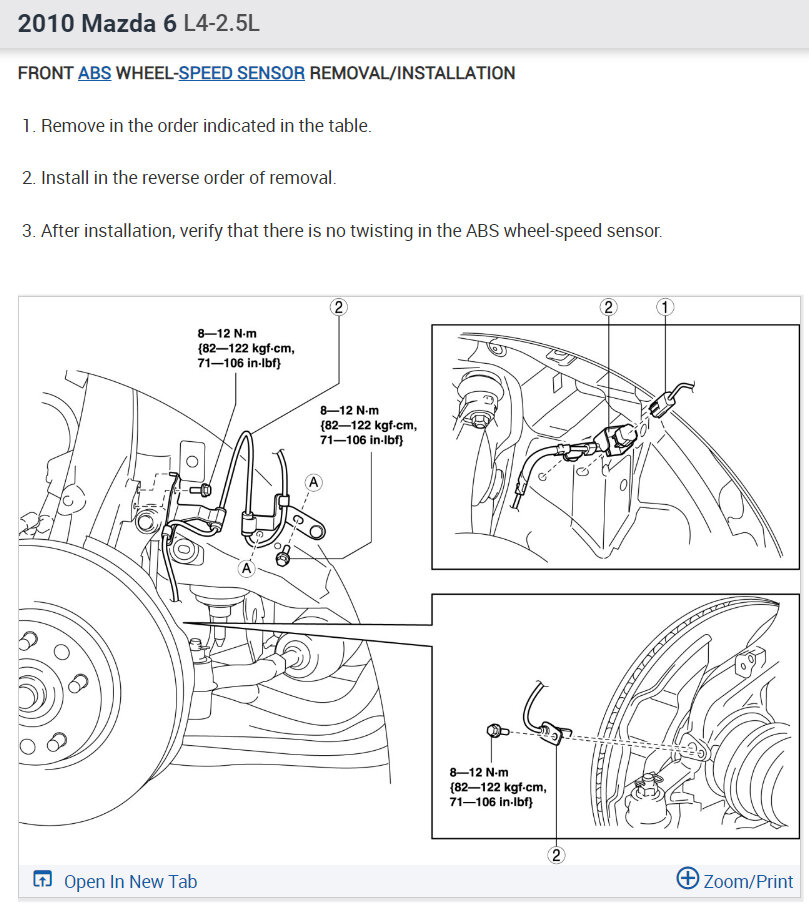

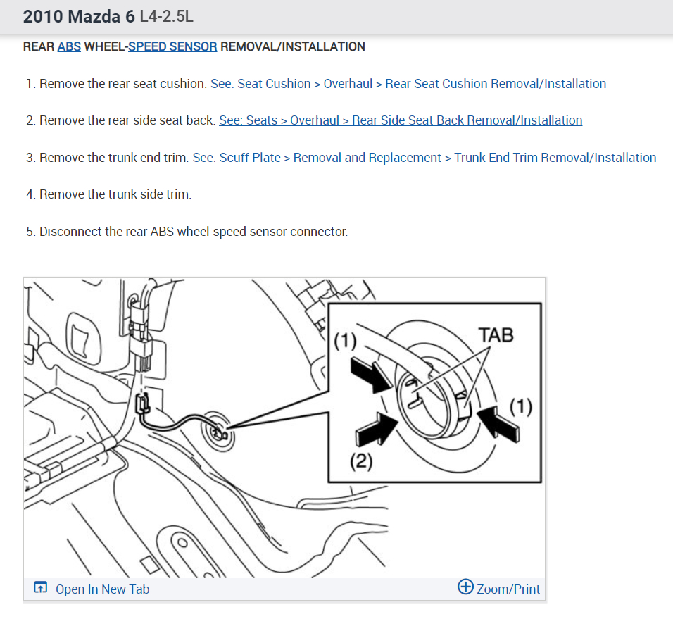

We will handle the ABS and traction control lights on this thread. Chances are the one of the front or rear ABS wheel speed sensors has gone bad or the wiring gets torn apart due to an obstruction on the road. You can do an inspection of the sensor wiring and if okay let's run the codes to see which ones are stored. That way we can fix the problem without throwing needless parts at it. Please go over this guide/video to help us and I have left the location and how to change the sensors out in the images below in case a code comes up for it.
https://www.2carpros.com/articles/anti-lock-system-testing-and-repair-abs
Check out the images (below). Let us know how it goes.
