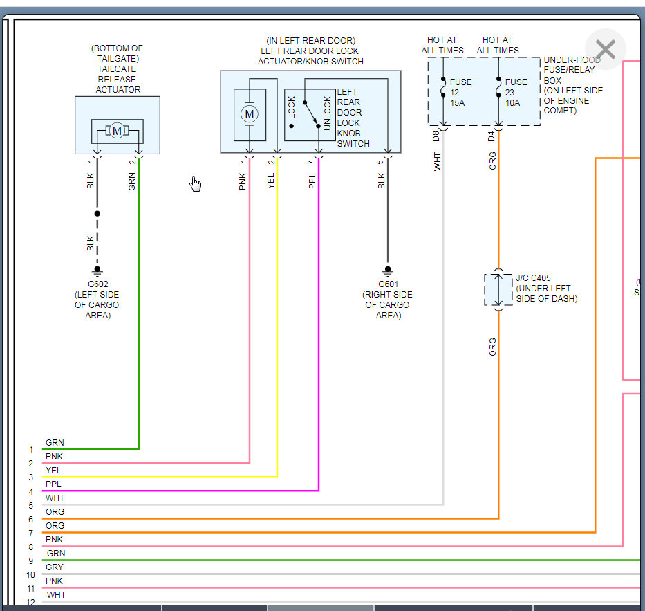

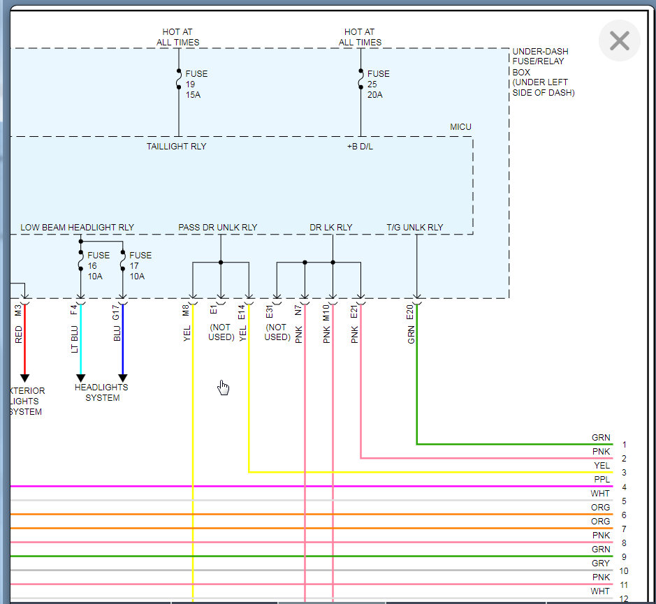

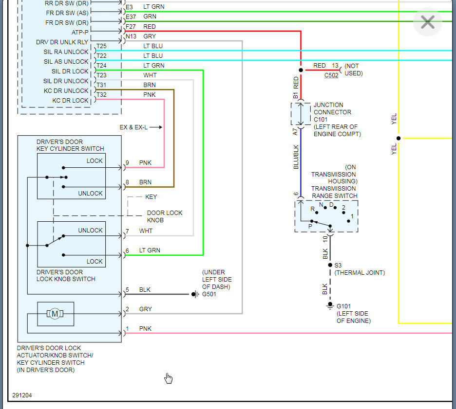

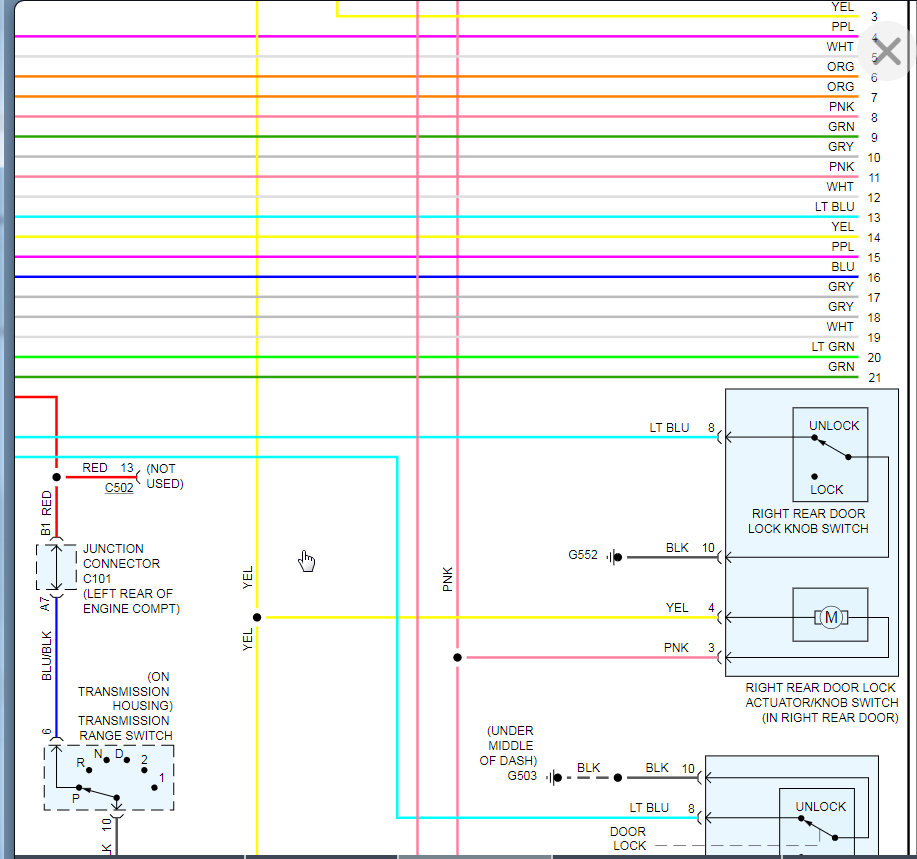

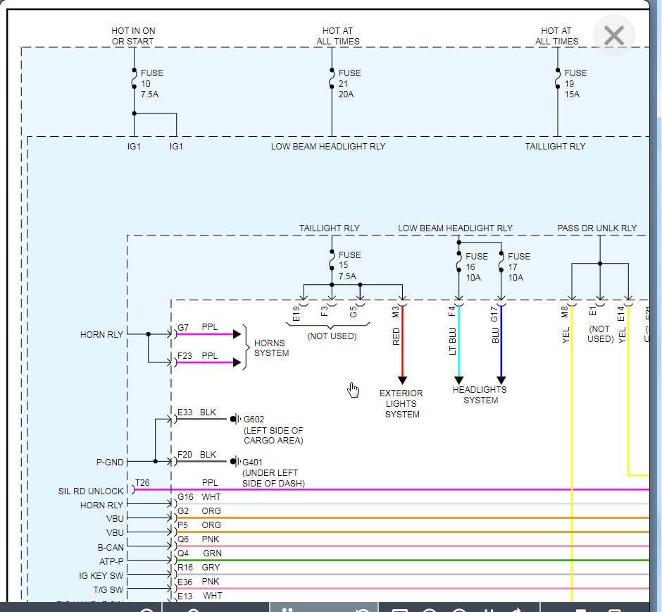

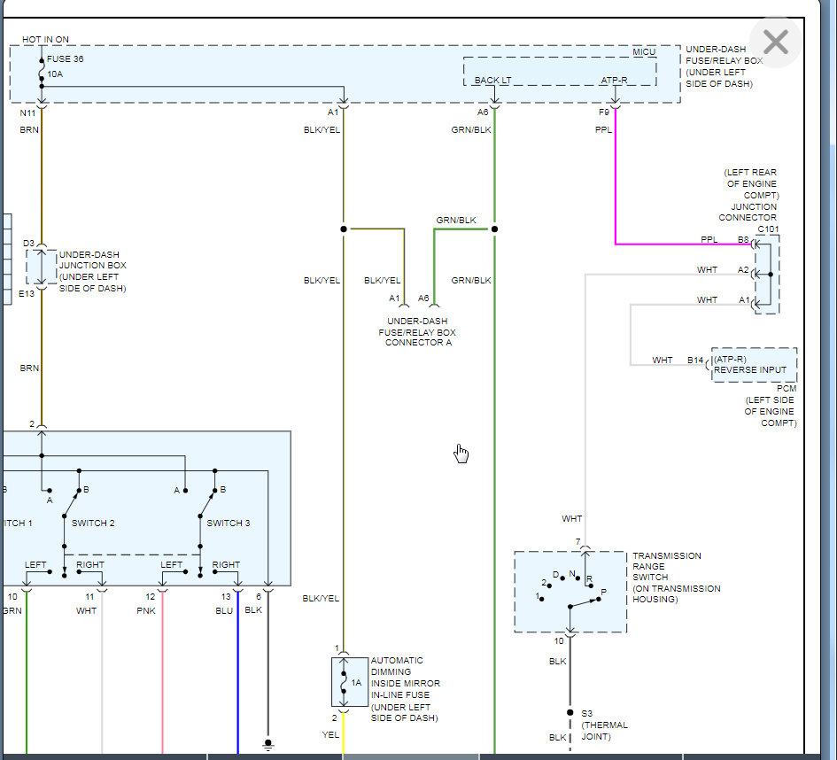

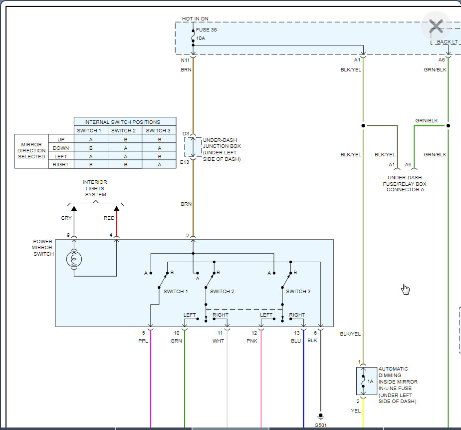

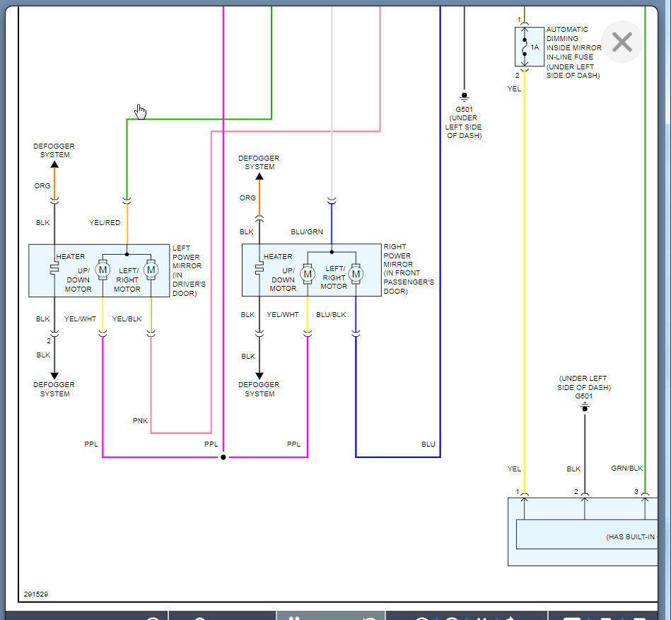

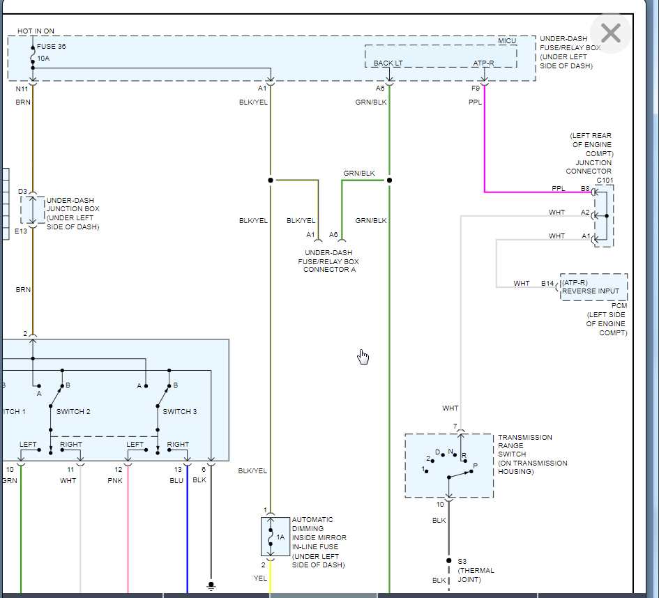

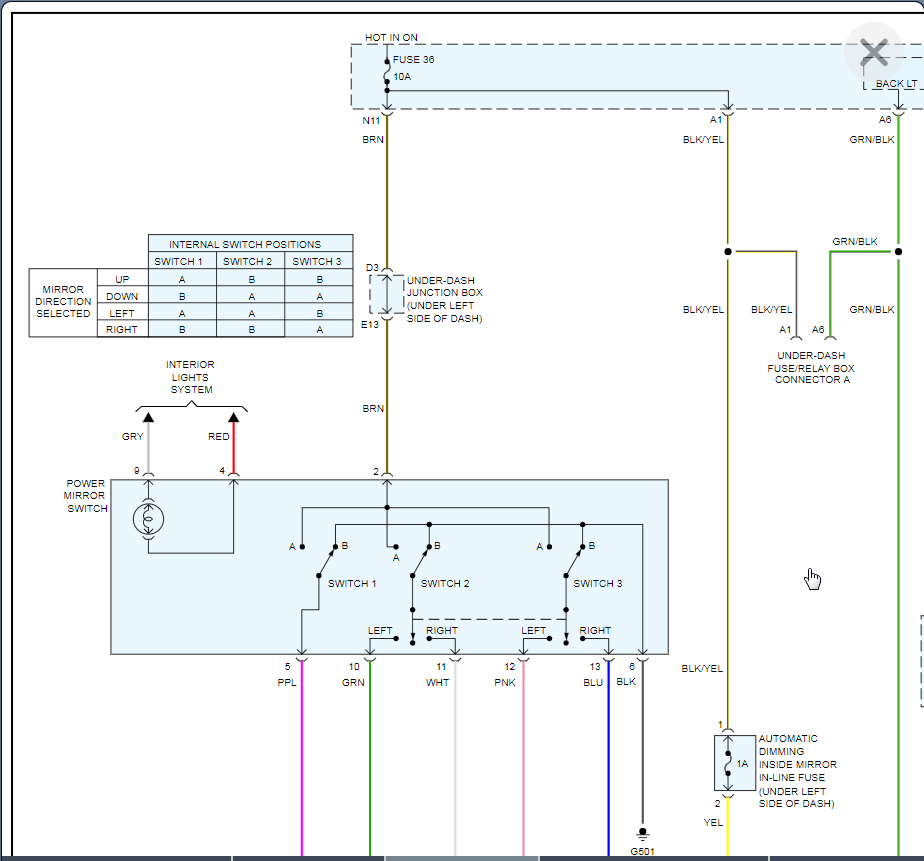

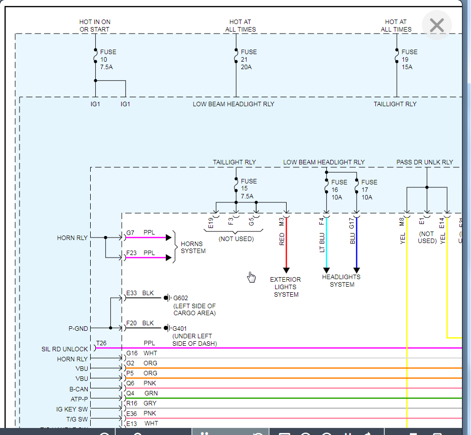

Hello everyone, I need the wiring diagram of the rear view mirrors of the vehicle listed above 140 hp re6.
thanks for the replies.
Jun 3, 2020 at 6:44 AM

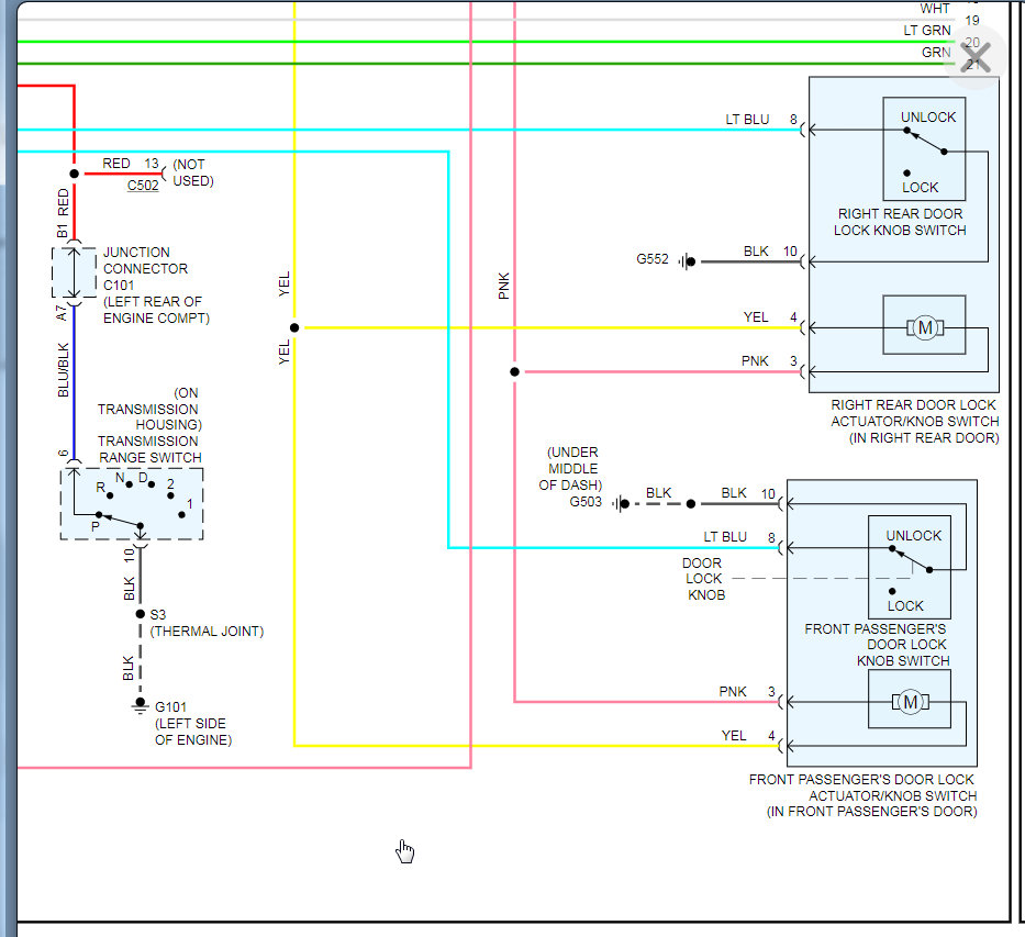

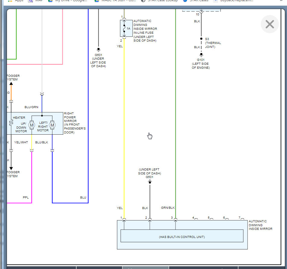

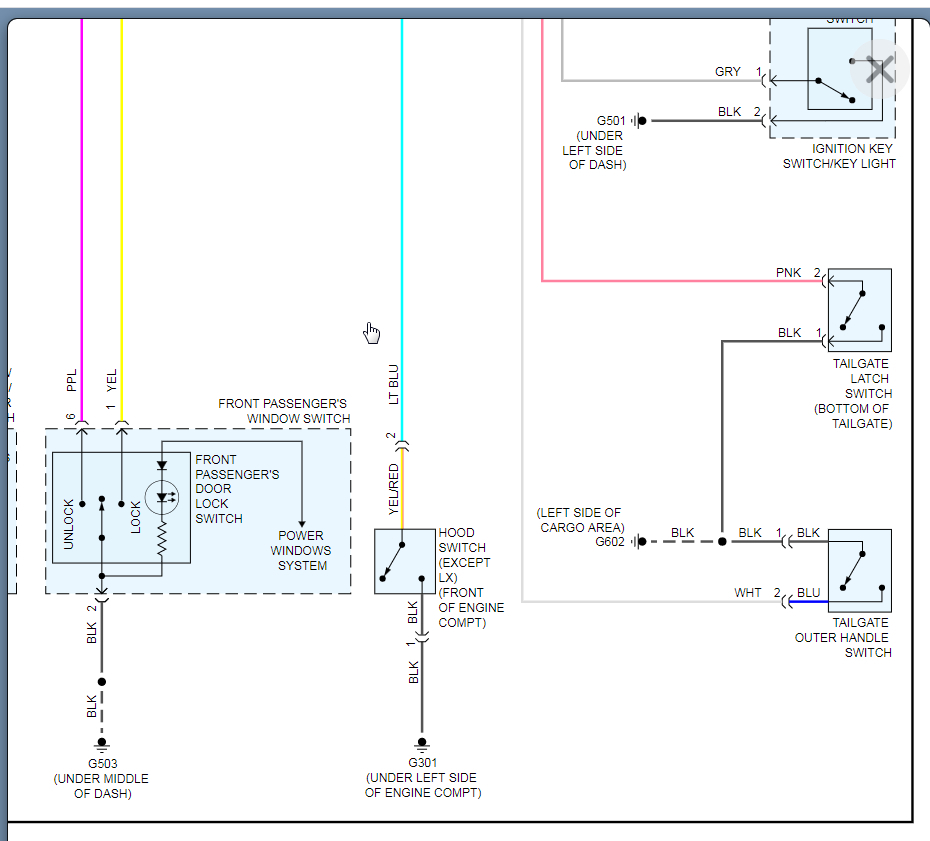

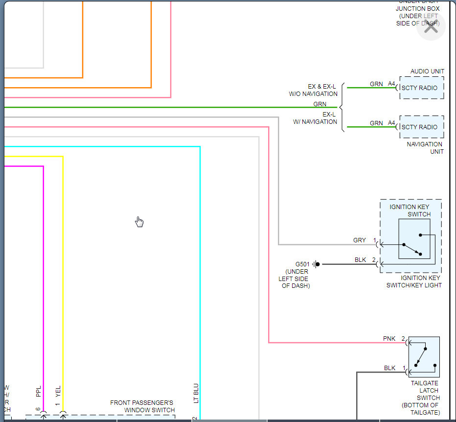

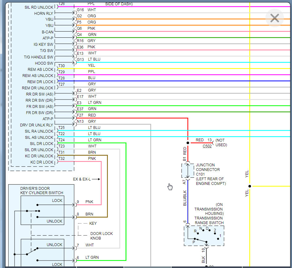

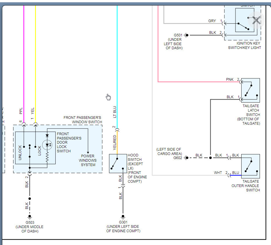

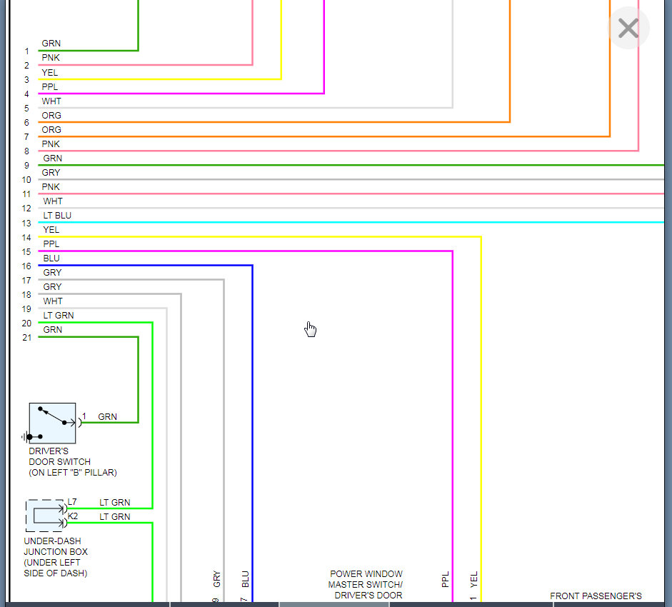

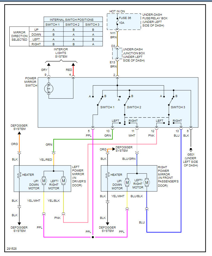

The first 4 attachments are for mirrors with auto dimming. I had to break it into sections because it was a larger diagram and it was pretty small for one screen shot.
The last is without auto dimming.
Let us know if you need more info. Thanks

I need the wiring diagram because I would like to close the external mirrors when I close the car. does anyone know how i can fix it?
Thanks for your help.
Jun 5, 2020 at 1:32 AM
Just to clarify what you are wanting to do. When you turn the vehicle off and exit then close the door, you want the mirrors on the doors to fold in?
If this is the case then this can only be done by a software program that would tell the mirrors when to fold in. This is not something that you will be able to accomplish with just changing the wiring. Basically you need the body control module to recognize that it is the correct time to fold them in and then it sends the command to fold them in.
Let me know if I am not understanding correctly and we can figure something else out or maybe come up with a way to accomplish it but I am sure it would involve a separate switch.

Hi, I hope I can explain myself. I am Italian and my English is not good. I would like the mirrors to fold in when I close the car with the key button. I hope I can do it.

I understand. If you are looking to press the lock button and have the mirrors fold in as well then again this is going to have to be programmed into the vehicle. Unfortunately there isn't a way to re-wire the vehicle in order to get this to happen. Basically the mirrors have to be "told" to fold in and just putting power to them will not do that. Even if you could wire them to the lock circuit it still would not work. Again you need to have the vehicle software changed to perform this function which may not be possible either if this function was not an option originally from the manufacturer. If this is possible, the dealer would have to go into the computer and enable the function and then update the vehicle.

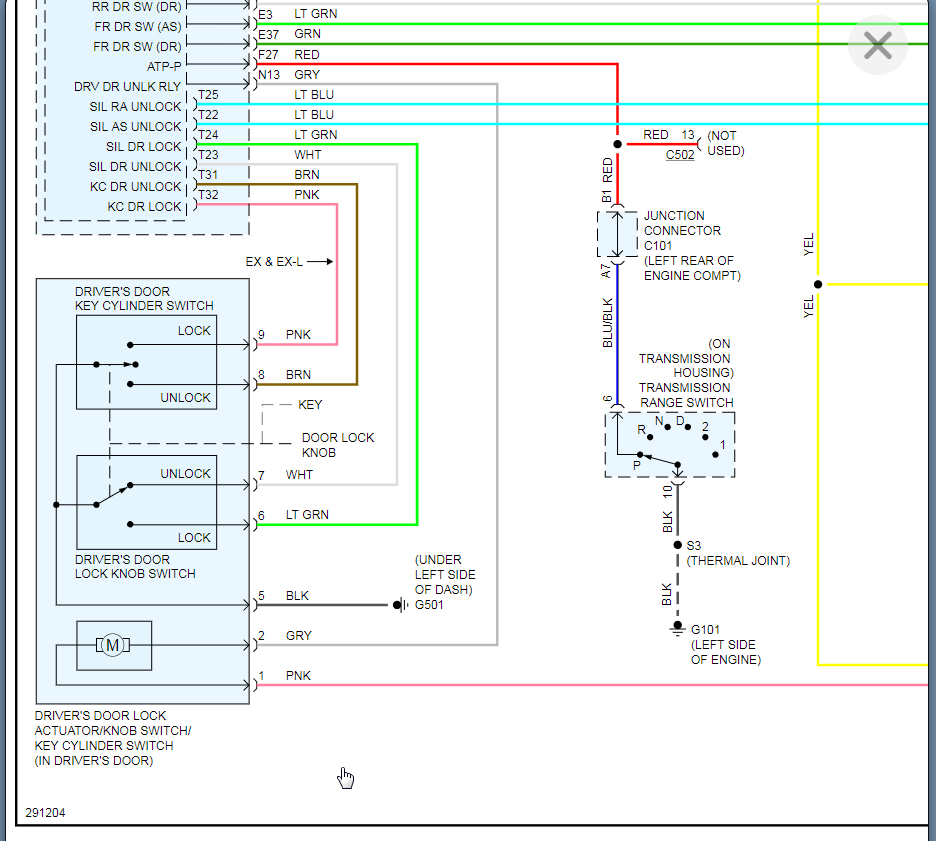

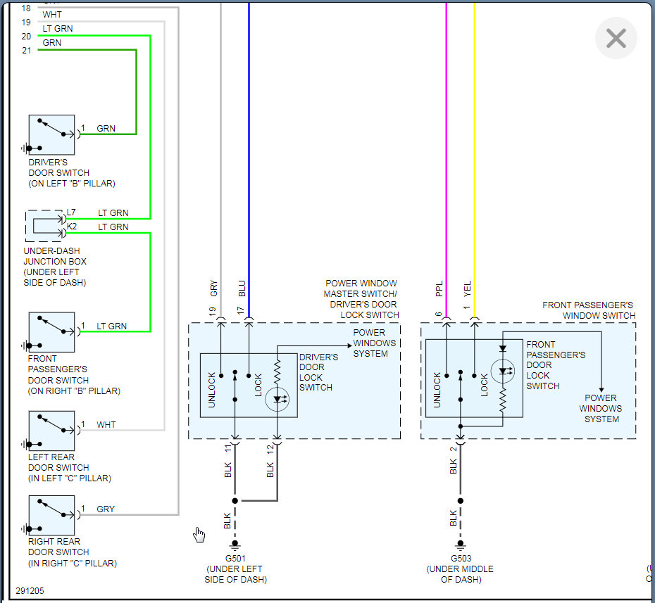

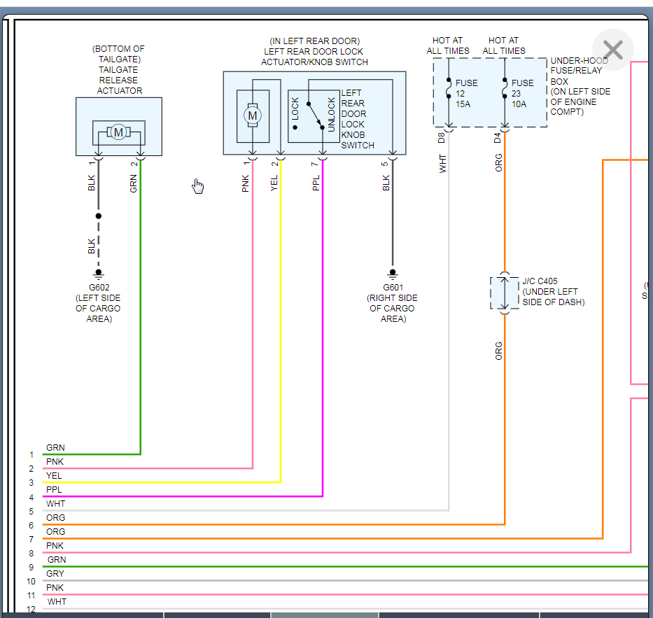

thanks for the reply, I would like to ask you one last thing, can you post me Power Door Lock wiring diagram? thank you
