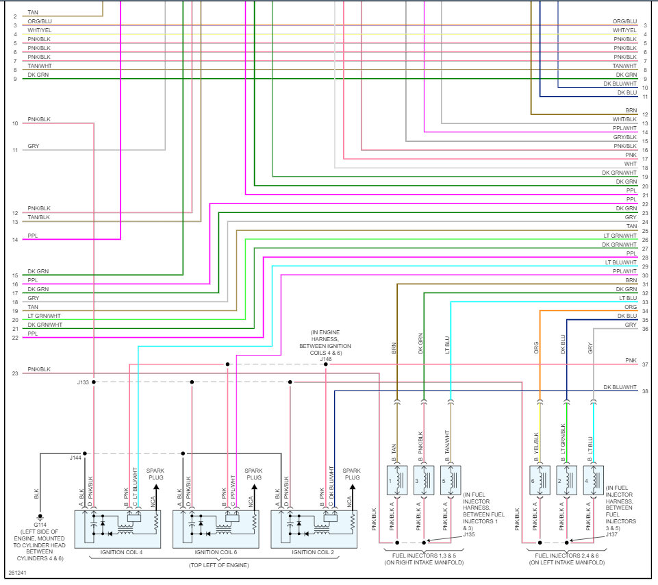

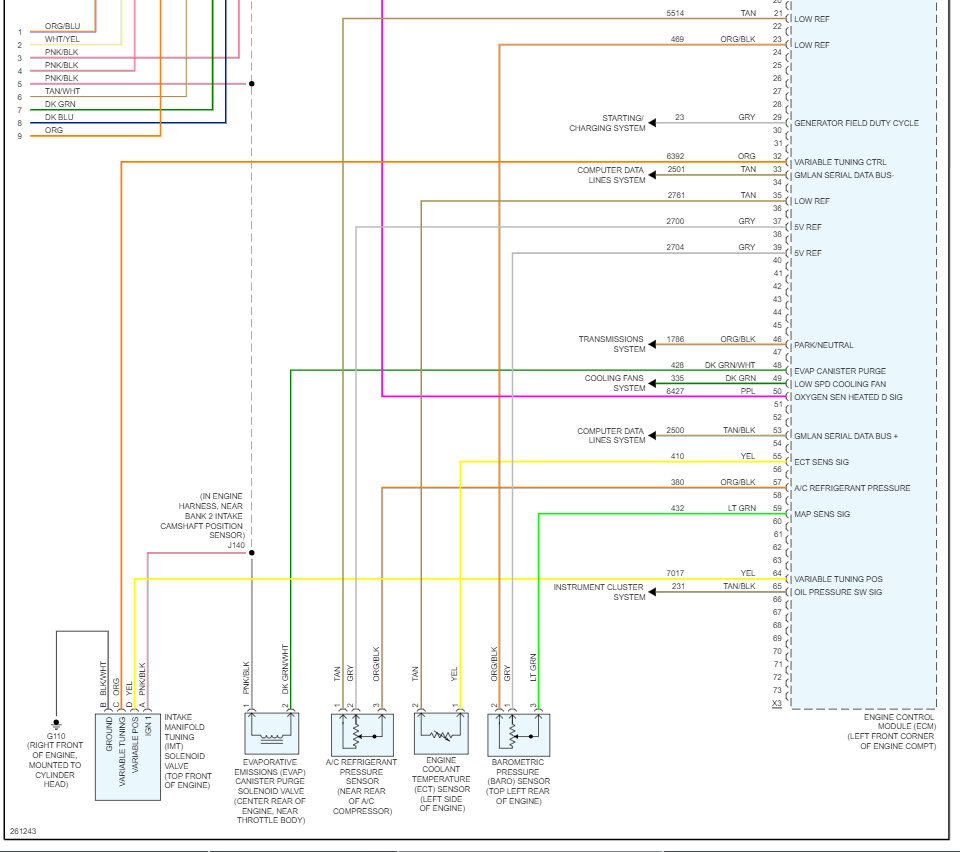

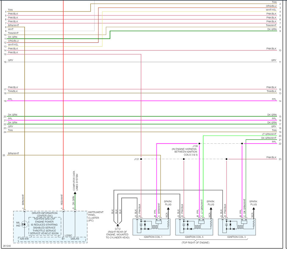

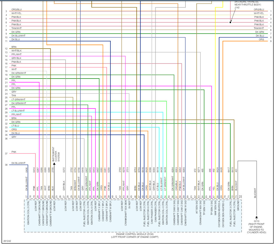

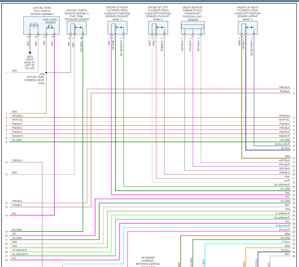

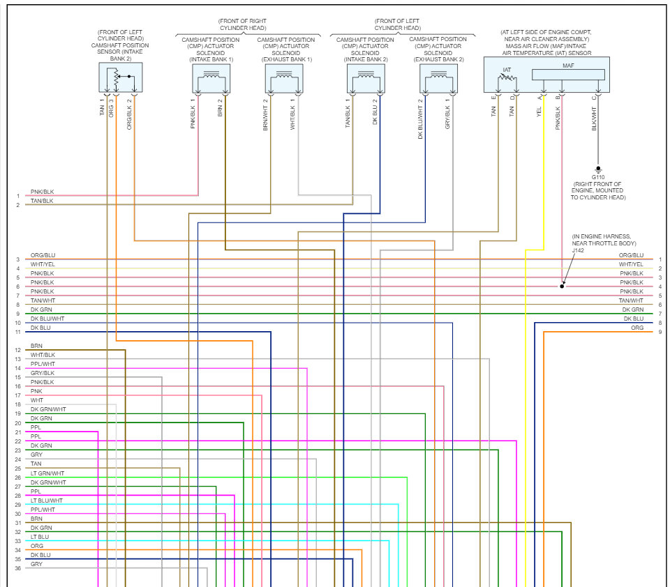

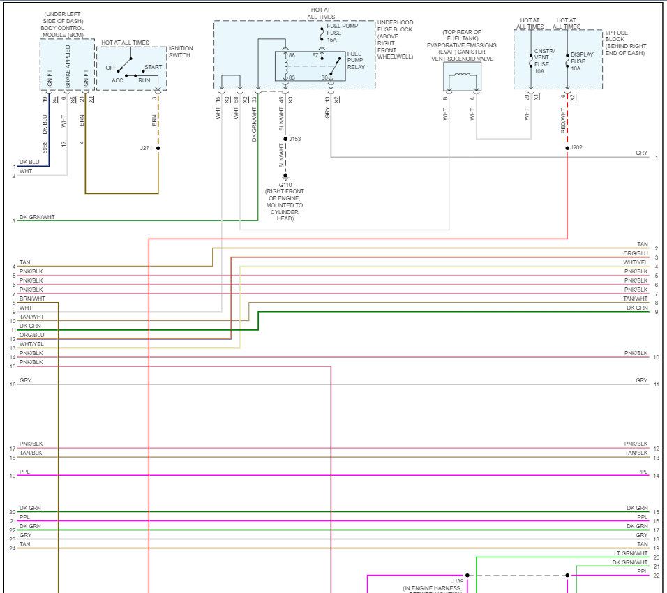

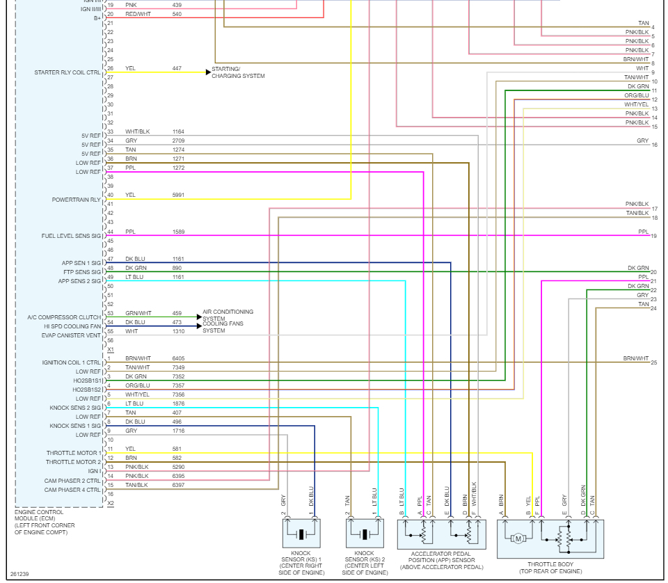

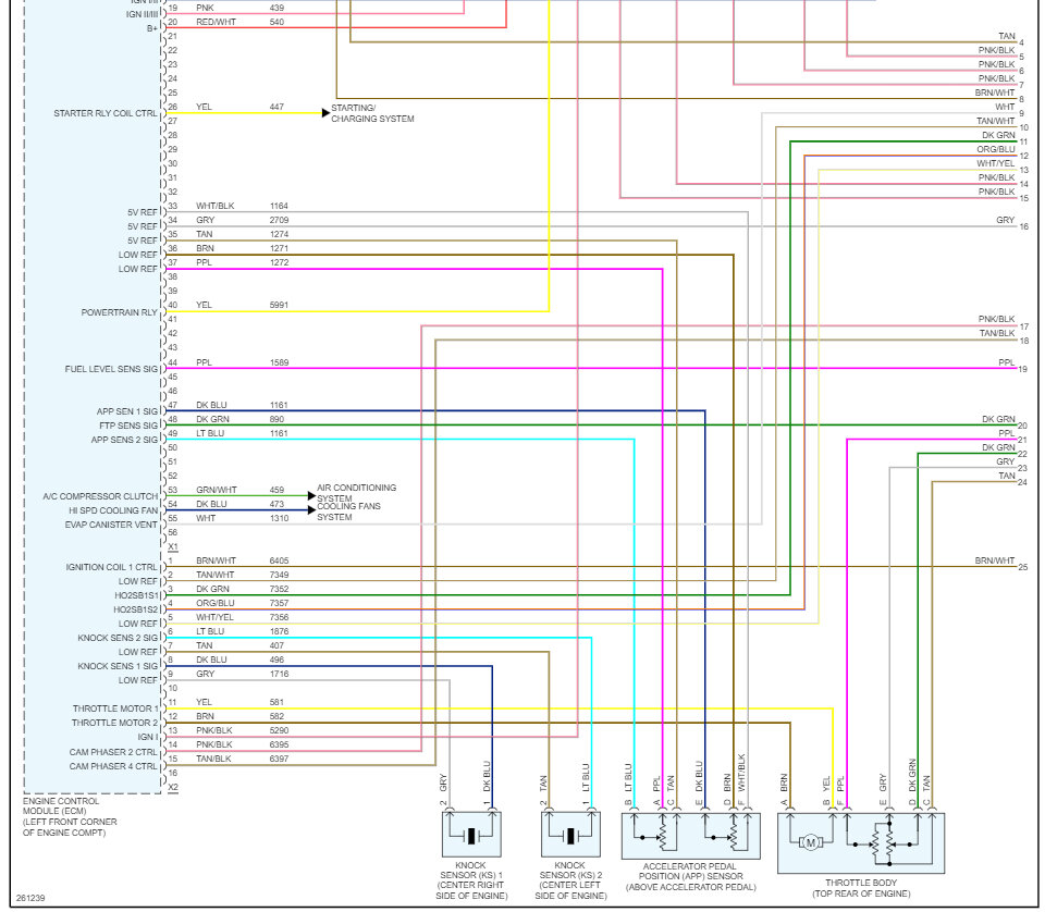

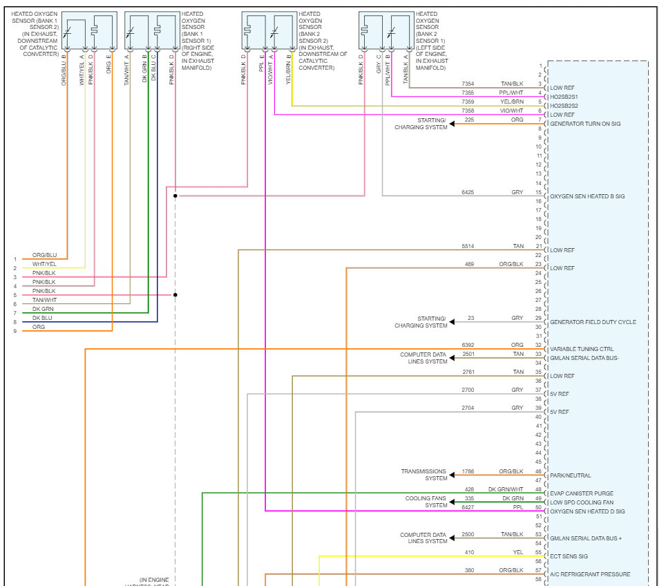

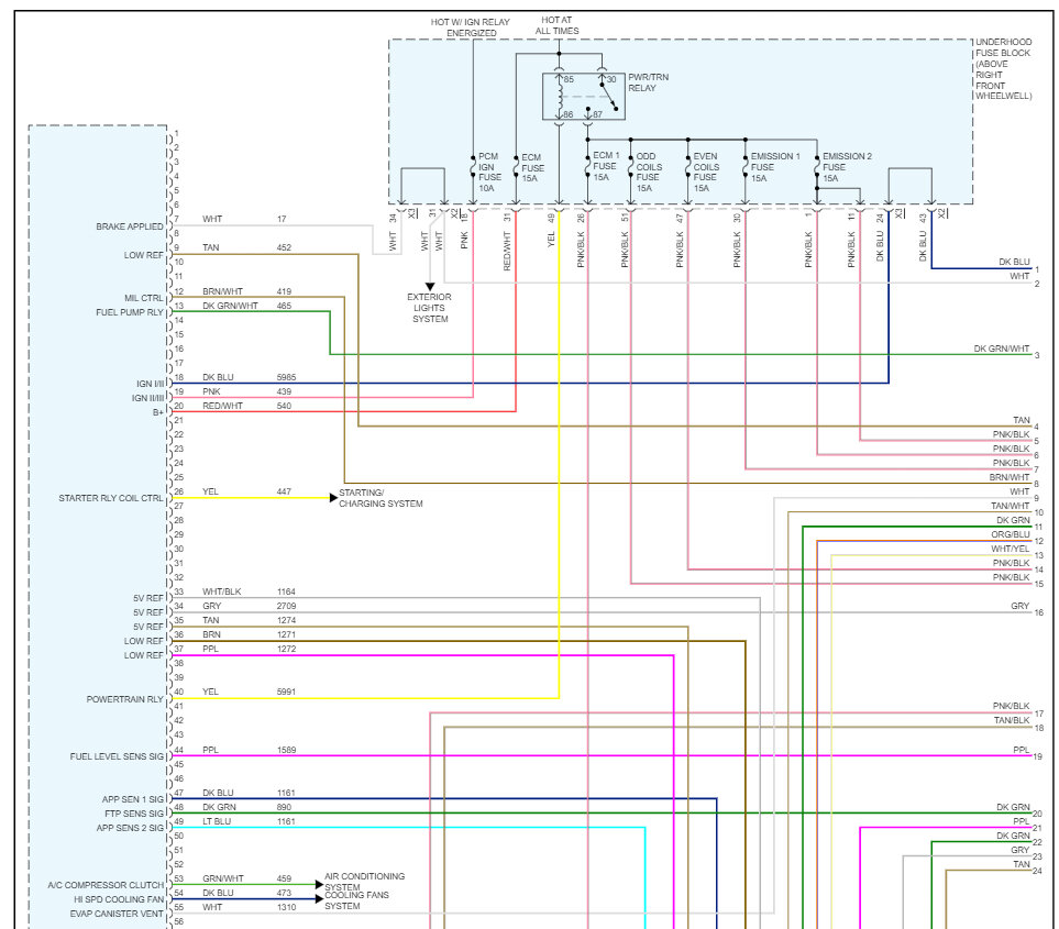

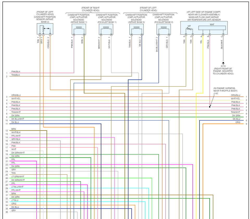

I just need a wiring diagram of the wiring harness that goes to the oxygen sensor and what color goes to what color on the sensor itself...
Jul 16, 2023 at 1:52 PM
Experienced Mechanic
55,542 POSTS
Sure, here are the engine and oxygen sensor wiring diagrams and I have included a guide to help you test the connections.
Check out the images (below). Please let us know if you need anything else to get the problem fixed.
