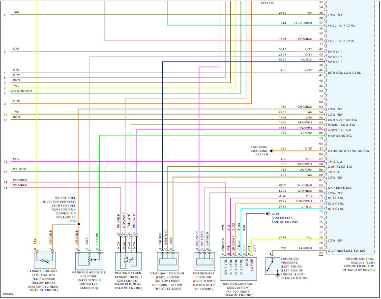

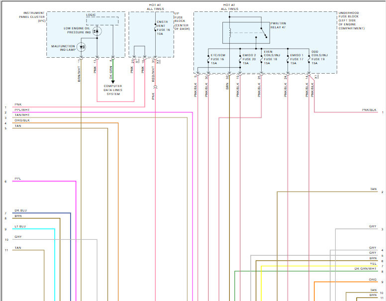

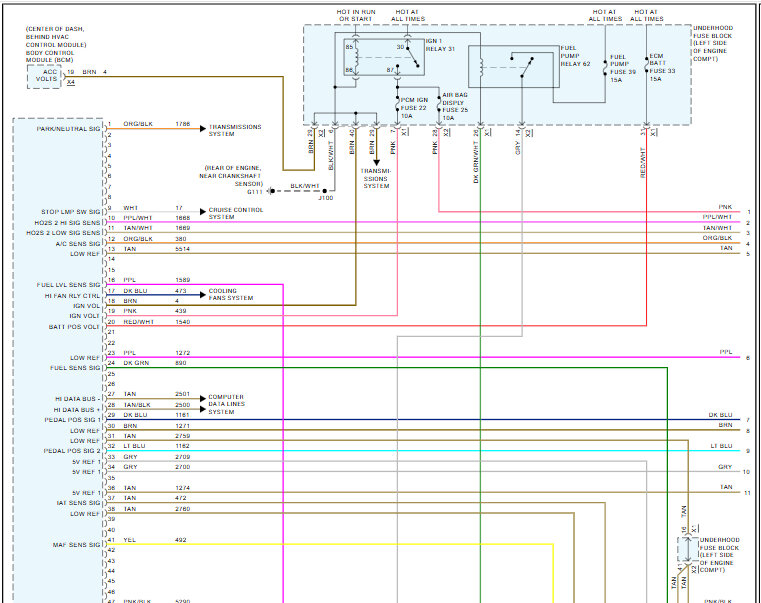

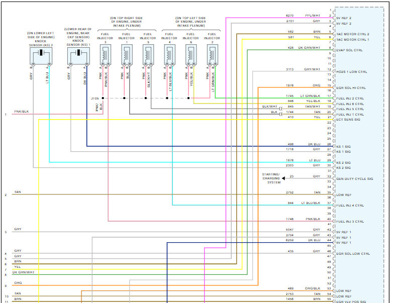

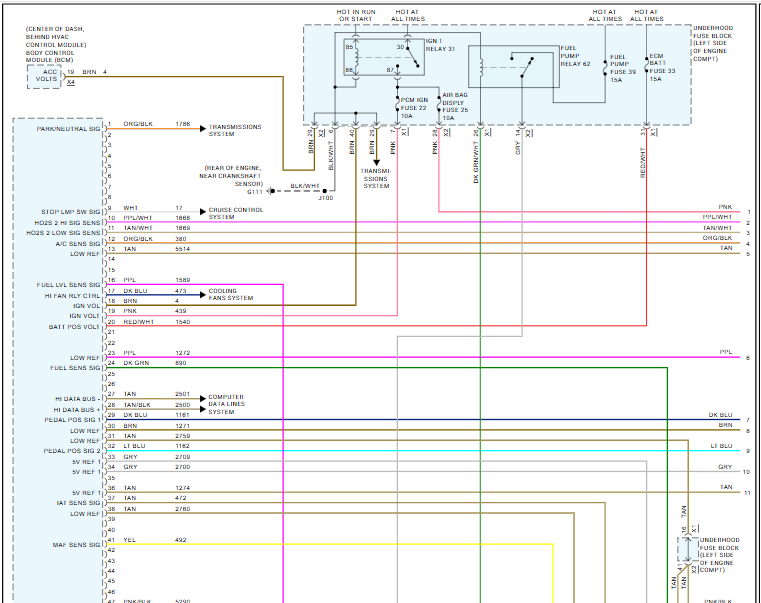

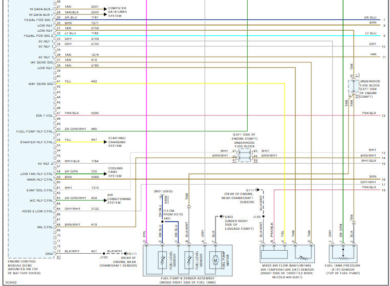

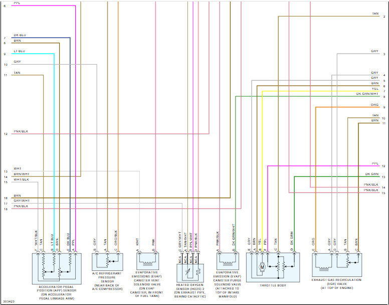

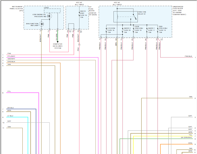

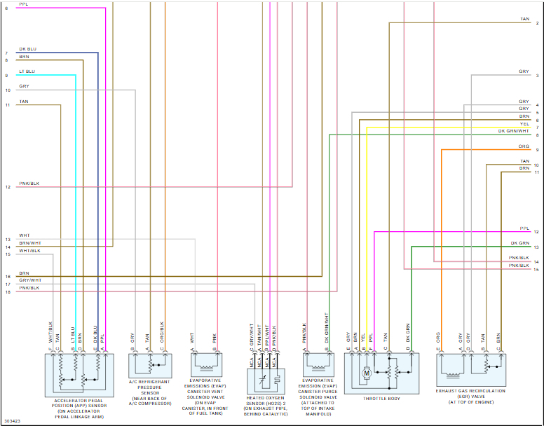

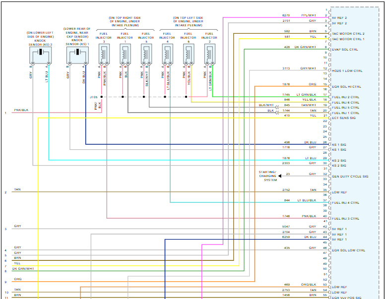

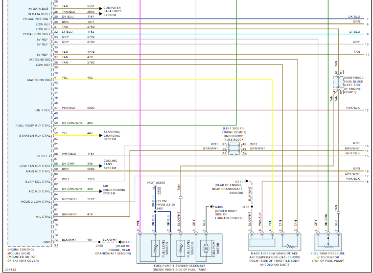

I would be happy to get one for you, but we need to narrow it down by circuit. Otherwise, I'll end up sending way too many pics and it will take forever to get every one.
Nov 21, 2024 at 10:07 AM
RONALD PATRICK RIVINIUS
  • 8 POSTS
Hmmm. Well. I guess we’d be looking at the ignition circuit perhaps, and the PCM connections too, if possible.
Thanks,
-Ron
Nov 24, 2024 at 12:51 PM
  • 110,248 POSTS
If you look below, I attached the schematics for engine control. There were three pages of schematics. I had to cut each page in half to make them readable for you. I did overlap them so you can follow from one to the next.
Take a look and let me know if they help.
