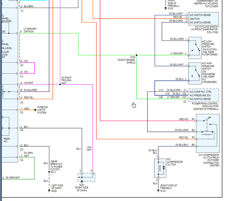

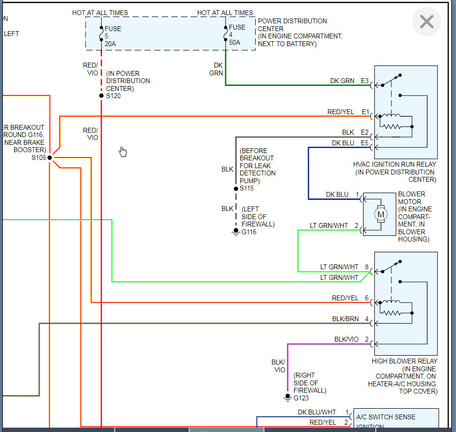

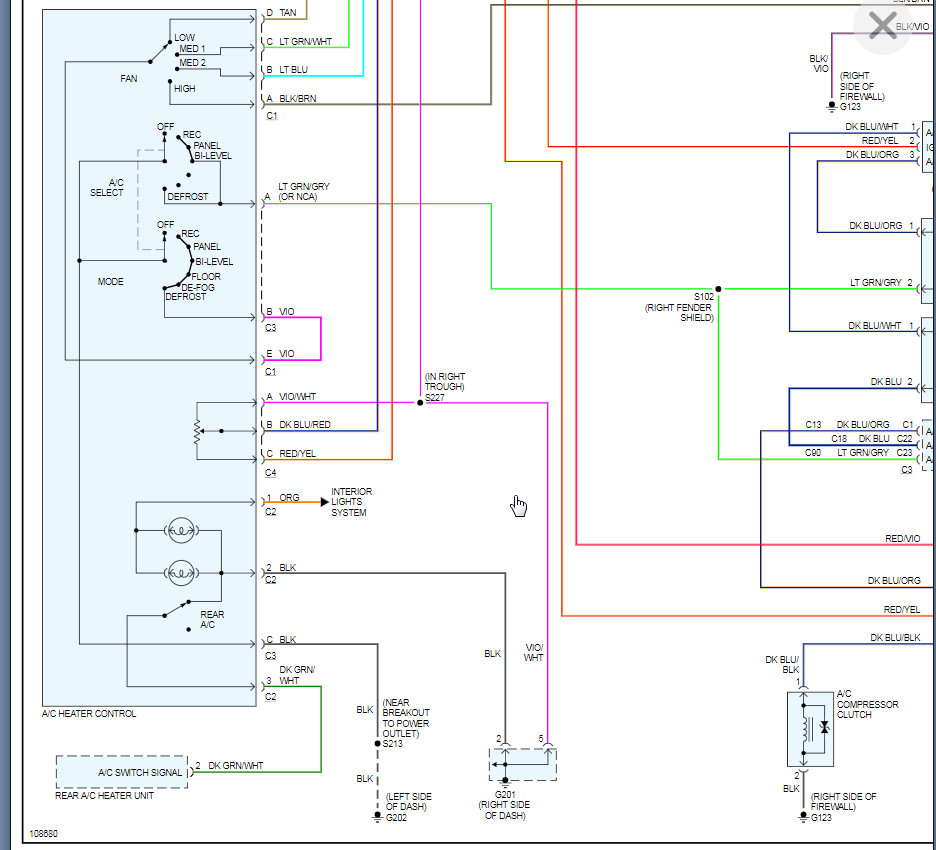

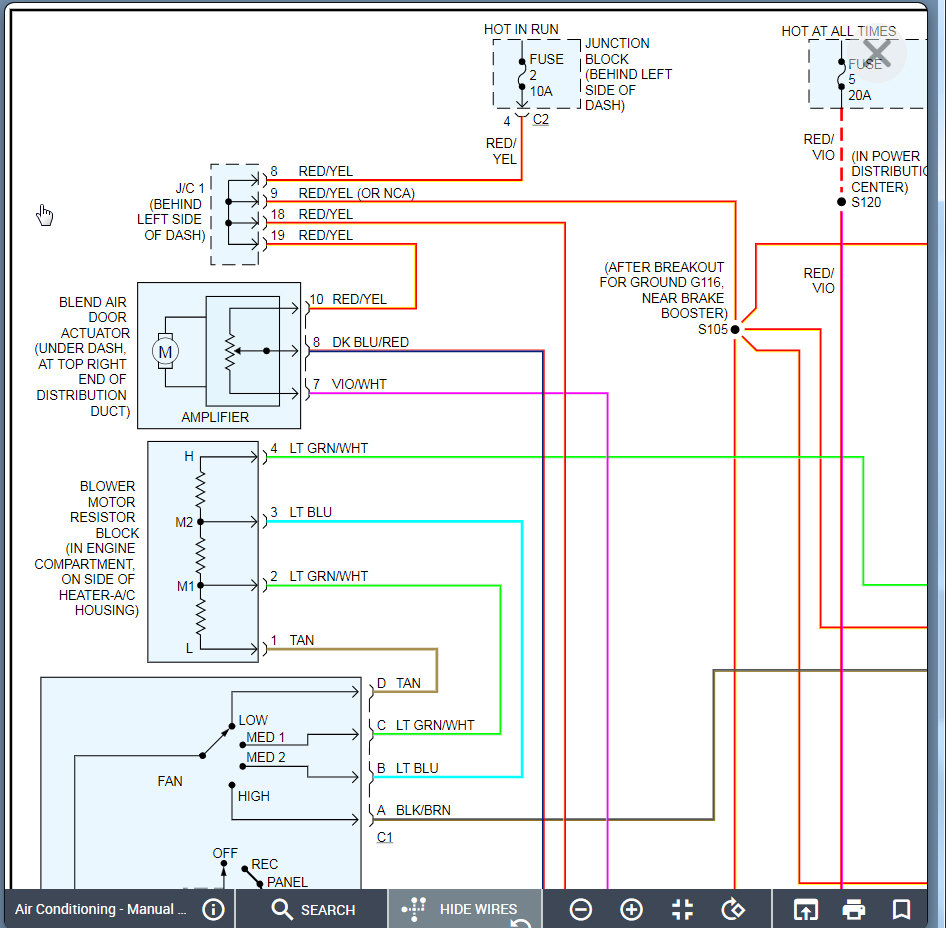

Compressor not running,has adequate refrigerant. Do you have an HVAC wiring diagram?
May 13, 2020 at 2:15 PM
  • CAR REPAIR CONTRIBUTOR
I attached the wiring diagram for this vehicle. Check out the diagrams (Below). Please let us know if you need anything else to get the problem fixed. Let us know if you need more info. Thanks
