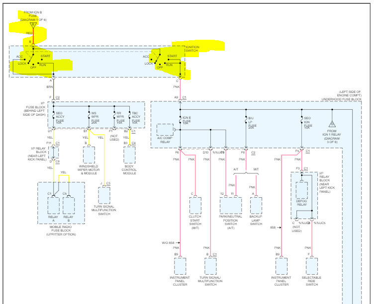

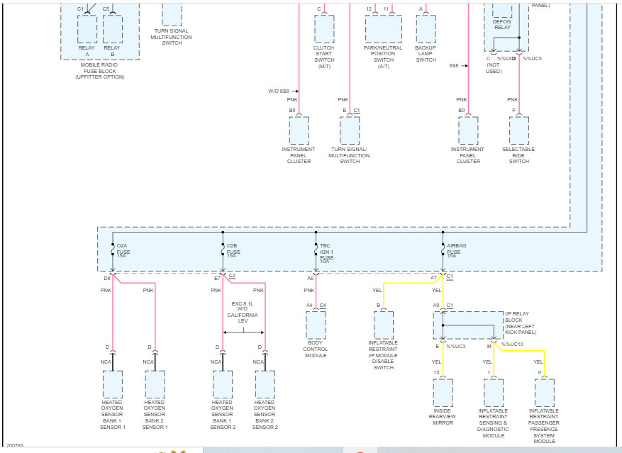

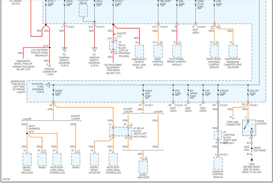

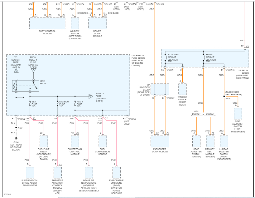

I'm having a really hard time finding the correct diagram for the ignition switch system. I’m trying to install a push start into the vehicle listed above, if anyone has the correct information retaining the diagram and correct wires to use that would be nice. Google hasn’t been any help.
Dec 10, 2022 at 6:23 AM
  • 110,244 POSTS

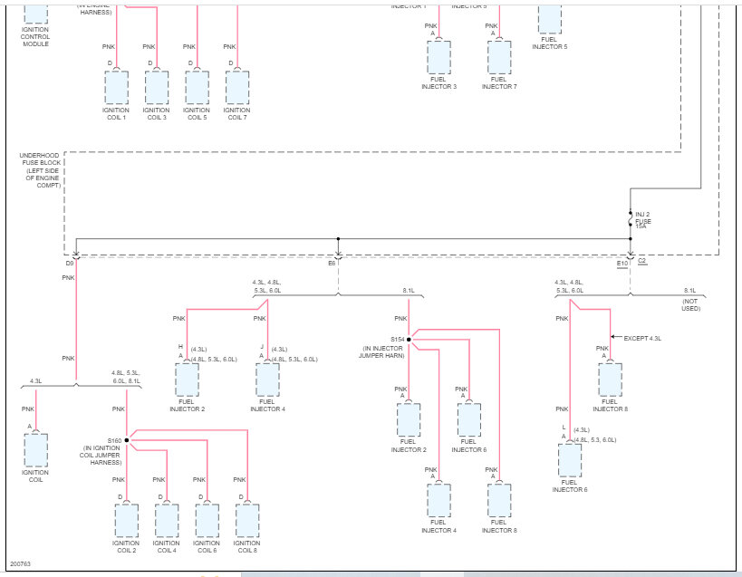

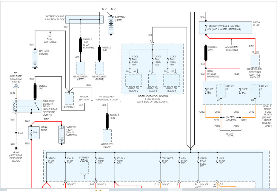

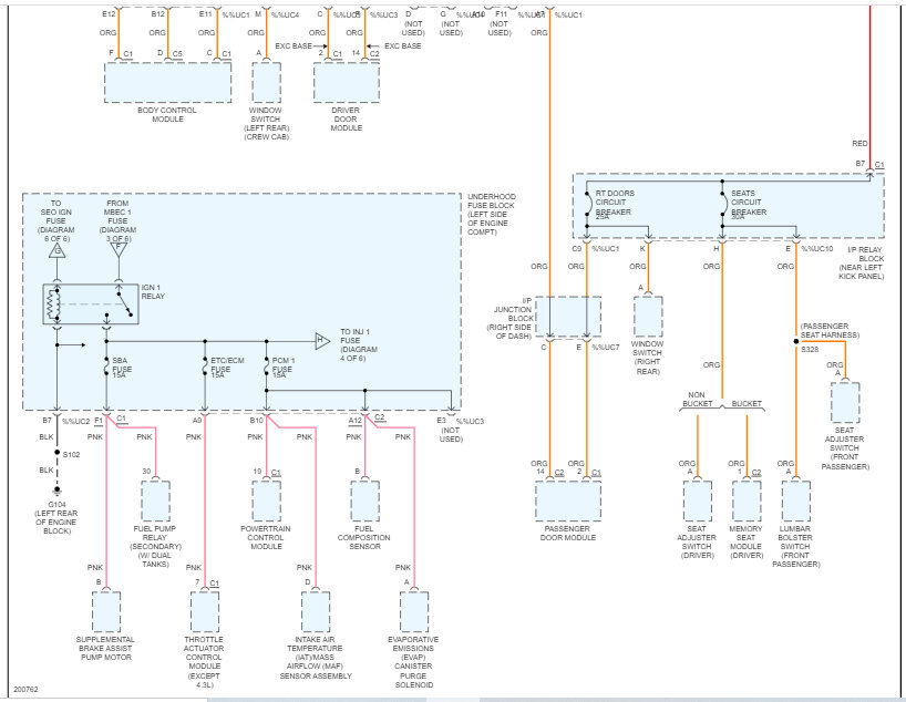

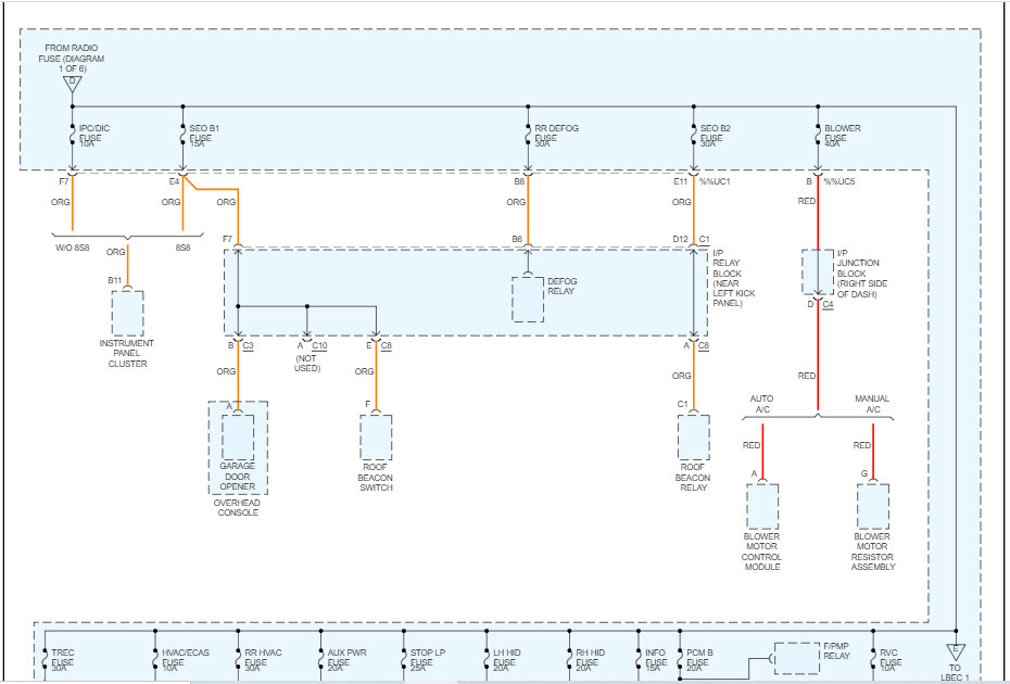

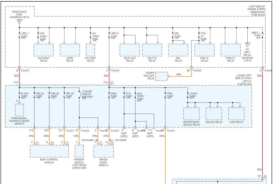

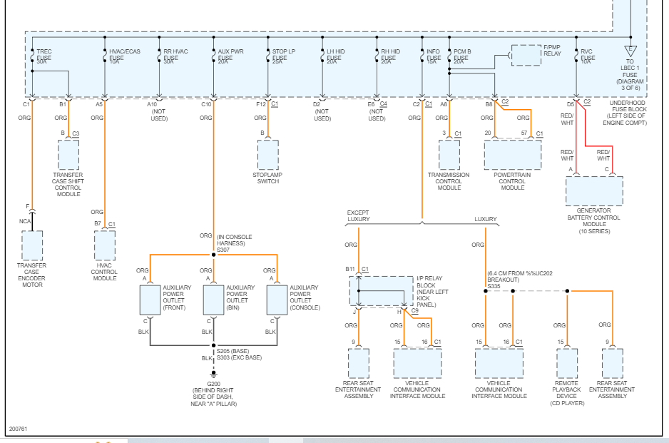

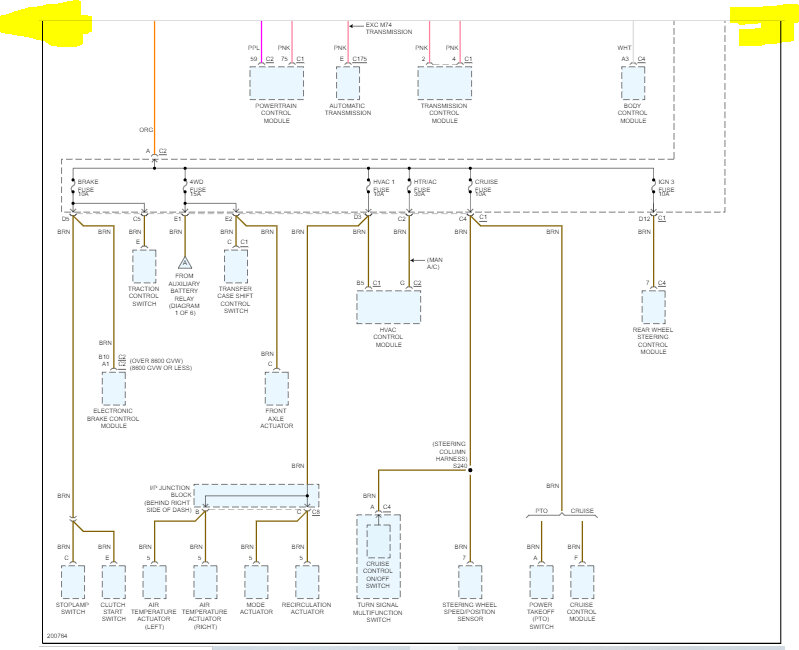

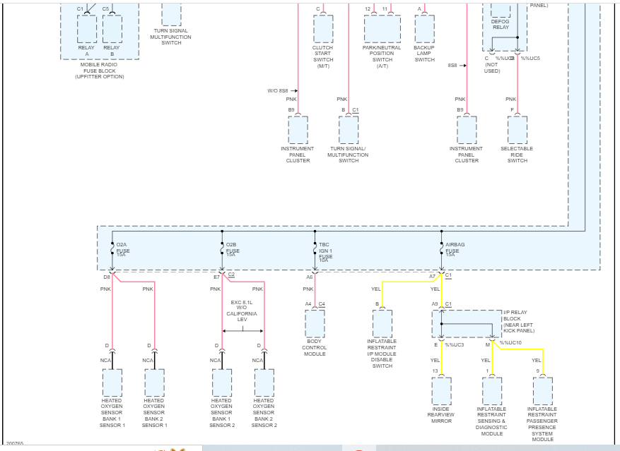

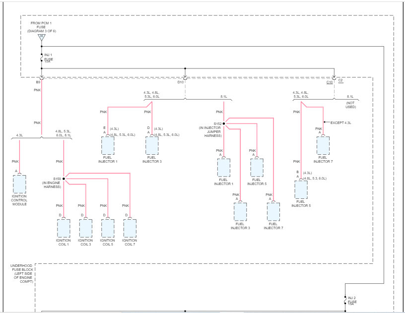

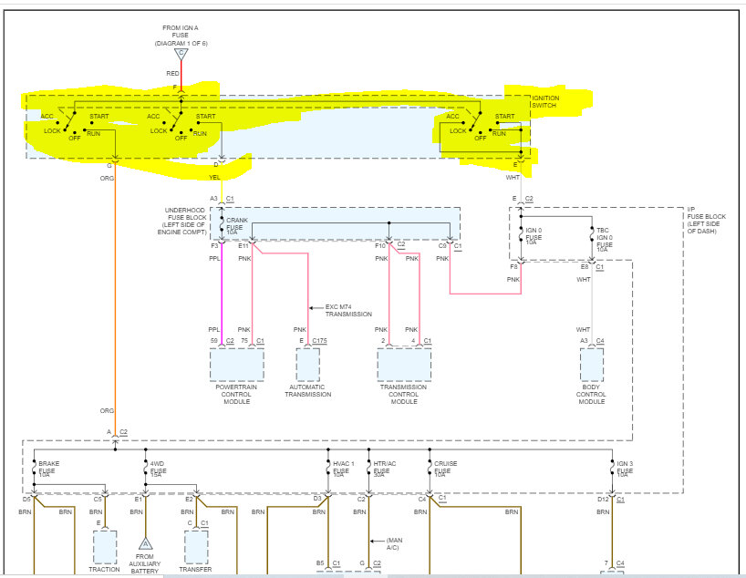

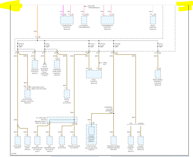

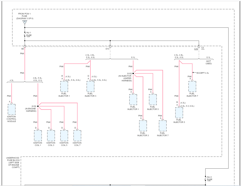

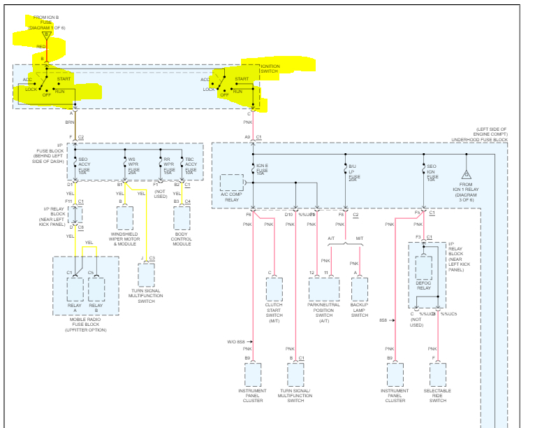

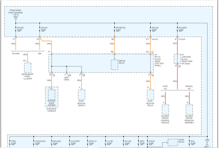

I'm not sure exactly what you need, so I attached the entire power distribution schematic below for your review.
Note there are highlighted areas on some of the pics. The highlights indicate pics that include the ignition switch.
Just FYI, is there a reason this is being done? The only reason I ask is that I see many try to make the vehicle a keyless ignition and it turns into a nightmare with the immobilizer. It's just a thought.
Regardless, let me know if this helps or if you have other questions.
joe
See pics below. Note: I had to cut each page in two so you could read them. I did overlap them so you can follow from one to the next.
