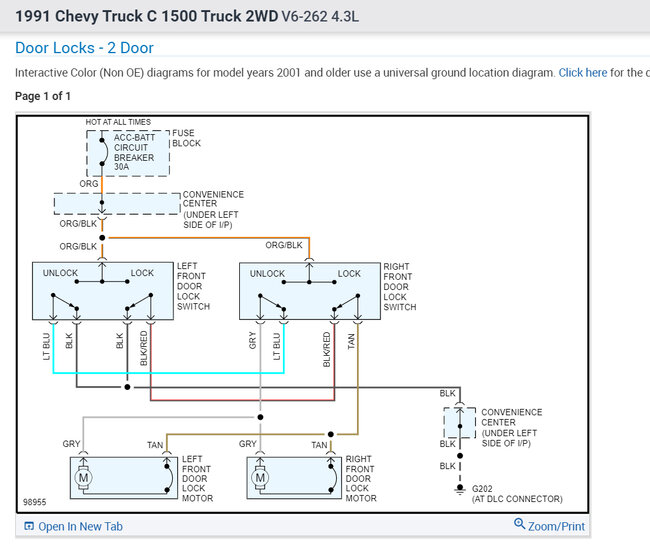

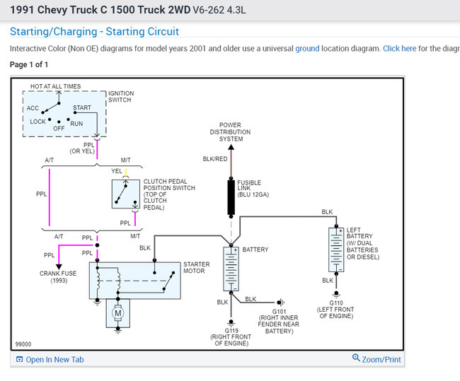

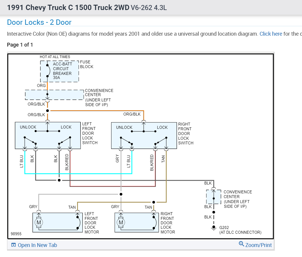

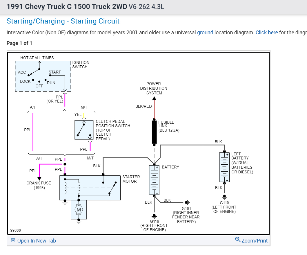

I need a wiring color code diagram for the truck listed above.

For what system? Here is a guide to help you check the wiring and I have included the door lock and starter wiring diagram as well:
