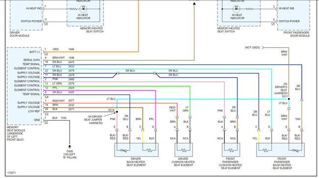

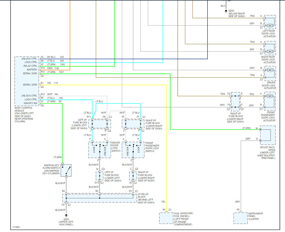

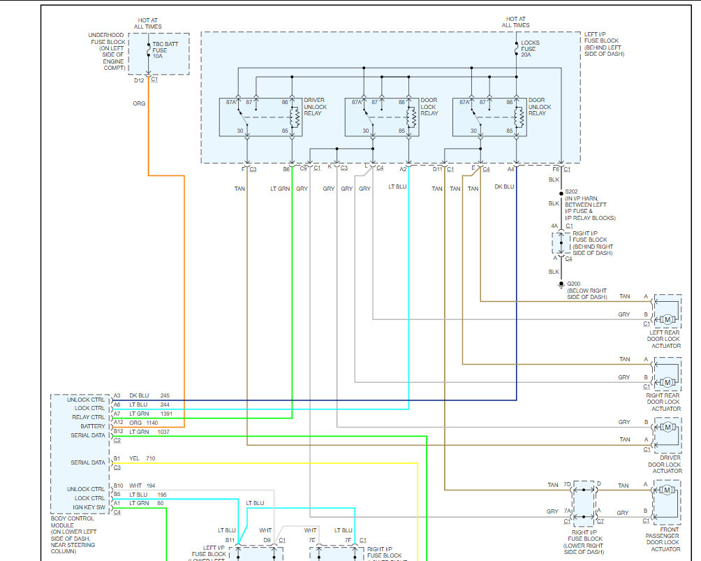

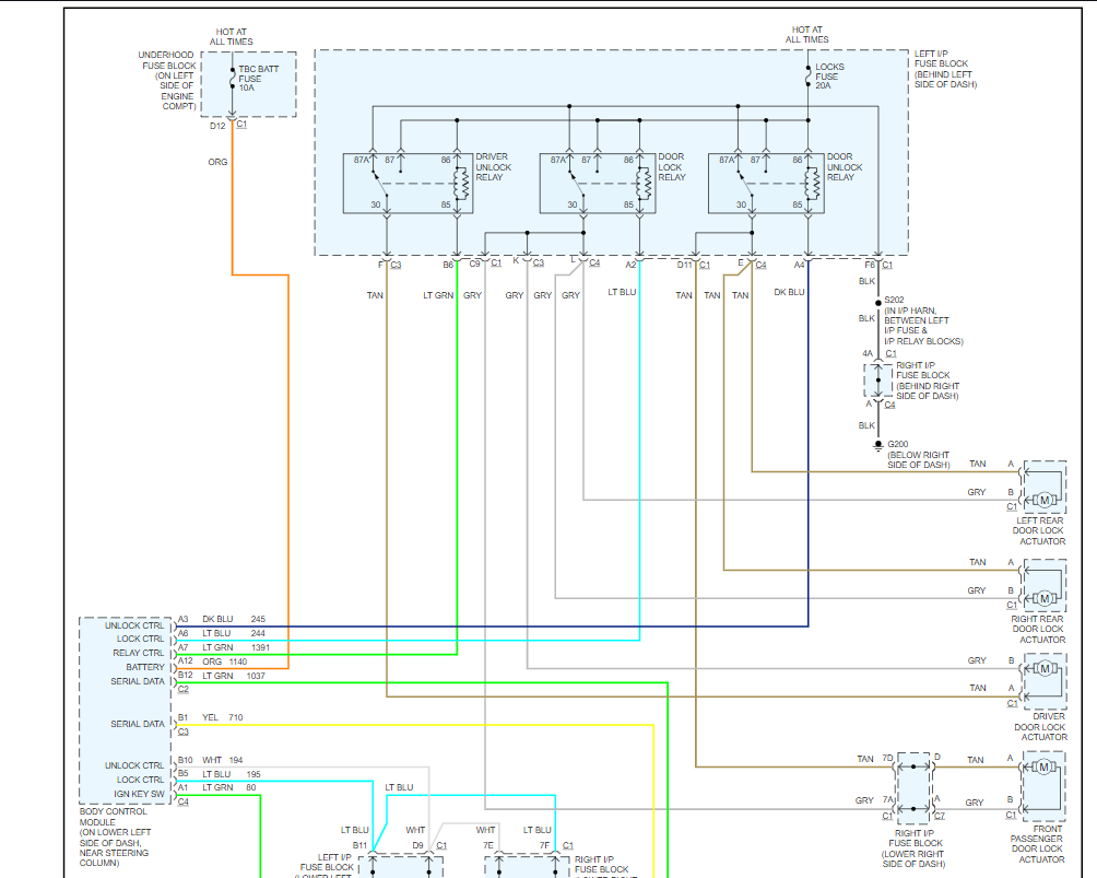

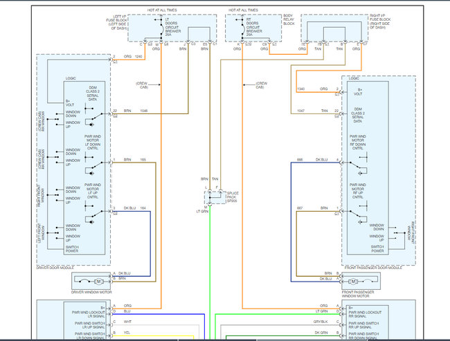

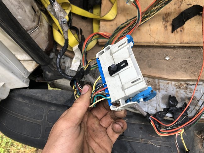

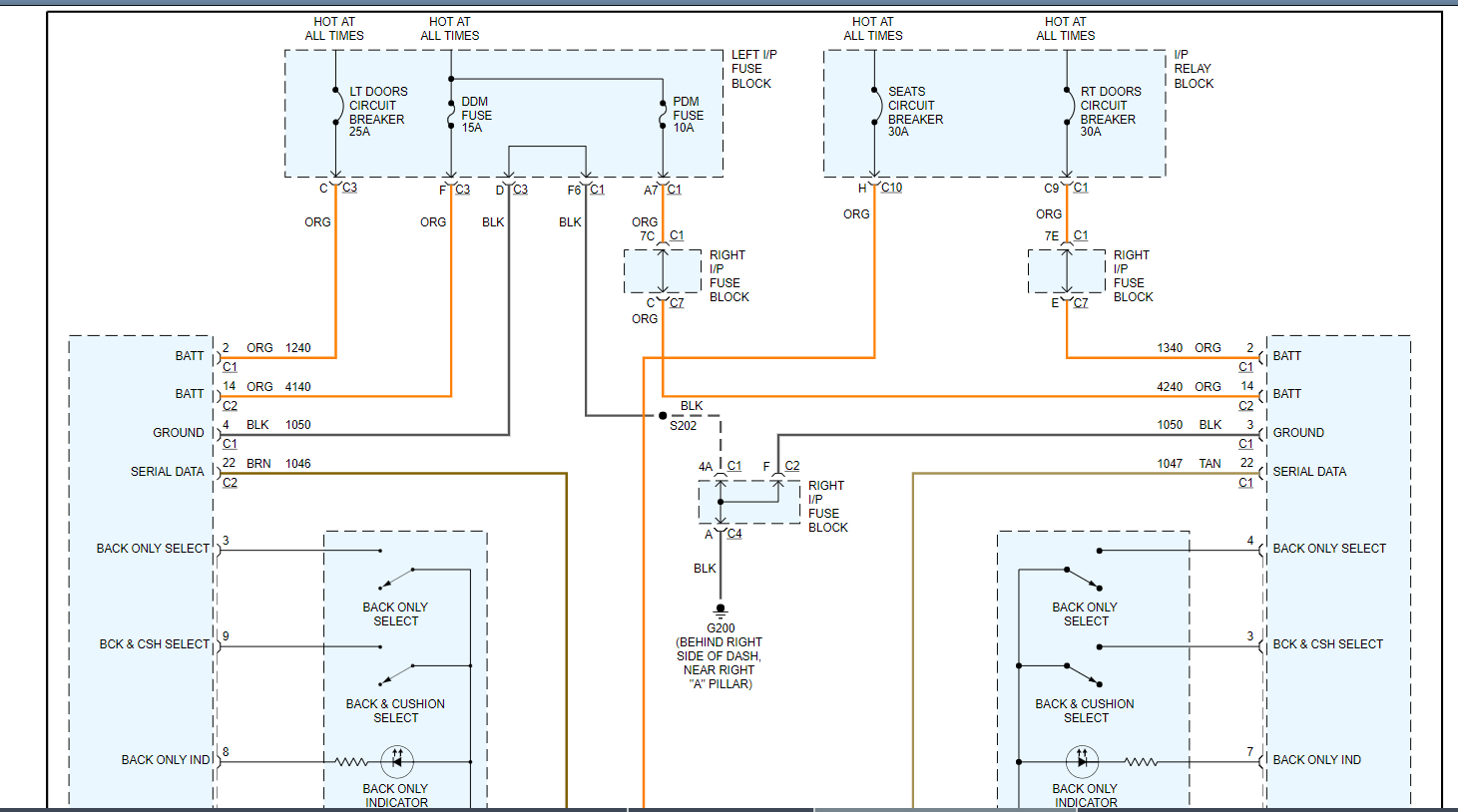

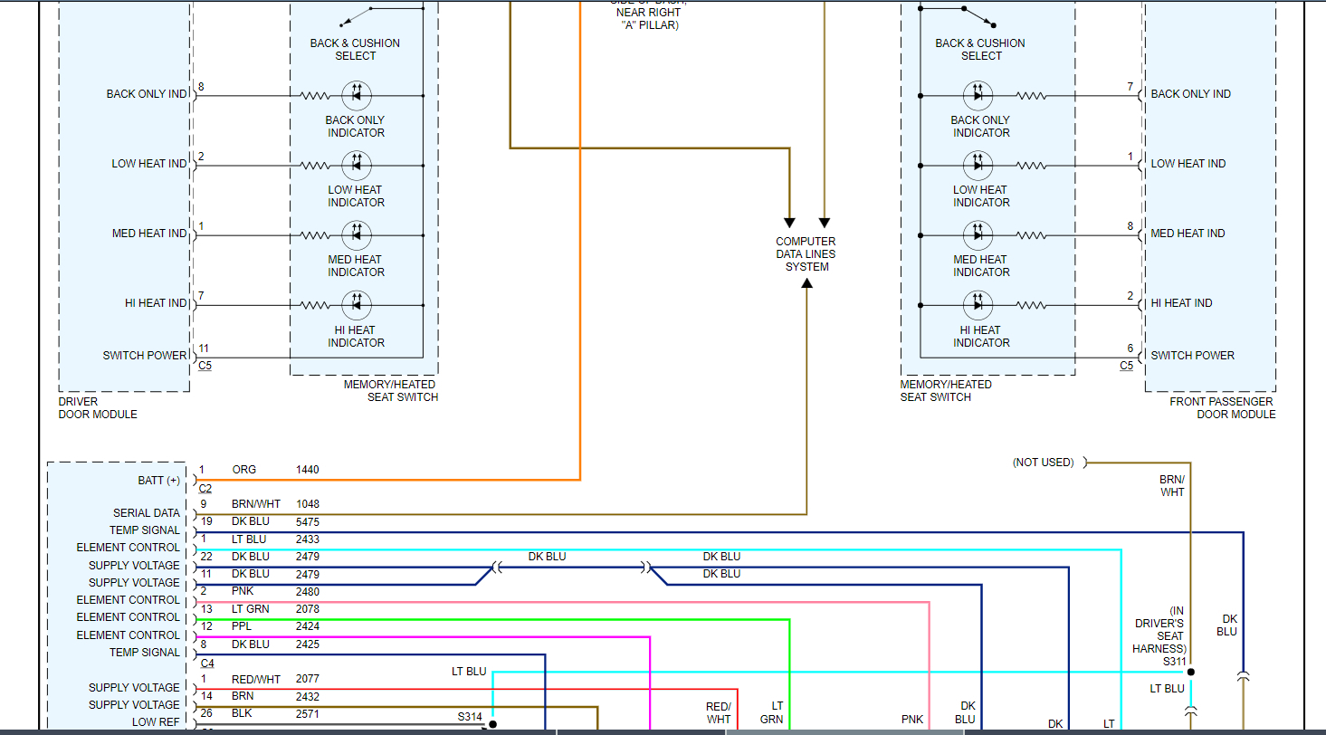

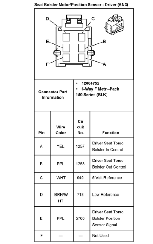

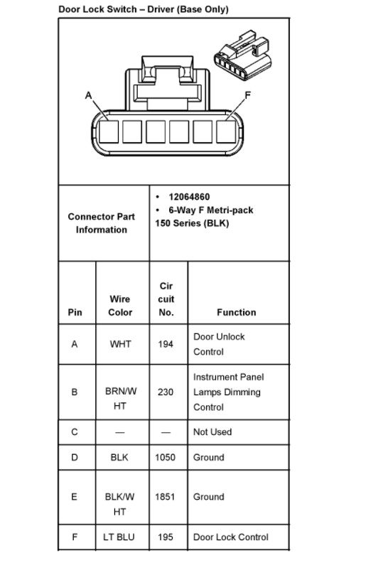

hello, I would like to have the wiring diagram of the seats power heated and the power windows and power door lock. Also tell me what the white connector of the photo below is for and wiring diagram of this connector and the pin out.
Aug 29, 2021 at 1:23 AM

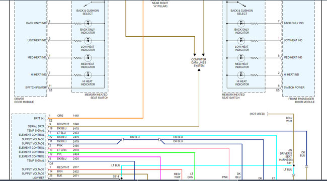

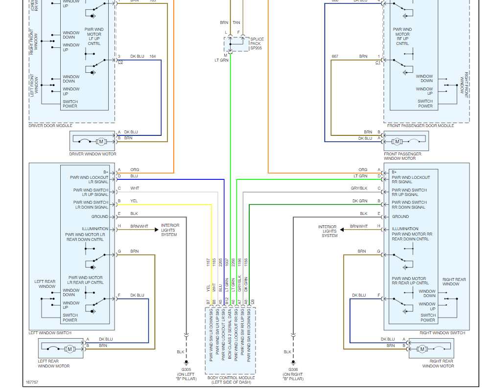

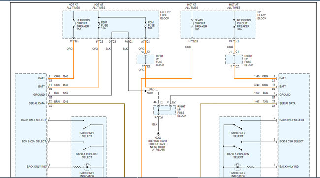

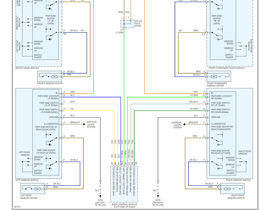

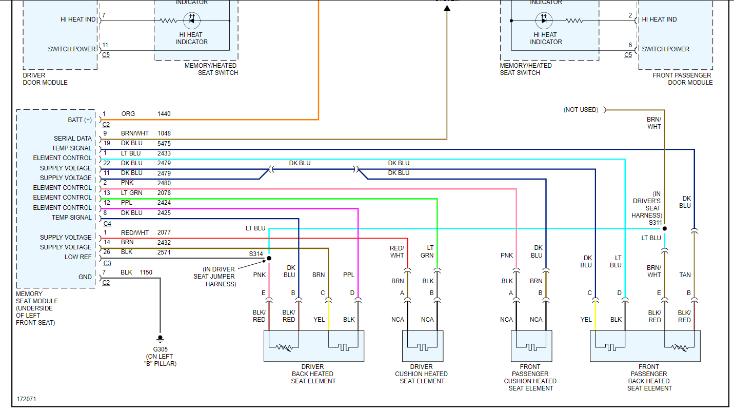

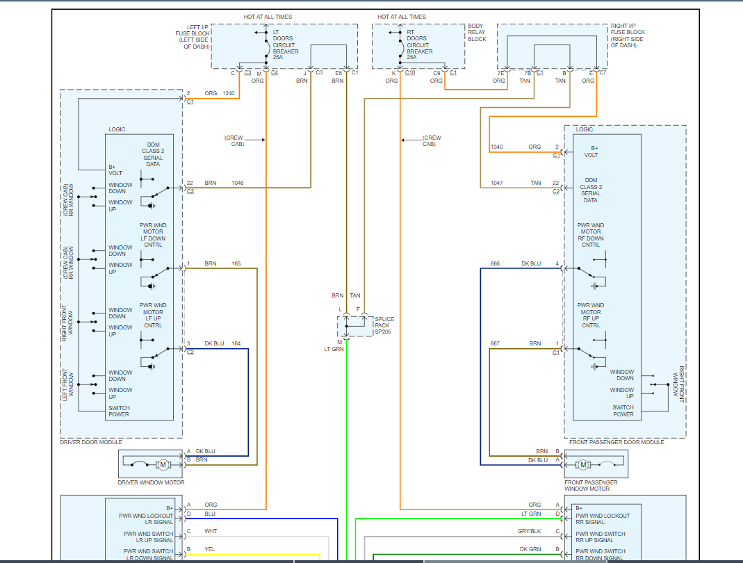

Good afternoon,
I attached the diagrams for you below of the systems you requested.
Let me know if you have any other questions.

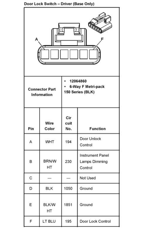

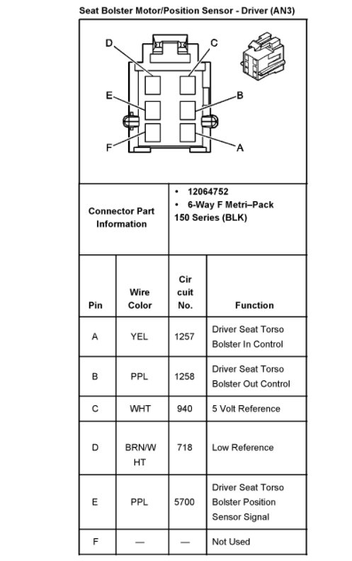

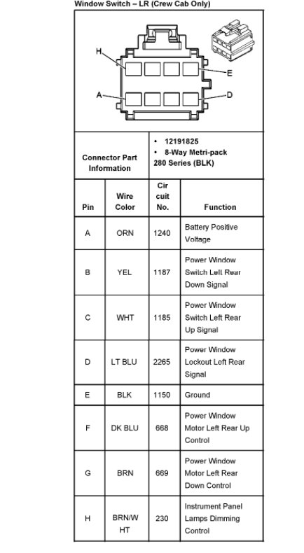

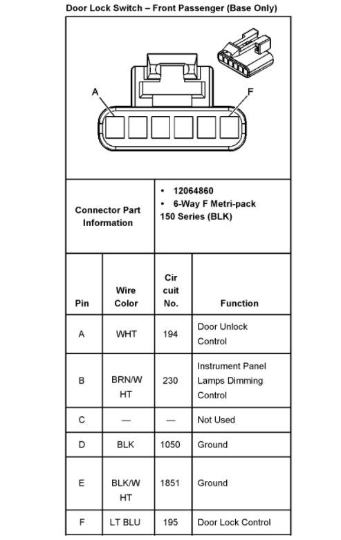

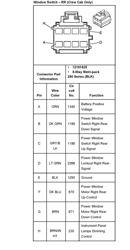

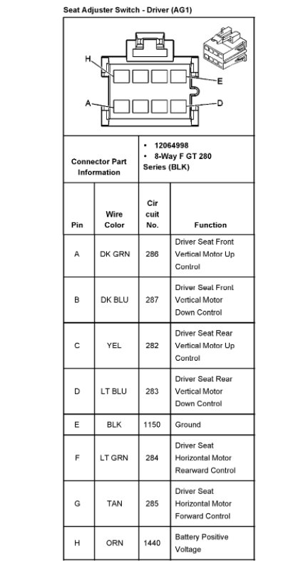

I found connector diagrams for you of the systems as well. I attached them below for you to view.
