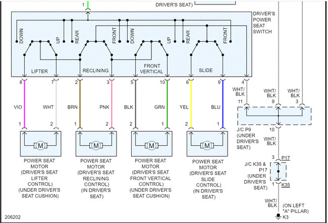

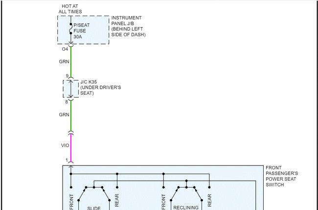

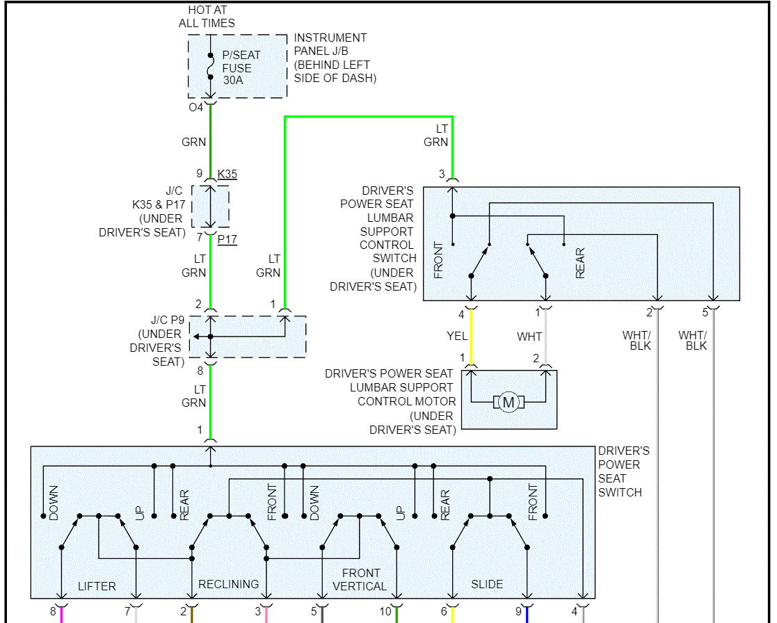

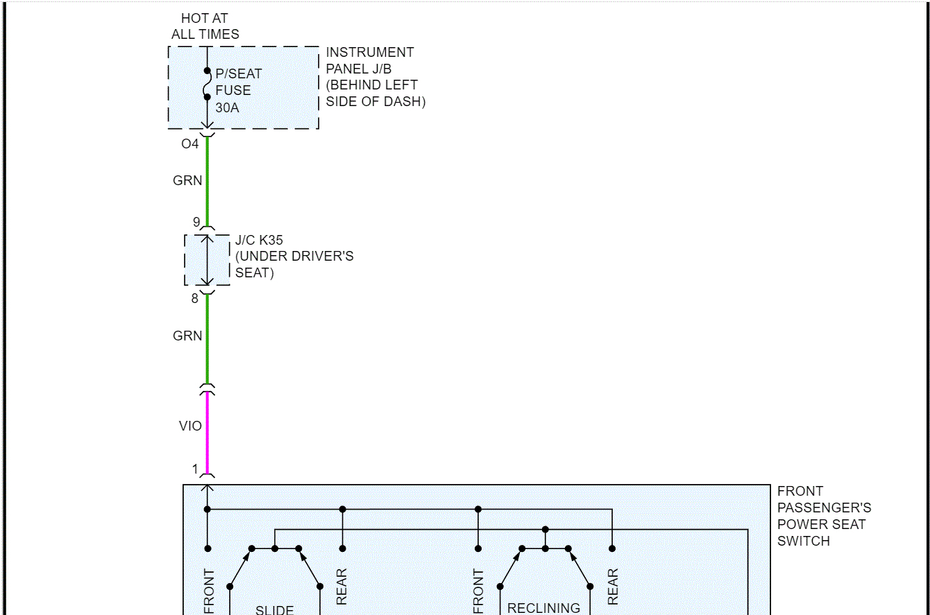

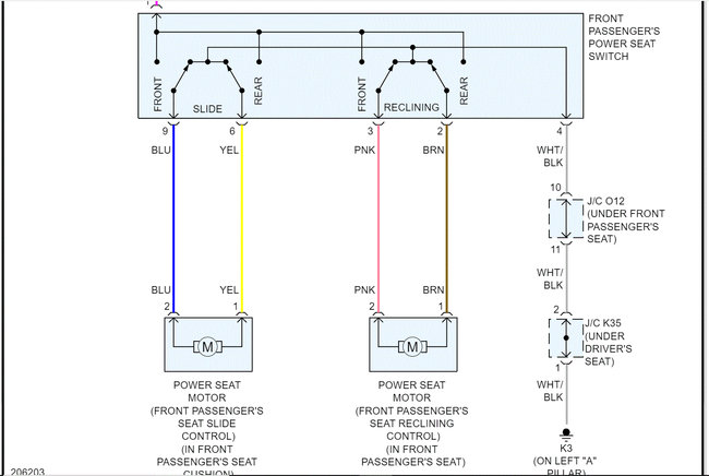

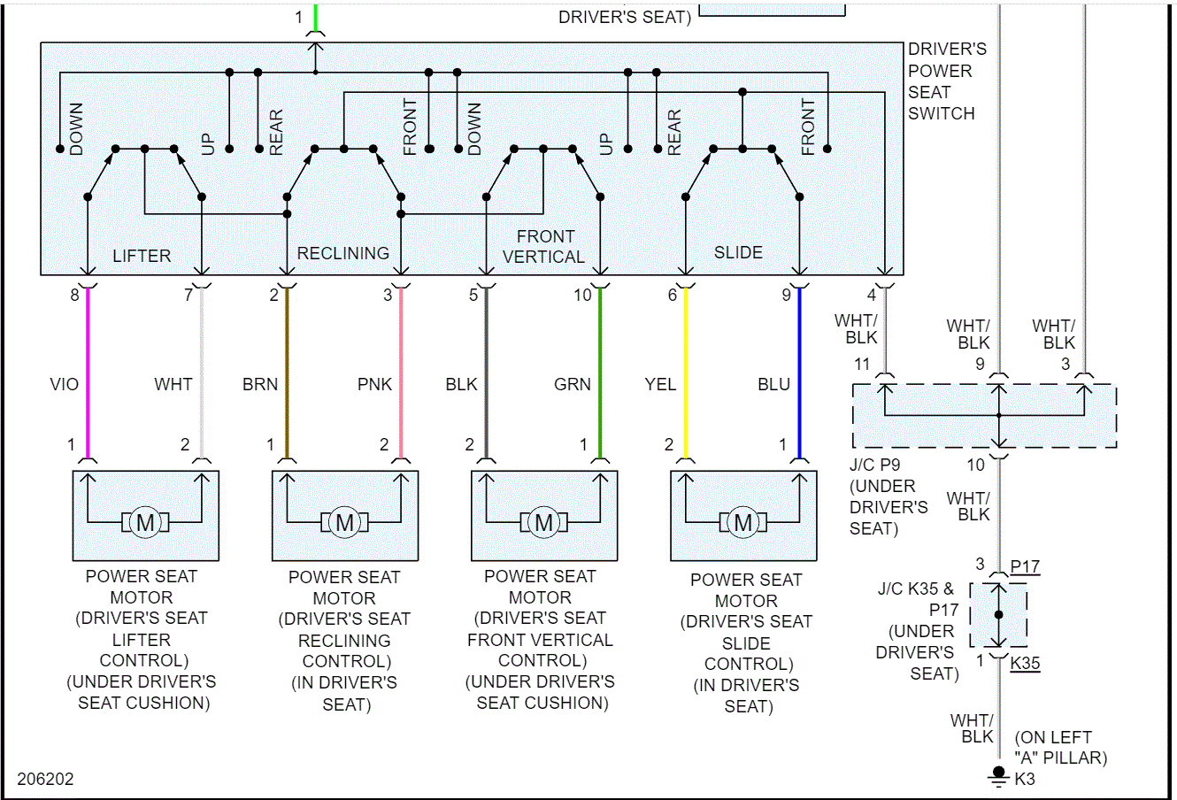

I'm having issues with my power seats in the car. Neither work. The passenger's side didn't work when I purchased the car used, and the driver's side went out last week. I'm trying to solve the issue myself but am in need of a wiring diagram to better understand the power supply to the seats.

I attached the schematics below. The schematics are broken down for driver and passenger. I cut each pic in half to make them readable, so pics 1 and 2 are the driver's side. Pics 3 and 4 are for the passenger side.
