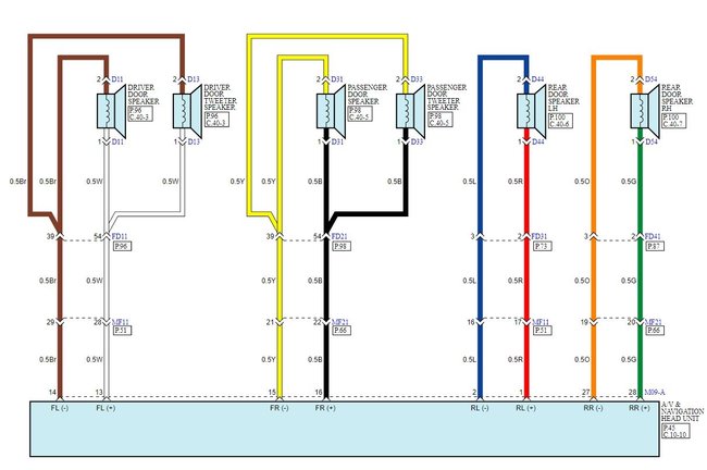

I have been looking for the audio wiring diagram all over the internet. But i haven't found anything, i am trying to install subs in a stock head unit for the vehicle listed above sedan s.

These are the speaker output colors for that car with the AV unit and the base stereo. If I was adding on I would find the rear feeds and add an amp with it's own power feed. Especially with the head unit acting as a communications module in that vehicles network.

Will the diagram work for the Sirius xm and Bluetooth radio?

Shows as the same speaker outputs for both the base and AV radio.
