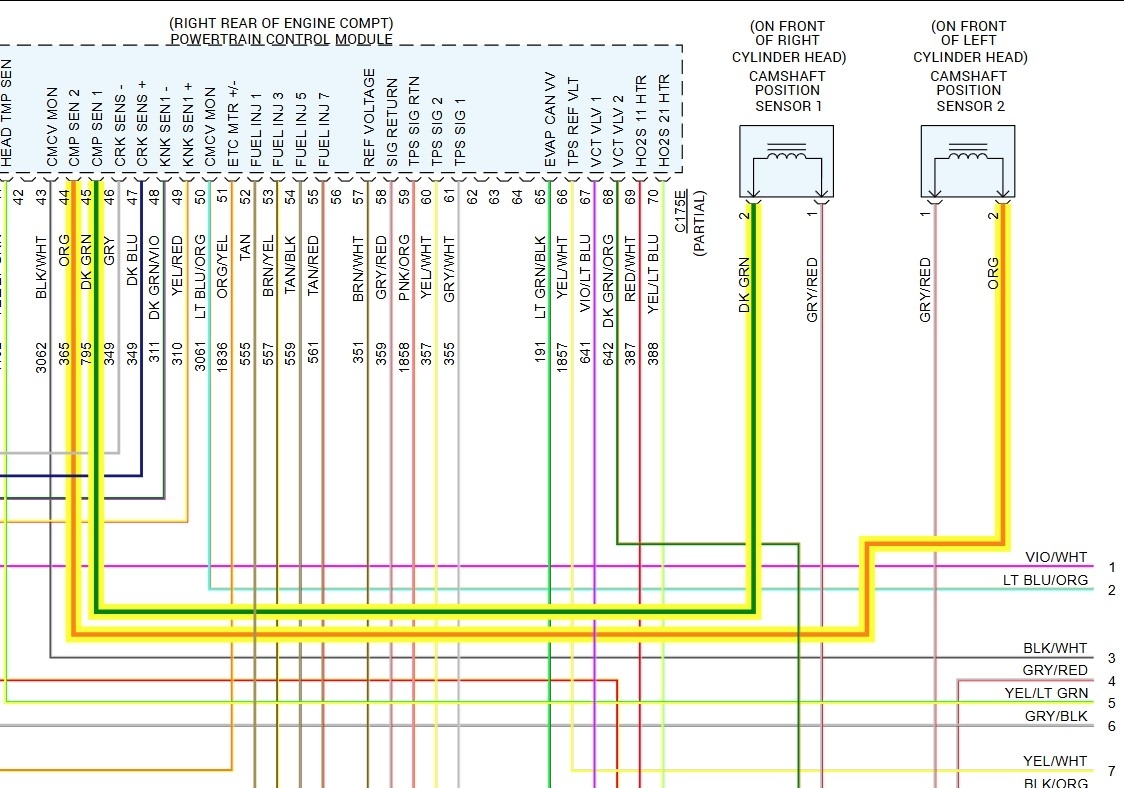

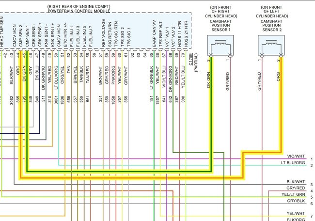

It's a simple circuit. The gray with red wire is the ground side of the sensor; the dark green is the signal to the PCM. As you don't have a code for the other cam sensor, I suspect the issue is the green wire or the PCM itself. I would start at the connector and check pin fitment. Loose or bad contacts are common. The PCM failing is also common.

Just curious. Steve is the other wire (I believe green) in pin #44?
Jun 17, 2025 at 10:20 AM
STEVE W.
  • 15,349 POSTS
Dark green should be in #45. Pin 44 is for sensor 2.
Jun 17, 2025 at 10:26 AM
DANNYBOY5474
  • 35 POSTS
Okay, diagram you provided shows gray/red in pin #45.
Jun 17, 2025 at 10:30 AM
DANNYBOY5474
  • 35 POSTS
I want to check resistance/continuity in both wires through the harness to PCM. After that will check voltage in both wires with KOEO.
Jun 17, 2025 at 10:37 AM
STEVE W.
  • 15,349 POSTS

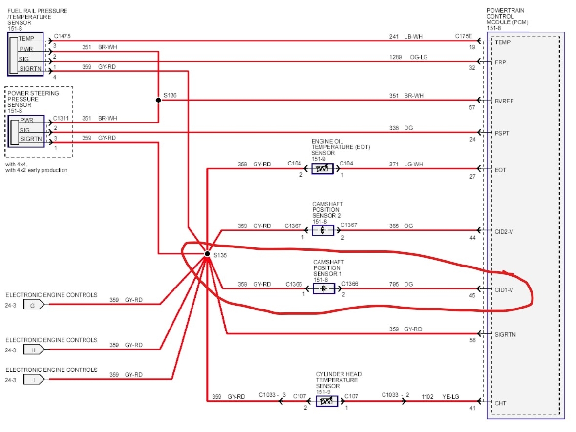

Gray red is the ground for all the sensors and is on pin 1 in each cam sensor. For sensor 1 there is a dark green that goes into pin 45 on the PCM. You would want to look at the continuity from pin45 to pin 2 in the sensor connector. Then to check the ground side go to the other cam sensor and check for continuity between both pin ones in the connectors. The sensors are both simply coils of wire wrapped around a metal core. As the camshaft rotates the reluctor on the end where the sensor is passes the tip of the sensor and generates a small pulse. The PCM sees the pulses and counts them to determine camshaft position. If your meter can read millivolts, you might see the voltage the sensor generates.

There won't be voltage there, the sensor generates the voltage itself. If you have no continuity on the dark green from pin 2 on the sensor connector to pin 45 on the ECM, that is the issue. An easy way to be sure is to check pin one in the connector to ground. Then jump pins one and two in the connector and now go to pin 45 and check if it is grounded in that connector. No ground, it's an open wire. It's going to be a pain, but you can open the loom and trace the wire, or much simpler. get a section of new wire and replace the bad one. To see if the issue would let you simply splice into the wire, take your meter and a pin, go about 6 inches from the connector on one end and push the pin into the wire center. Now test, if you have continuity, cut the wire where the pin is and strip it back a bit. Now go to the ECM end and do the same. Now you can add in the new wire between those pieces.

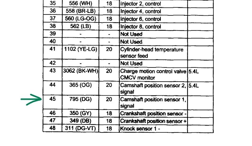

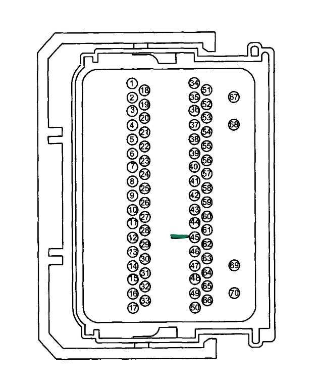

Do you by chance have a numbered Pic of the PCM harness connector #45? The connector isn't numbered. Thanks again.
Jun 19, 2025 at 12:57 PM
STEVE W.
  • 15,349 POSTS
Try this. It's a black 70 pin connector 175E. Pin 44 is an orange wire (cam 2) #45 is dark green (cam 1) 46 is gray (crank 1)
