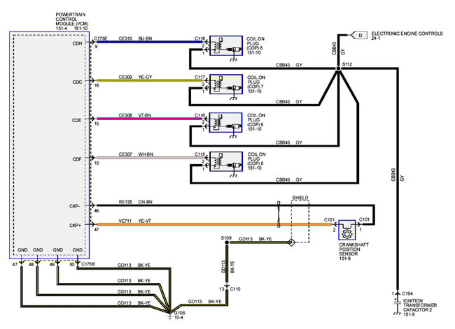

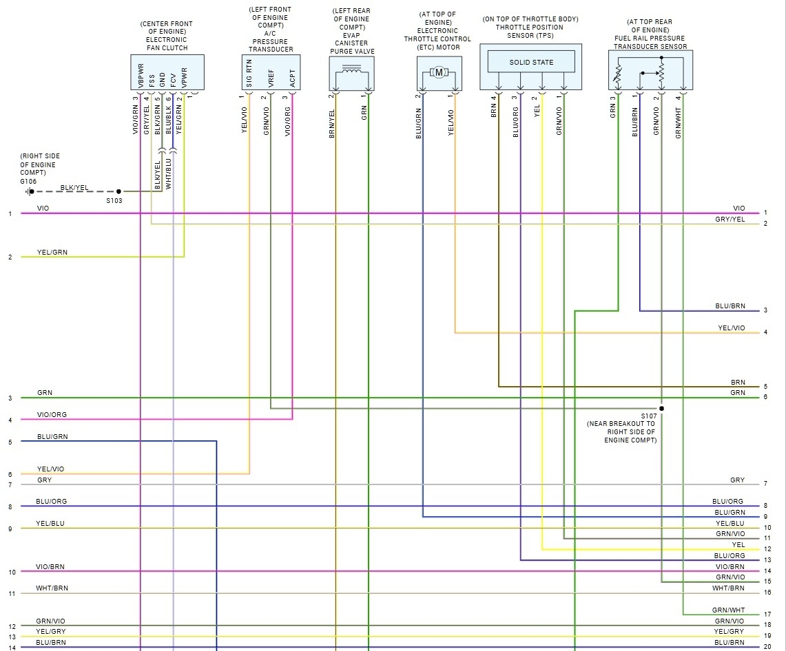

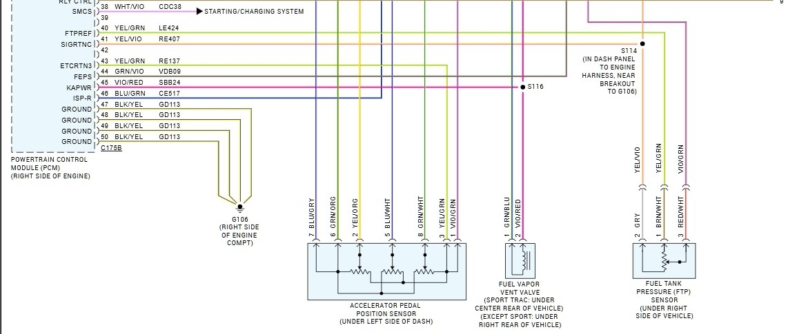

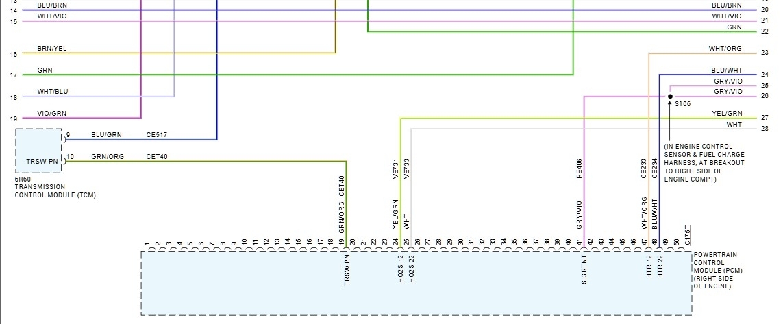

Can someone find a wiring diagram for the PCM? I need to test some wires. Thank you.
Aug 7, 2024 at 4:44 AM
AL514
  • 5,668 POSTS
Hello, yes, we can do that for you, just a couple minutes.
Aug 7, 2024 at 7:18 AM
AL514
  • 5,668 POSTS

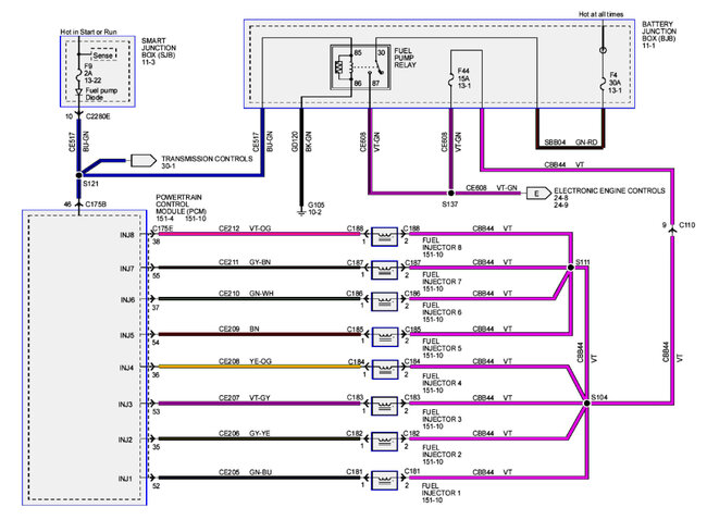

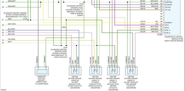

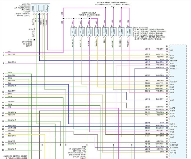

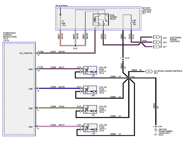

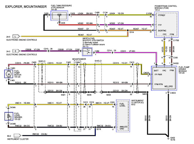

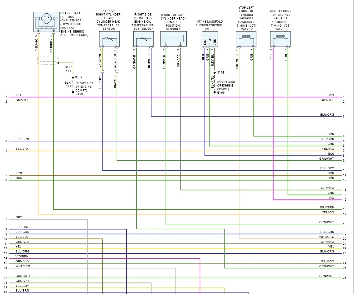

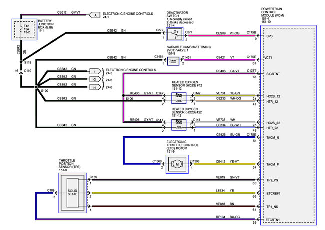

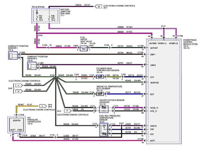

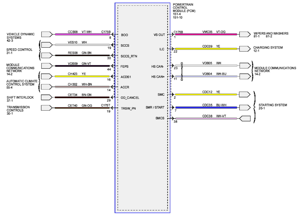

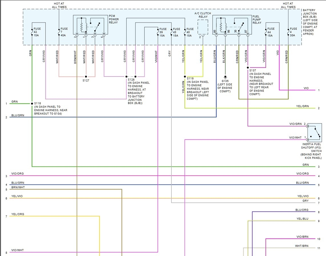

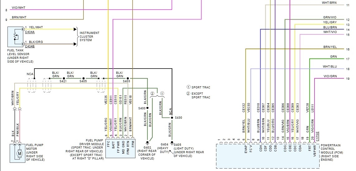

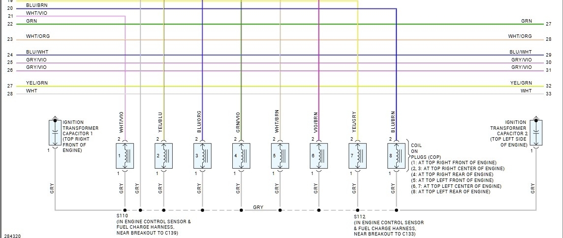

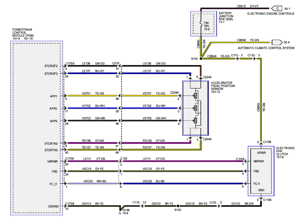

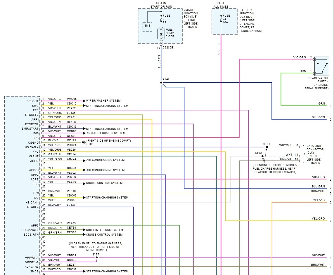

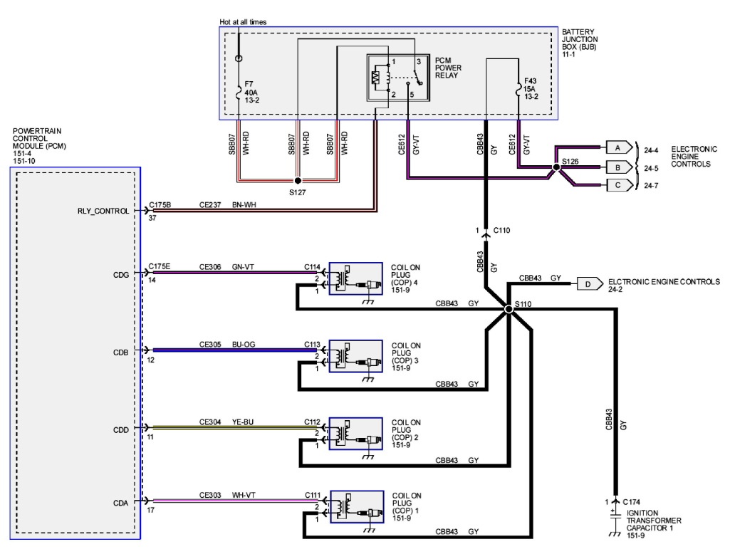

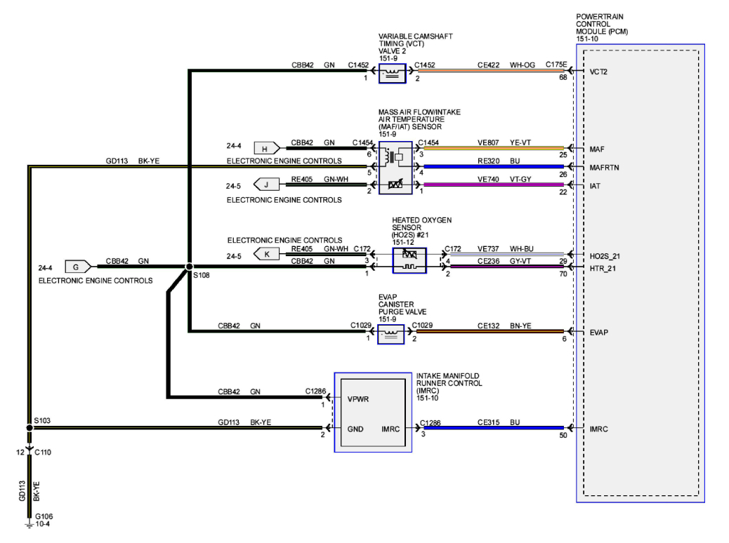

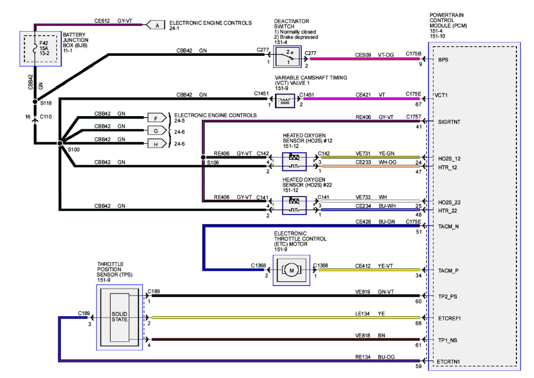

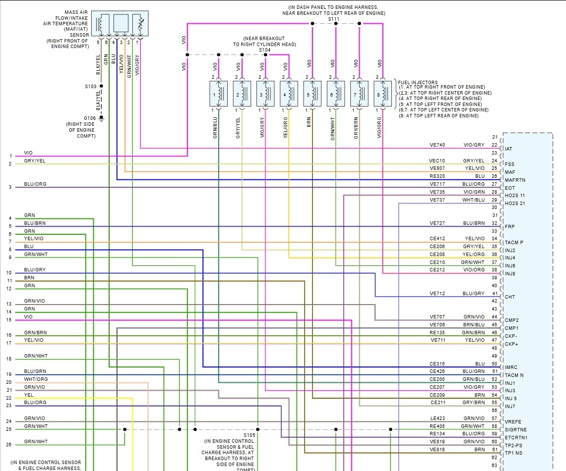

These are the aftermarket PCM wiring diagrams, diagram 1, 2 go together, top and bottom, then 3, 4 and so on. Zoomed out on one page they are difficult to read, I will also post the OEM PCM diagrams here as well, just in case you see any differences. The OEMs look clearer as well.
Aug 7, 2024 at 7:39 AM
AL514
  • 5,668 POSTS

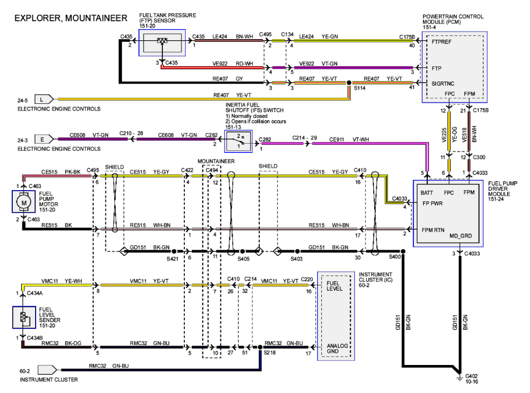

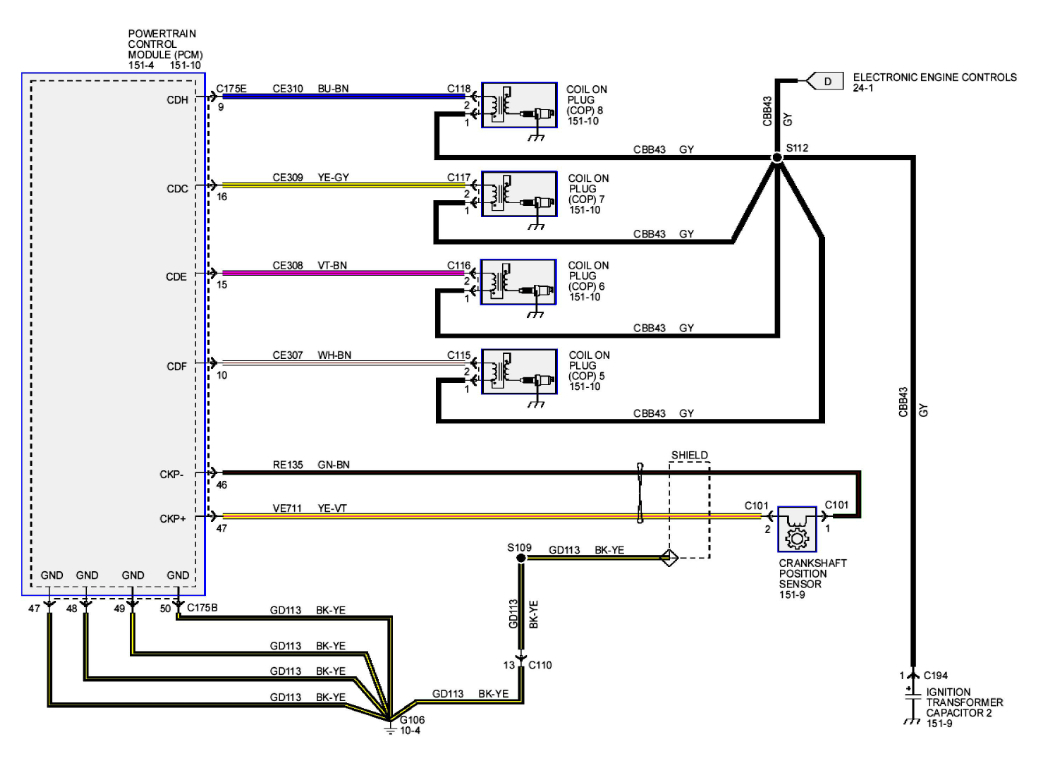

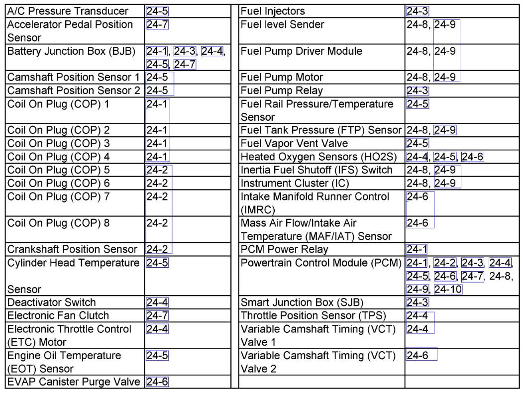

These are the Powertrain OEM diagrams along with the index last if you need anything specific.
Aug 7, 2024 at 7:49 AM
JACKSOB4
  • 5 POSTS

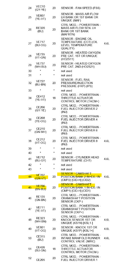

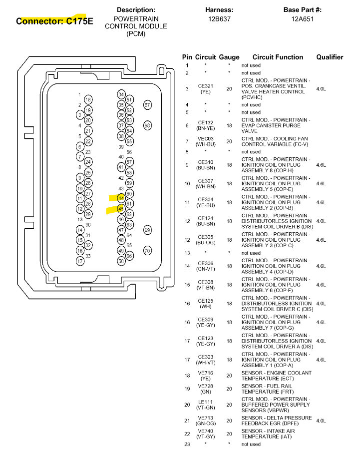

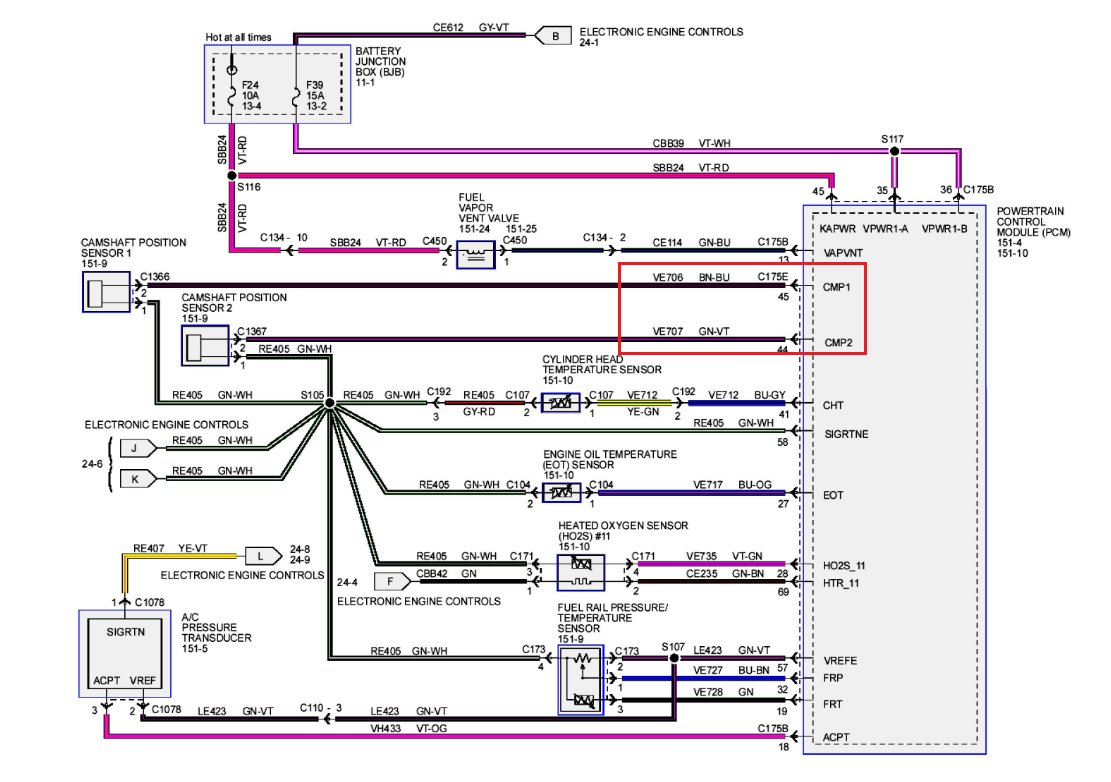

Thank you. That is what I need. Does anyone know how the pins are numbered on the PCM? I'm trying to see if my signal wire for the camshaft position sensor is bad. Thanks.
Aug 7, 2024 at 8:33 AM
AL514
  • 5,668 POSTS
Yup, so for the PCM connectors since there's 3 its best to identify the correct connector by the wiring colors and their locations. The cam sensors are pins 44 and 45, Pin 44 is green/violet, and Pin 45 is brown/blue. The connector diagram 1 below is looking at the connector pins, that's the view, so from the back of the connector it will be the opposite.

All the wiring tested good. Decided to throw a new timing set on it since the factory chain was not marked. That fixed the issue. The codes I was getting were P0345, P0349, P2195, and P2197.
