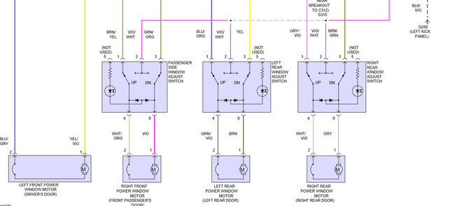

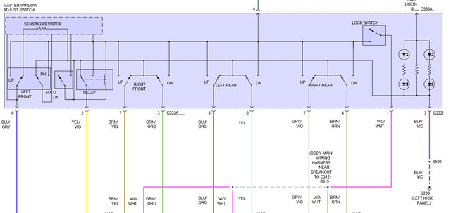

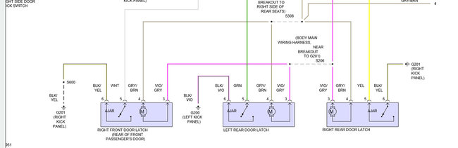

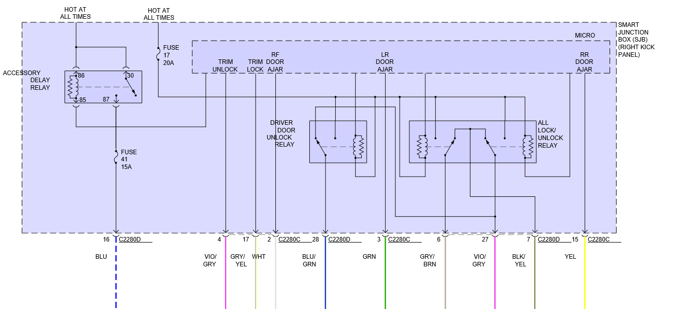

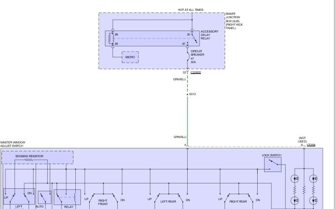

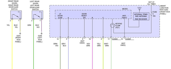

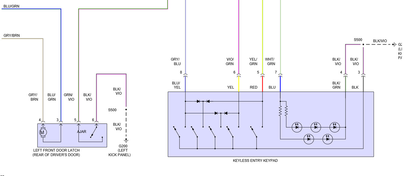

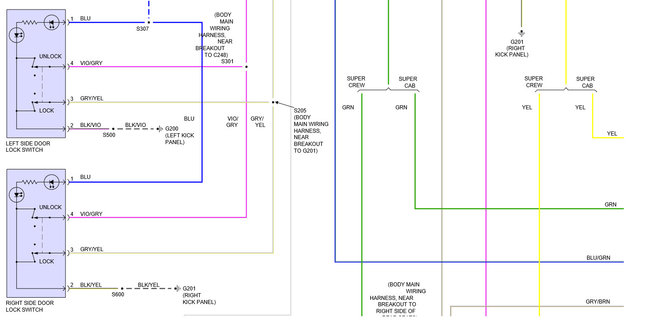

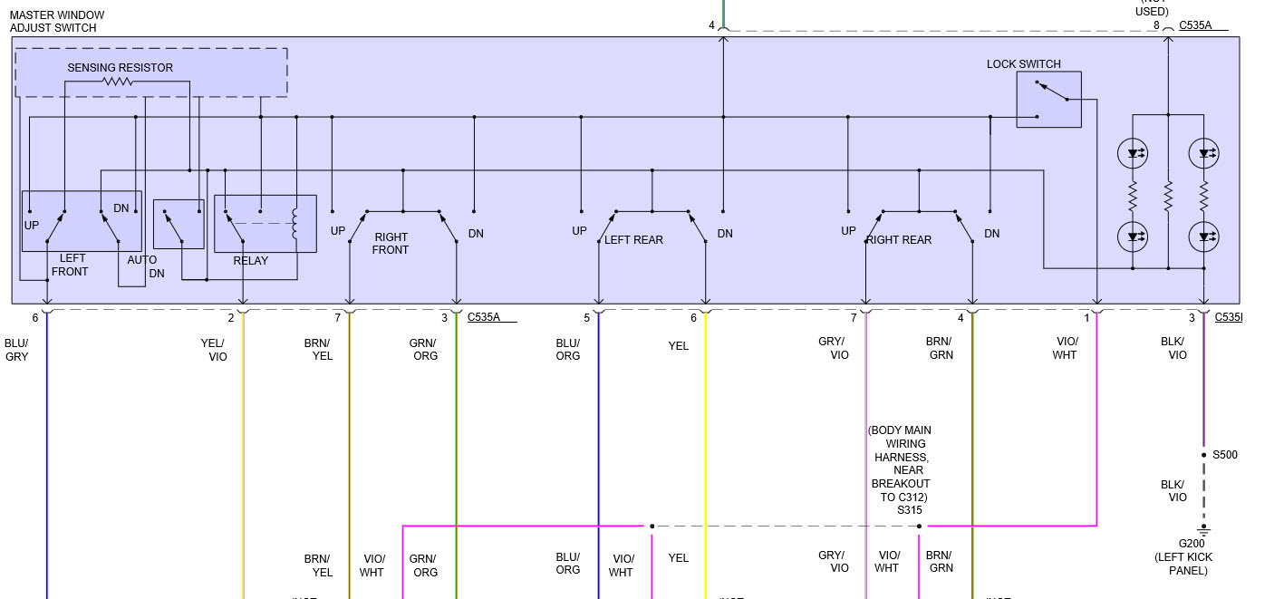

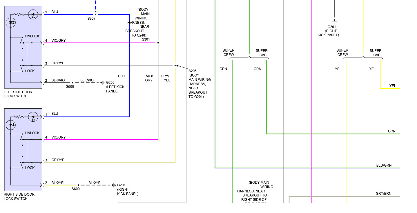

I am looking for the wiring configuration/ pin out for the power windows and power locks for a 2009 F-150 super cab.

See pictures below.
Feb 25, 2016 at 11:09 PM
JDL
  • 16,098 POSTS
The information I looked at was for 2009.
The diagram is for power windows. Check for voltage at circuit breaker. Also, check wiring on hinge side of driver door. The driver door is open and closed so much, sometimes the wires in the harness may break?

Thanks guys. My truck came without power windows so I added them, I got oem door panels and switches so I just needed the pinout for those. Thank you!
