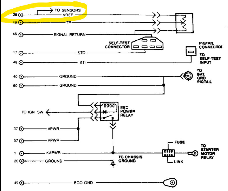

Need to trace wires to find loss of 5V reference.

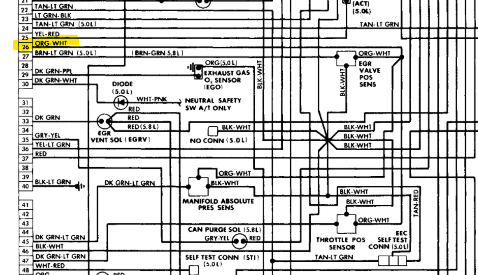

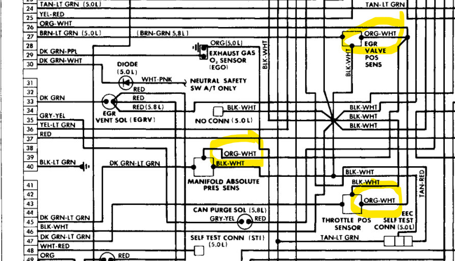

Okay. so, it appears the 5-volt reference is this orange/white wire, in the diagram it's not labeled but it's shared with the MAP sensor, EGR valve position sensor, and the Throttle Position Sensor.

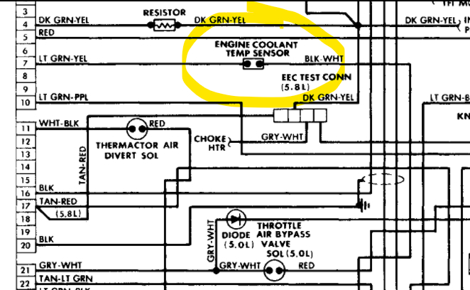

The black/white appears to be the ground, the reason I say that is if you look at the second diagram, it's the Temperature sensor, and it cannot share a 5-volt reference and the wire runs directly back to the ECM, and the black/white wire runs out into the Harness and can be shared with other sensors.
Okay, the last diagram confirms the Ref Voltage at Pin 26 going to TPS. So, it is the orange/white wire.
Looks like its Pin 26 at the ECM running out to the sensors.
