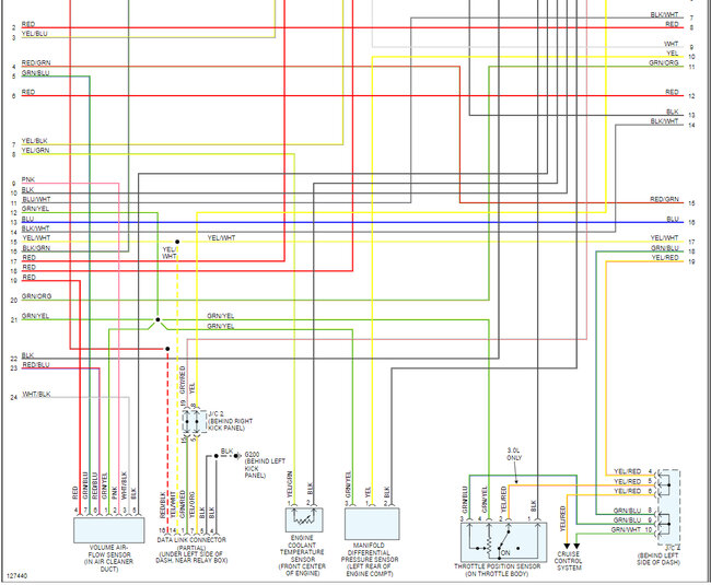

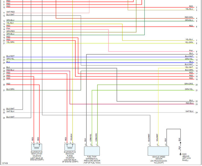

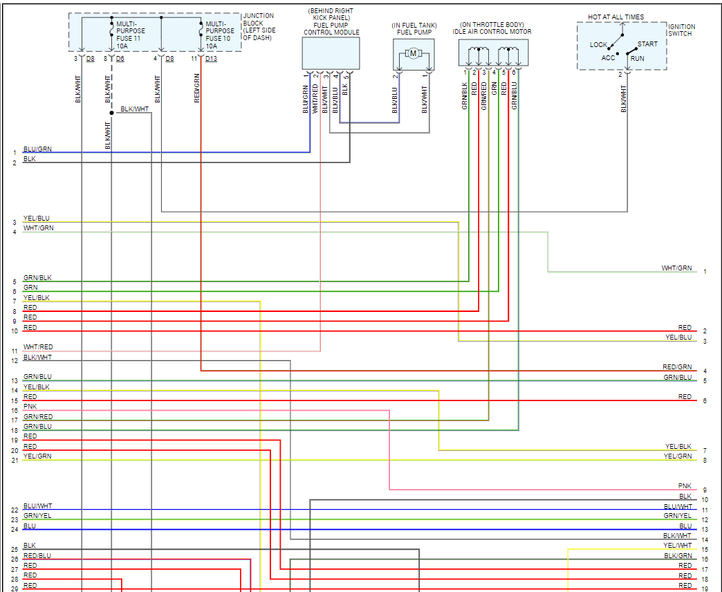

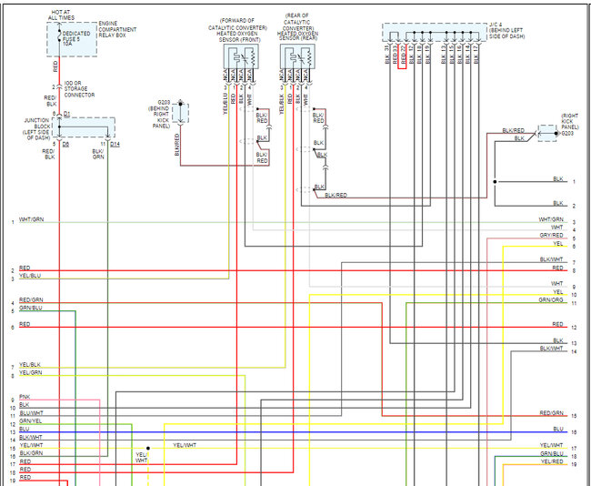

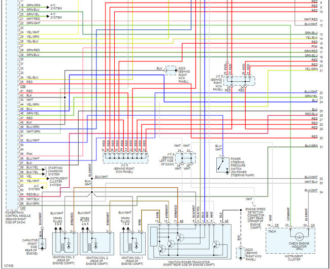

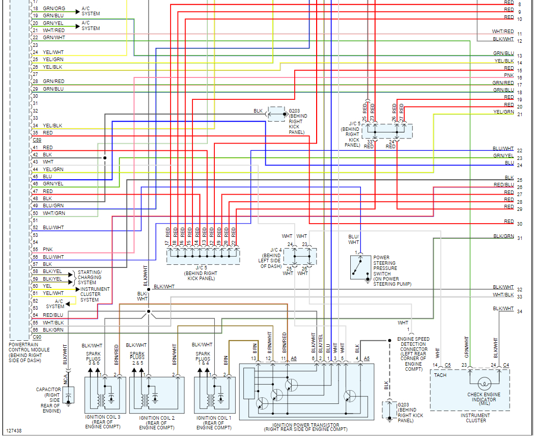

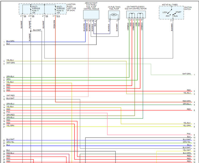

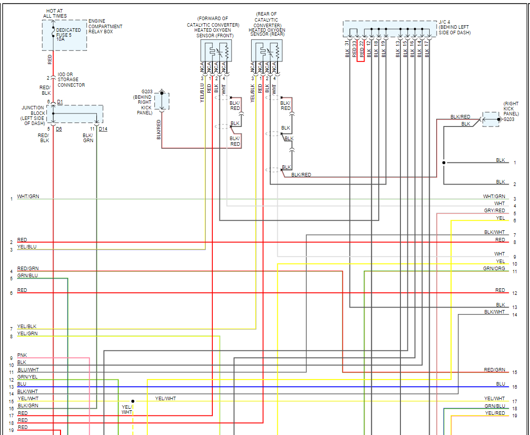

i need the same diagram as this one but only for the 6g72.
Nov 29, 2023 at 12:03 AM
Experienced Mechanic
55,721 POSTS

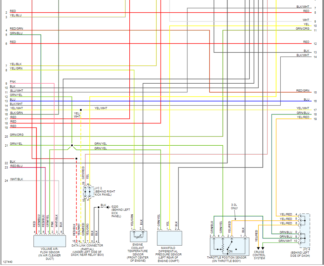

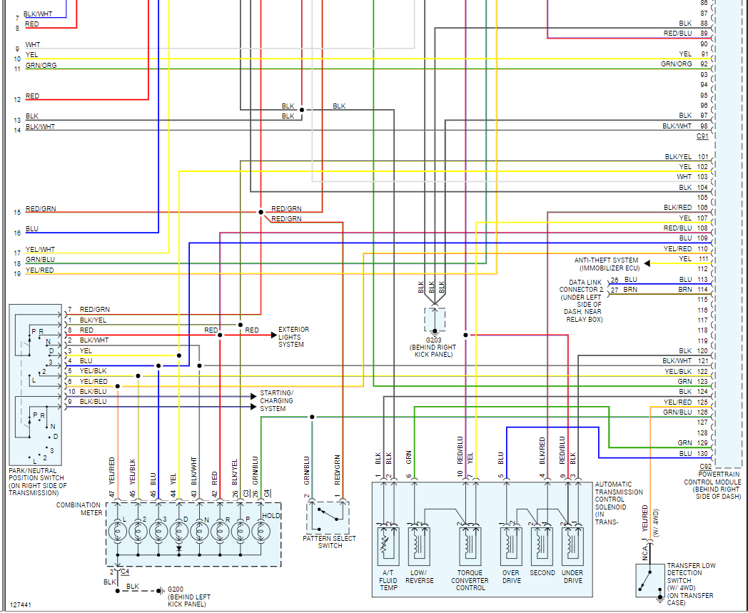

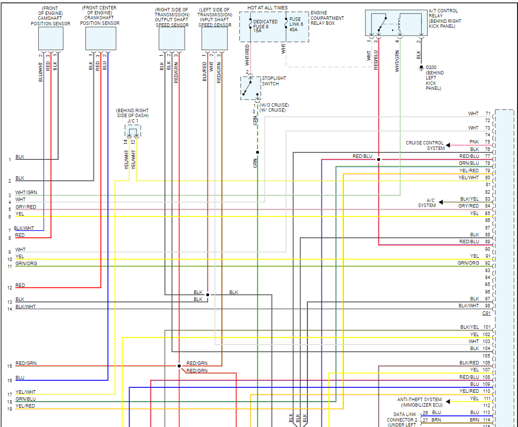

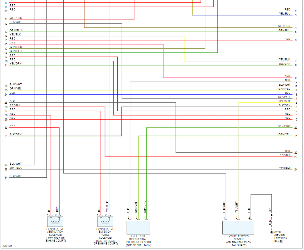

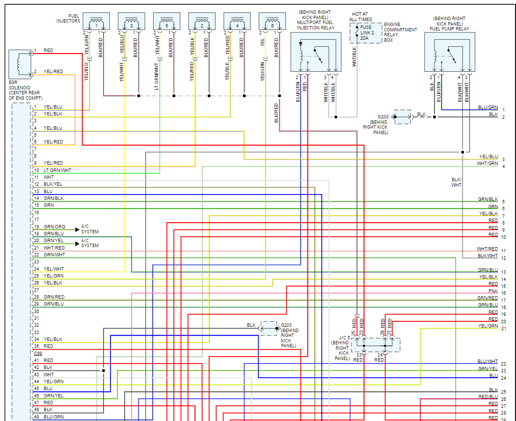

Here is a guide to help you with the continuity test and the engine wiring diagrams below:
Check out the images (below). Let us know if you need anything else.

Thank you very much, it was just what i needed.
