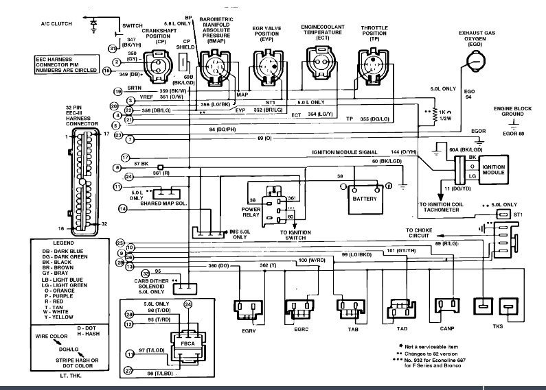

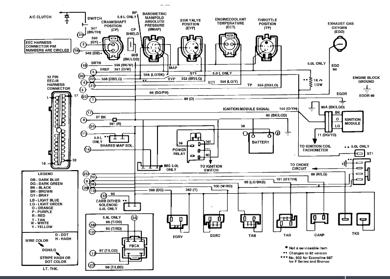

I need complete wiring for the engine compartment, with dual battery. This is a motorhome.
Nov 3, 2022 at 11:44 AM
  • 110,244 POSTS
Because of the model year, schematics are difficult to come by. Also, the body company that installed the camper likely changed things.
I'm not sure if this is an E250 or E350. Also, I need confirmation on the engine size. I believe you meant a 5.8L. Please confirm.
I attached what I have for the powertrain management schematics below. They are for the engine I mentioned.
See pic below.

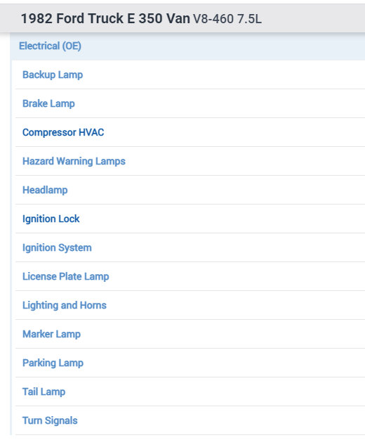

I tried, but there is nothing specific to the powertrain management circuits. I added the list I have below. See if there is anything there that will help.
See pic below.
Nov 5, 2022 at 11:10 AM
187HASSLE
I misinformed you about the engine size. It's a 351W. Yes, the ignition system. Someone had rewired under the hood with whatever was lying around, then had a fire(surprise). I have no experience with dual battery systems. I have all the lights, nothing but a clunk sound from one of the starter relay when key is turned.
Nov 5, 2022 at 12:15 PM
  • 110,244 POSTS

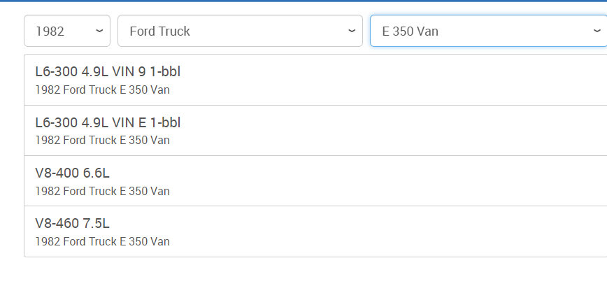

You are going to laugh at me, but the 351 wasn't used on the E350. The 460 was. LOL See the pic below.
Nov 5, 2022 at 3:02 PM
187HASSLE
Here you can laugh at both of us now because it's a 400 and 6.6 l do you have any electrical schematics on the engine compartment.

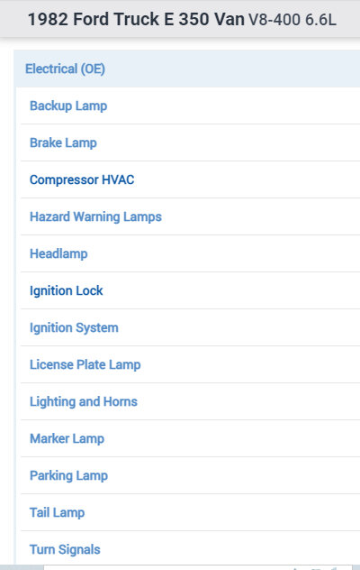

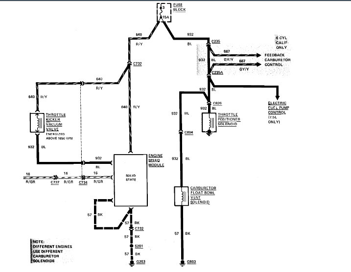

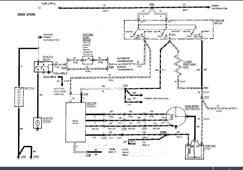

No problem. I attached what I have as far as the powertrain control circuits. Pics 1 and 2 are of the ignition system. The last pic shows what I have available. There really isn't too much because of the model year.
If you see something in pic 3 you need, let me know.
Nov 7, 2022 at 10:23 AM
187HASSLE
Thanks very much if you would the" ignition ' one probably wouldn't hurt to have.
I just got to tell you,
You guys are awesome, you have helped me out more than once.
Cheers
Nov 7, 2022 at 11:04 AM
  • 110,244 POSTS
Thank you and you are very welcome. As far as the ignition system, that is the one I attached above. Is there something other you need?
