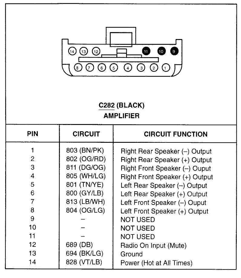

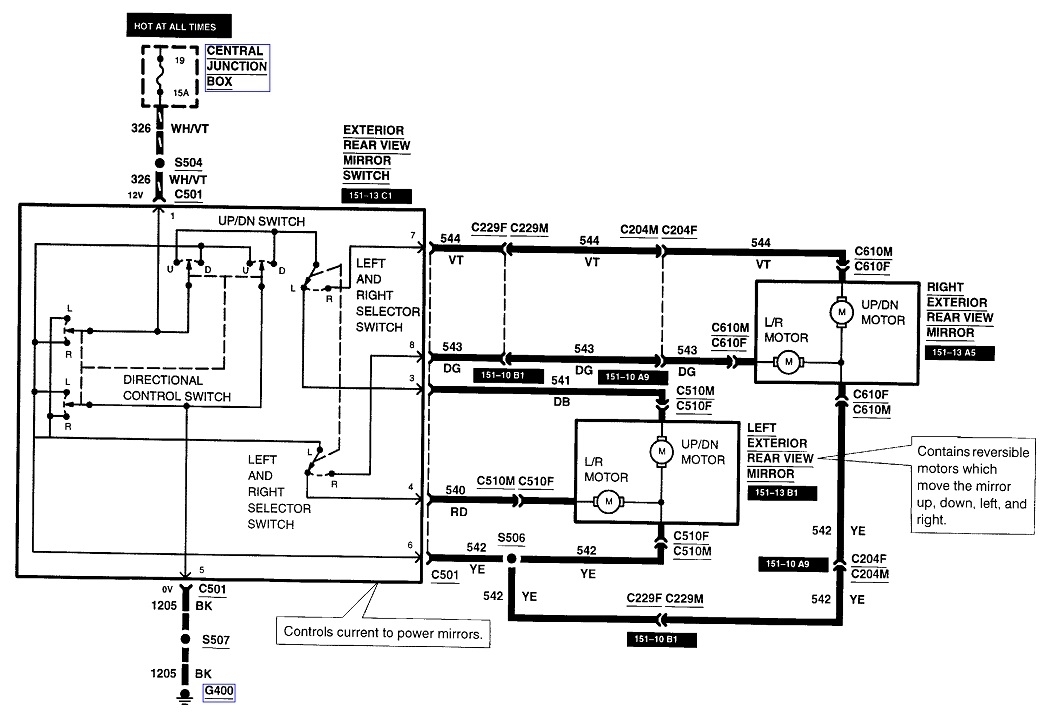

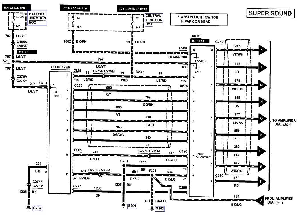

I need a complete wiring diagram some accessories don't work, and some wires have been cut and I want to go through and get everything working properly.

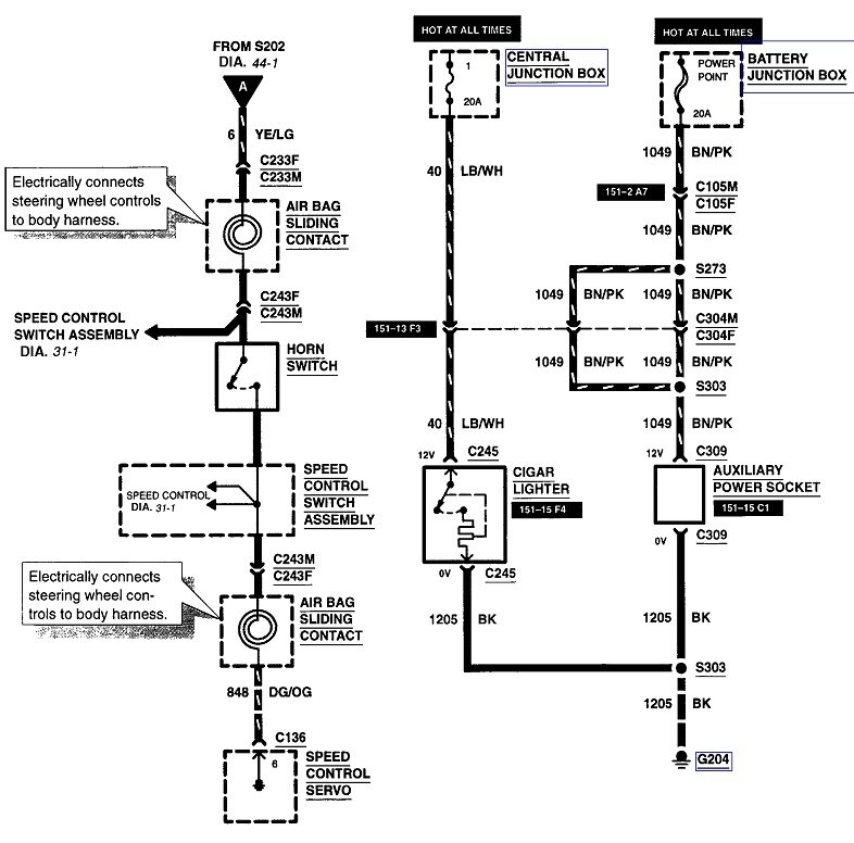

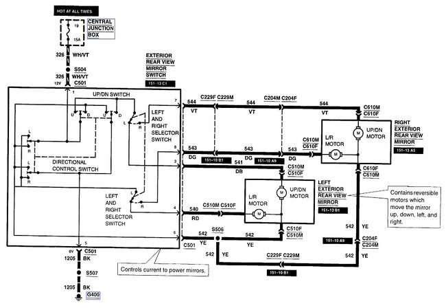

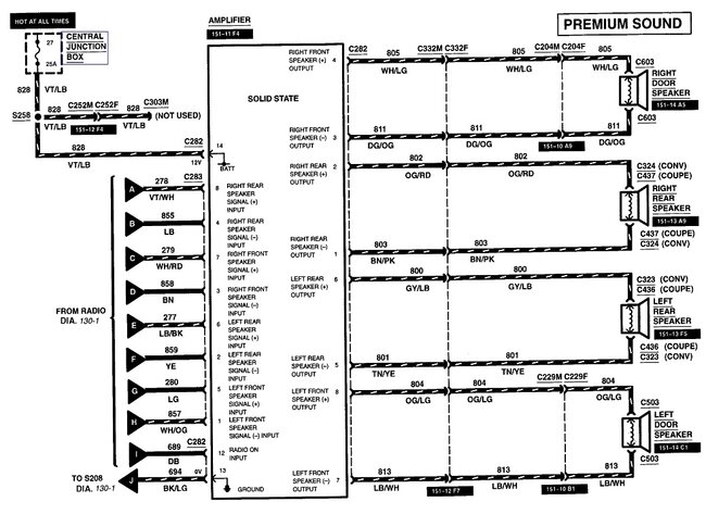

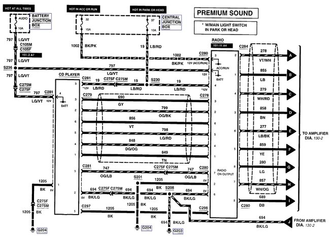

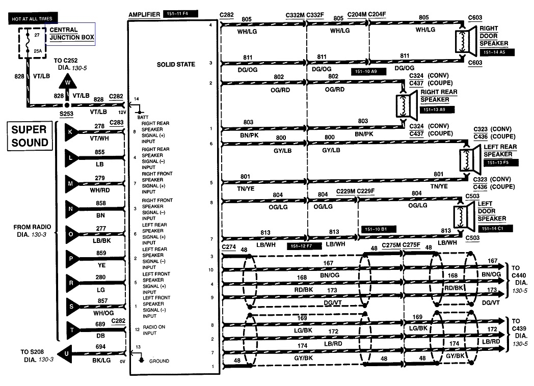

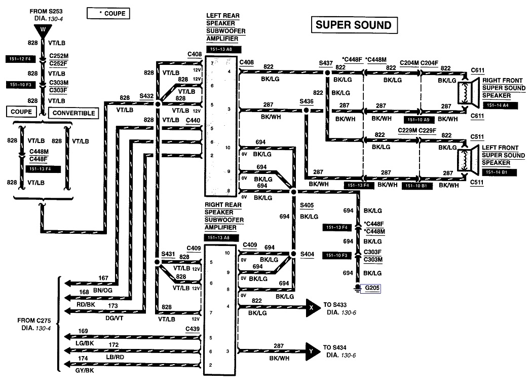

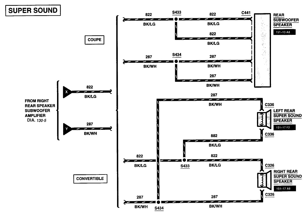

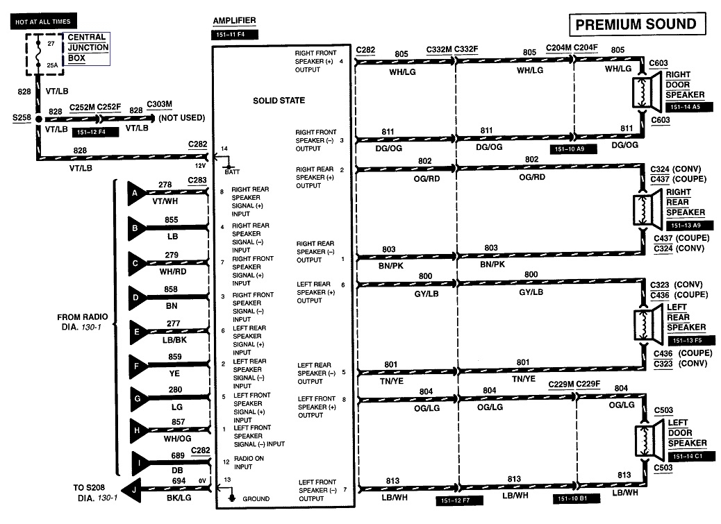

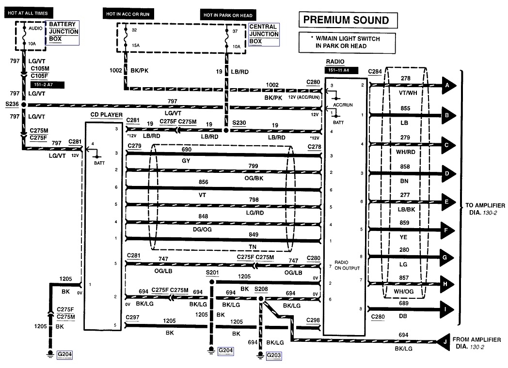

Okay, I know specifically I need the radio, cigarette outlet, and the electric mirror adjust, if you can help, I've looked for hours trying to figure it out.
May 15, 2023 at 11:58 AM
CARADIODOC
  • 34,386 POSTS
First diagram is for the cigarette lighter.

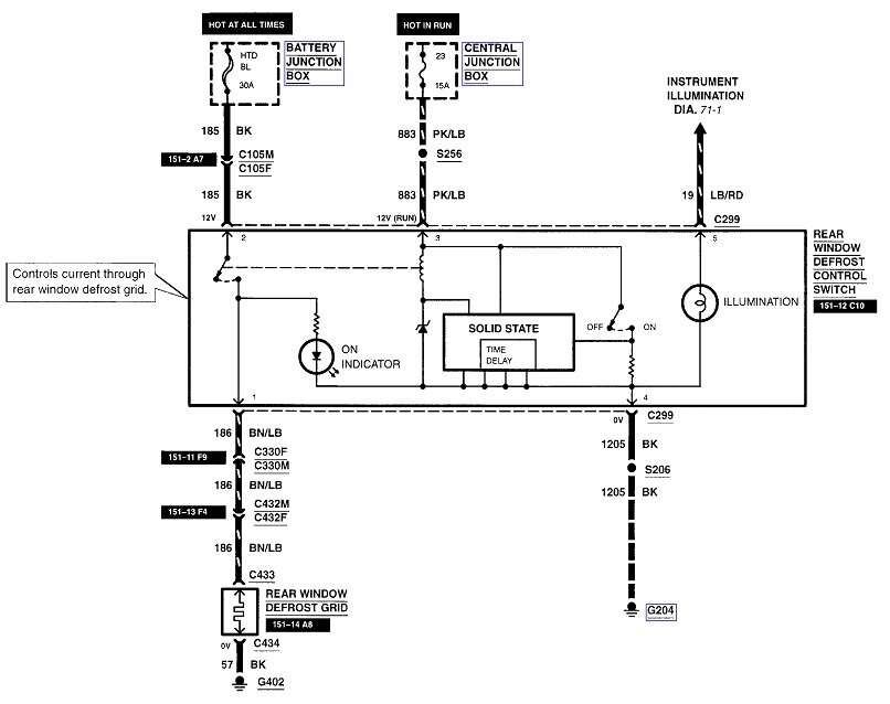

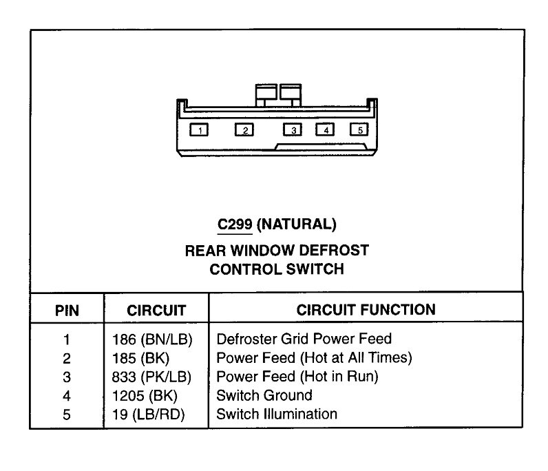

There's two listings for the mirrors. The third diagram is for power mirrors. For the heated mirrors, it says to use the "heated glass" diagram. That's the second one. The connector view for the rear defrost switch is in the fourth drawing.

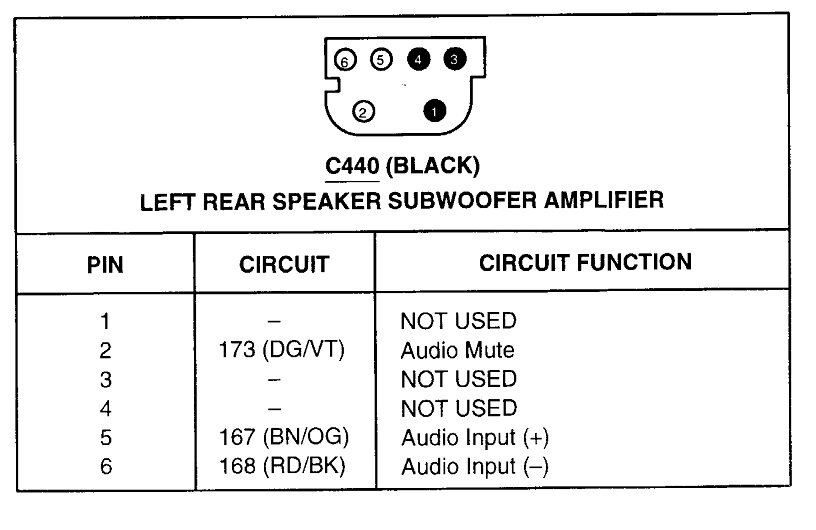

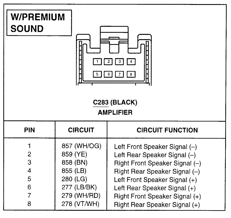

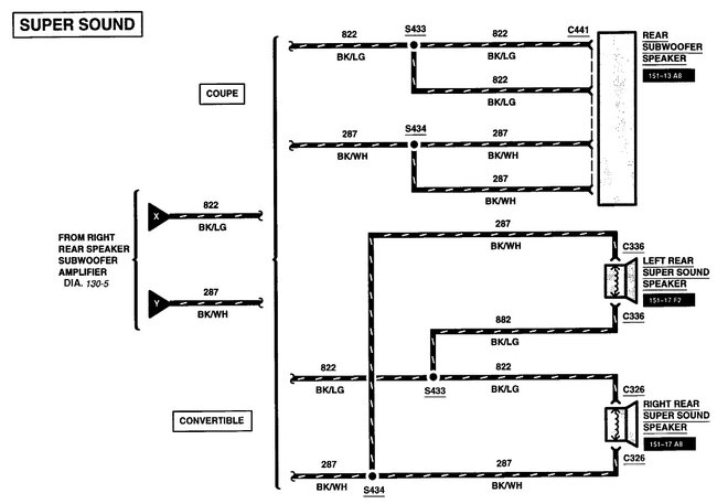

There's also two versions of the radio system. The fifth and sixth diagrams are for the "Premium" version. Diagrams seven through ten are for the "Super Sound" system.

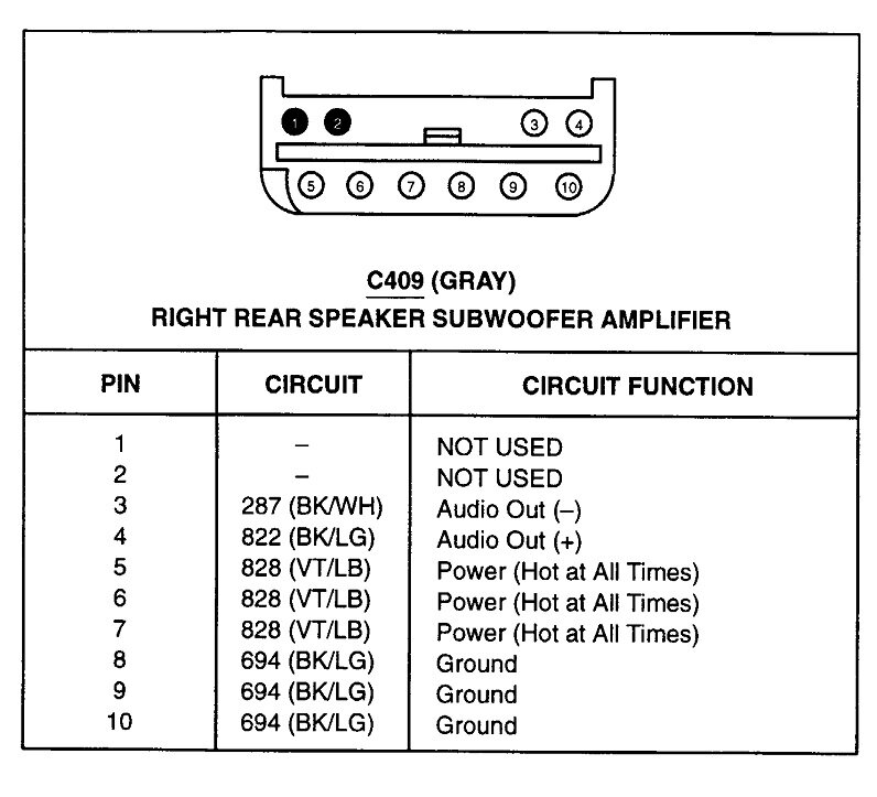

The last seven images are for the plugs for both systems. I'll let you figure out which ones apply to your car.
