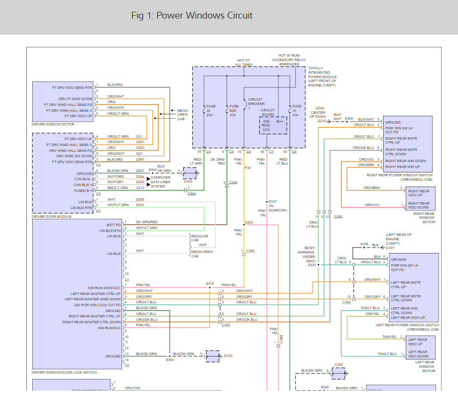

Window Wiring diagrams Please
2011 RAM 3500
85,000 MILES • 6.5L • 6 CYL • 4WD • AUTOMATIC
JVB1

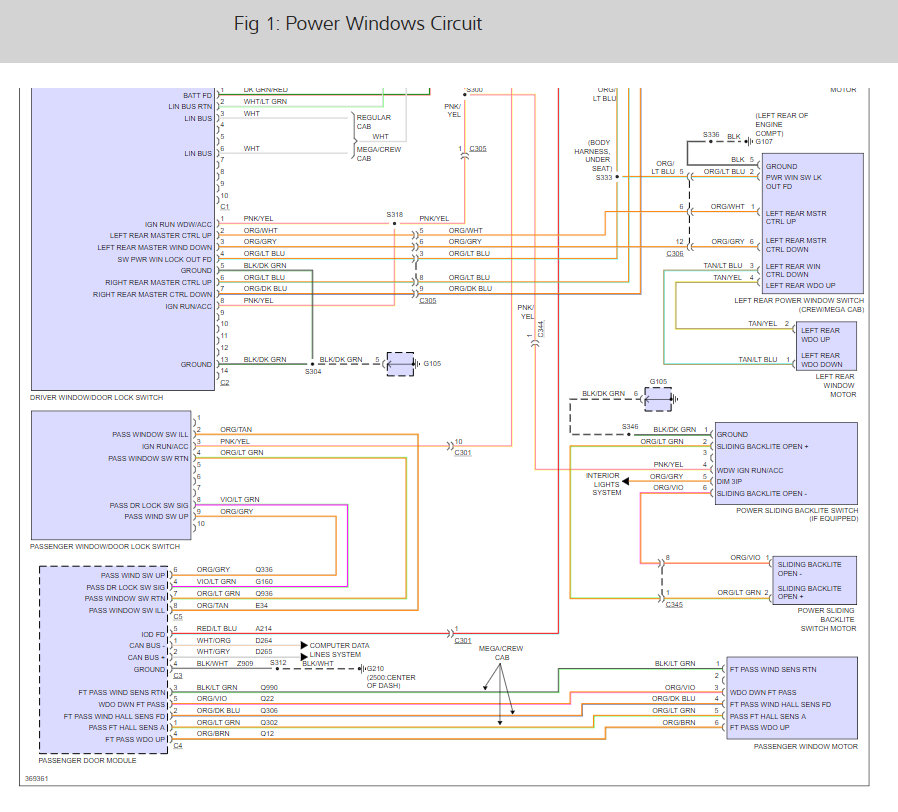

I am installing a rear power slider in my truck which did not have a factory installed one. The window is in an connected to the harness coming from the headliner. Lowering the front of the headliner there is no harness for the overhead console.
I think that the harness goes to a relay connection and is dead ended there. I want to complete the harness so I can use the same factory harness but need a wire diagram for this.
Can you help?
Mar 17, 2019 at 6:26 AM
  • 55,433 POSTS
Here is a guide to help you test the wiring and the window wiring diagrams so you can see how the system works below:
Mar 18, 2019 at 7:36 AM
