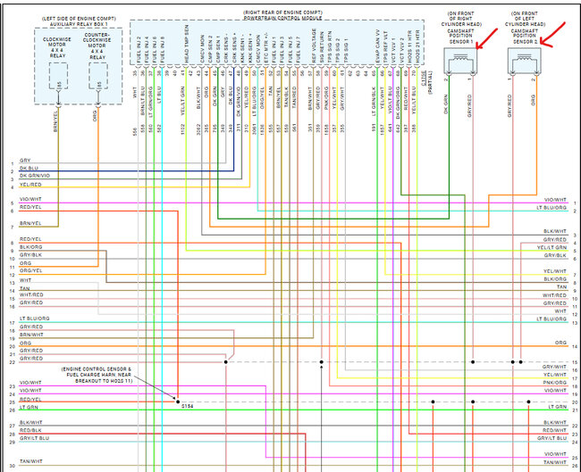

I have an engine code that shows the camshaft position sensors are not sending data. I have replaced both sensors several times now and replaced one of the pigtail connectors but the issue is still not resolved. I have been watching your youtube video to try and test the connectors to see if it is a wiring issue or bad connector or possibly, hopefully not, the pcm itself. my connectors to the pcm do not look the same as the one in the video and i am not sure how to figure out which pinhole the wires are connected to, to do the voltmeter check. Can you please send a wiring diagram? I checked the all data site and have to join their membership in order to access their information, which just costs more money i don't have right now.any help would be appreciated. Thank You.

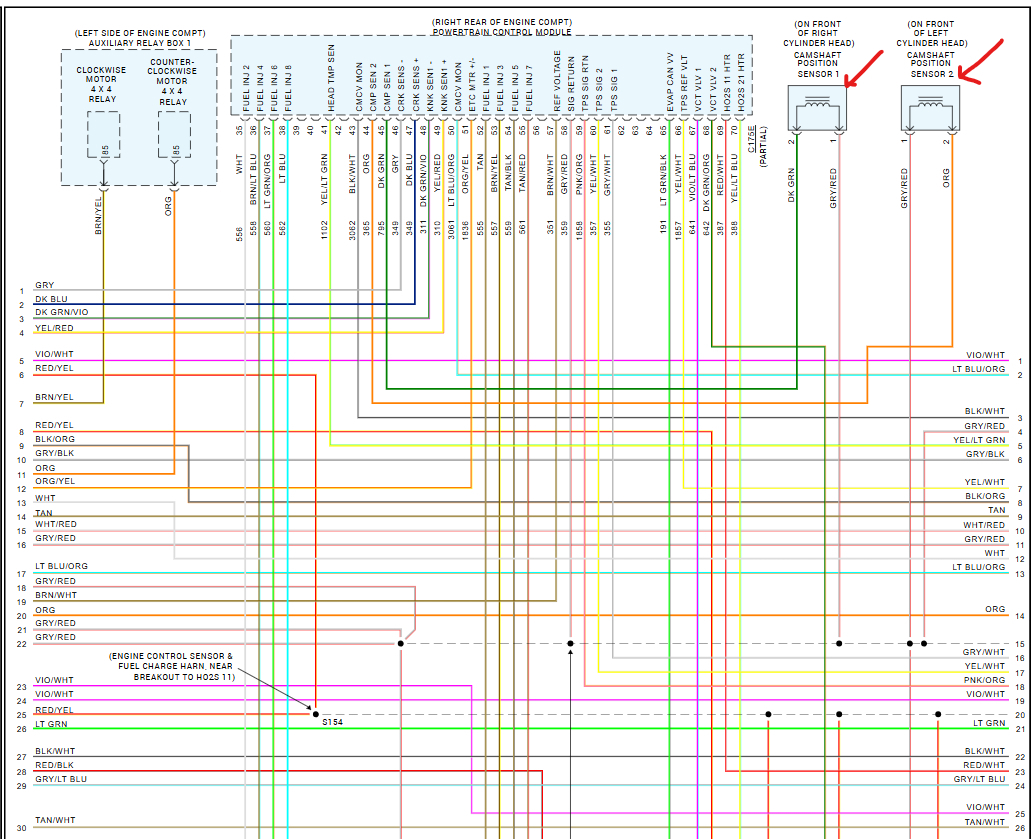

Sure we can take care of you, can I ask what the code number are? This might be a timing chain system issue. But in the meantime here is a guide to help you run some tests and the camshaft wiring diagrams so you can rule the wiring out or find the problem.
Check out the images (below). Let us know what you find.
