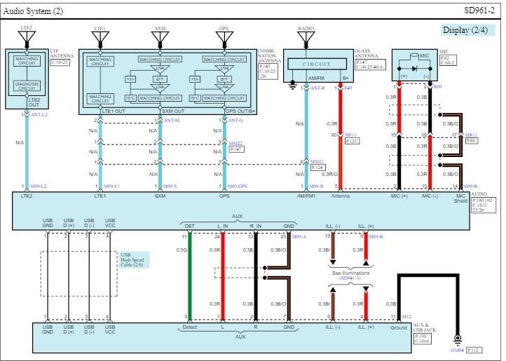

I was curious if you know of the wiring diagram for my car listed above? I saw that you were able to help a gentleman with a 2017 so I was hoping you could help me with my car it's a LX with screen and uvo and cruise no navigation or amps.
Thanks,
James
Apr 20, 2019 at 6:08 AM
  • 110,248 POSTS
Welcome to 2CarPros.

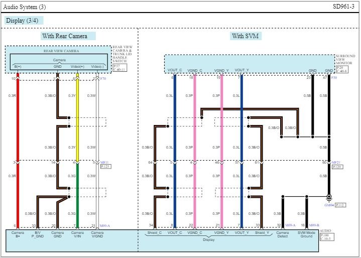

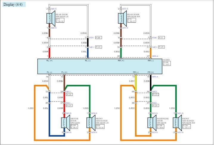

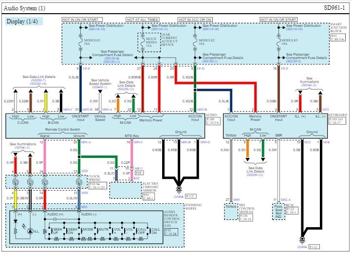

If you are looking for schematics of the audio system, I have attached everything related below. If there is something you can't read because of size, let me know.
Let me know if this helps.
