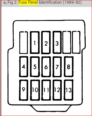

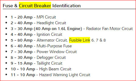

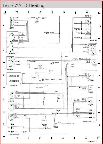

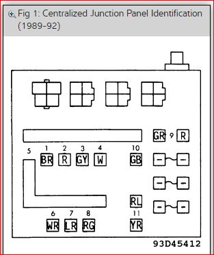

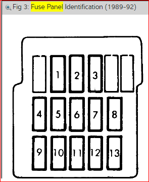

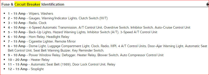

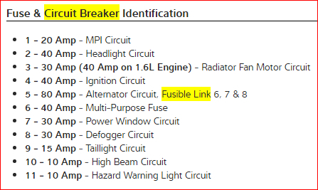

I want to ask if someone has a wiring diagram for my car listed above? And a fuse box diagram would be nice as well.
Sep 6, 2018 at 11:55 PM
DANNY L
  • 5,648 POSTS
Hello, I am Danny.
Just a quick question first. Is it the 1.5 or 1.6L? I can get you the Fuse Box diagram but what other wiring diagrams would you like? Anything specific or the whole car? Hope this helps and thanks for using 2CarPros.

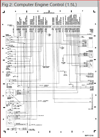

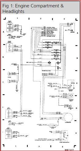

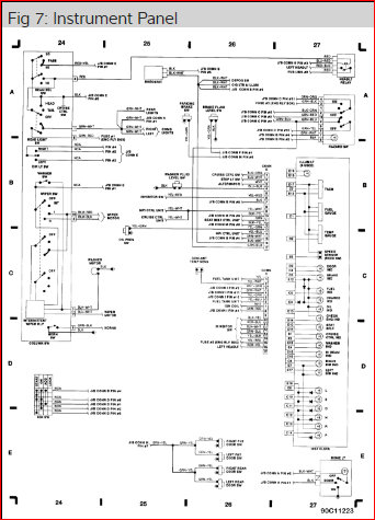

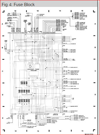

Hi Danny,

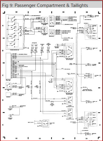

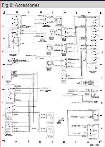

It is a 1.5L and I am looking for the headlight part of the wiring diagrams. But if you could provide the whole car that would be best.
Sep 8, 2018 at 12:02 AM
DANNY L
  • 5,648 POSTS
Hello again.

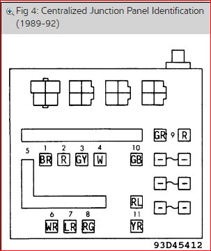

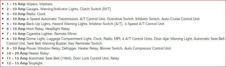

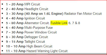

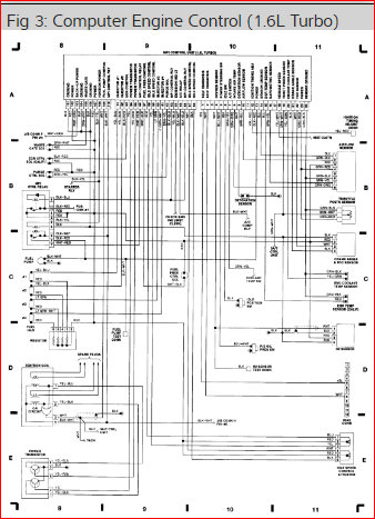

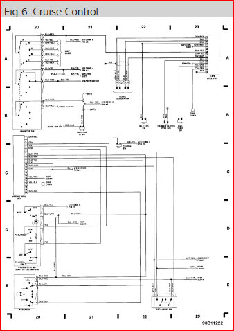

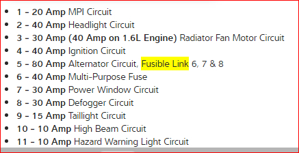

Here you go. I have attached seventeen pictures of the wiring diagrams and fuse boxes. Hope this helps and thanks again for using 2CarPros.

Thank you, this is very helpful.
