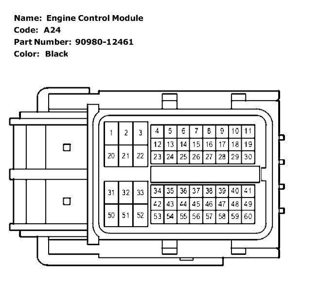

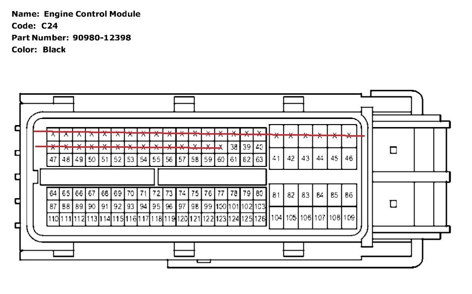

Wiring diagram needed for the 60pin ECU receiver?
2009 TOYOTA CAMRY
188,000 MILES • 2.4L • V6 • 2WD • AUTOMATIC
DAVIN DAZ DILLY FLORES
I need a wiring diagram for my 09 Camry le of the 60pin ECU receiver and it's functions due to the fact that after changing the wire harness the plug from harness to ECU wasn't a match. The120 pin plug matched but not the 60 pin.

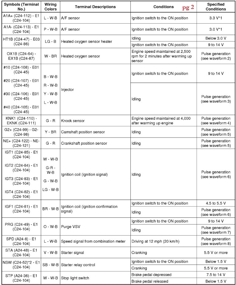

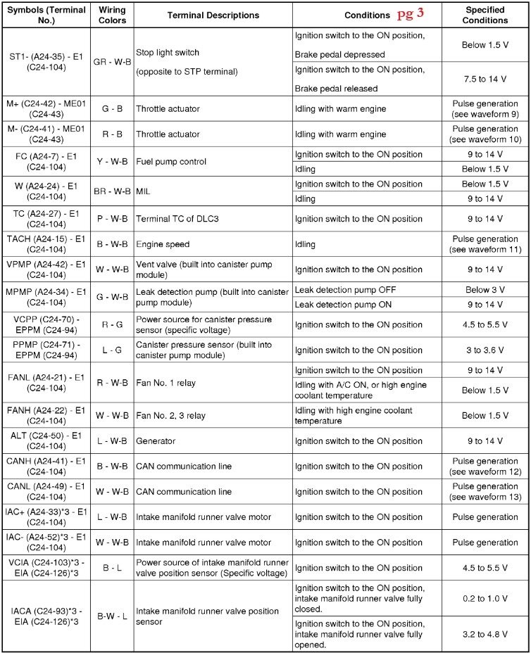

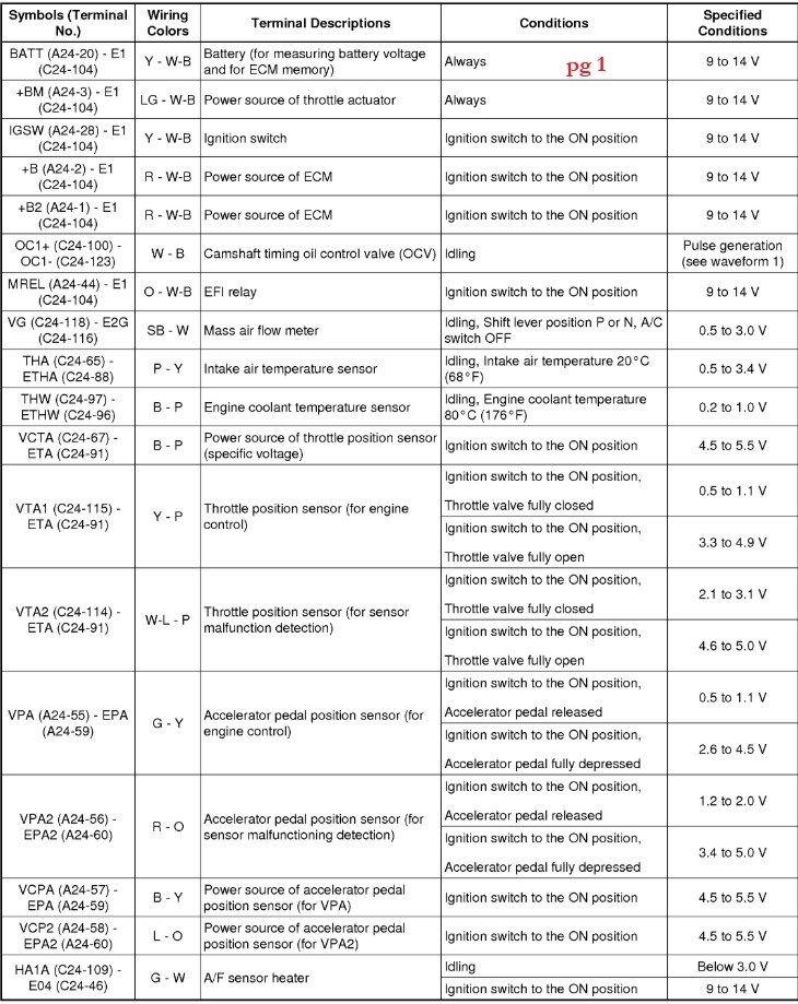

AL514
  • 5,639 POSTS

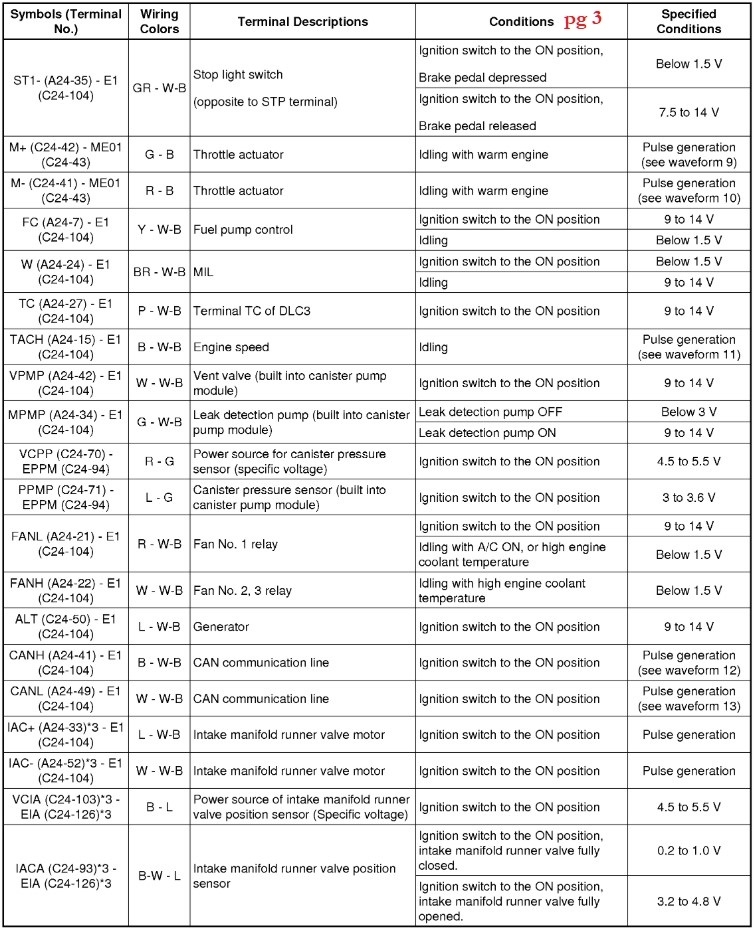

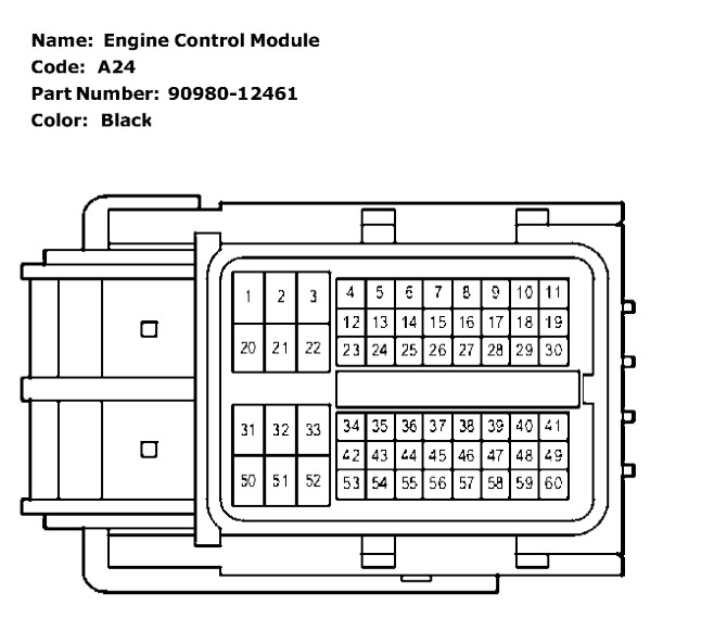

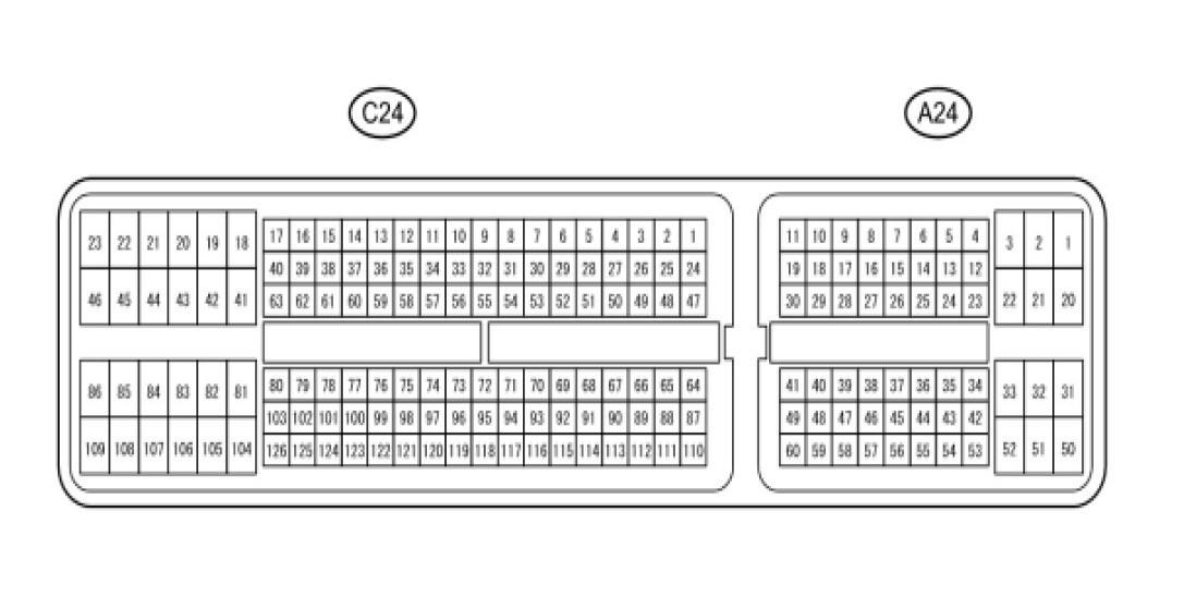

This is the ECM connector service info is showing, I will include the pinouts as well.
Apr 18, 2025 at 3:16 AM

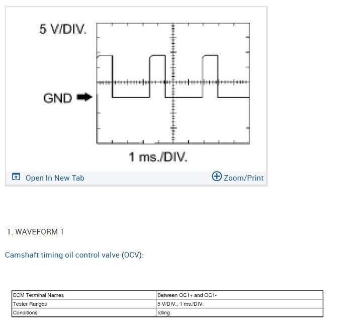

AL514
  • 5,639 POSTS
Diagrams 1-3 are the pinouts for the ECM connectors, and service info also includes some oscilloscope waveforms for sensors and actuators if that would be helpful, such as the one in diagram 4 for the camshaft timing oil control solenoid.
Apr 18, 2025 at 3:25 AM
AL514
  • 5,639 POSTS

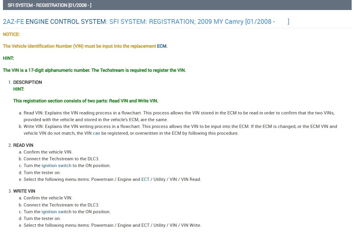

It looks like they include a front view of the connectors as well, along with programming instructions for the VIN into the ECM.
