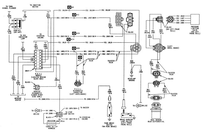

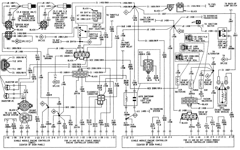

I am looking for complete wiring schematics for this truck. However, do not have extra money to purchase a repair manual.

Complete wiring diagram for 1989 Dodge W150, 318, manual, 4x4. Hillbilly's who owned it previously messed it all up.

There are too many diagrams to send for the complete truck can you give us particulars like engine?

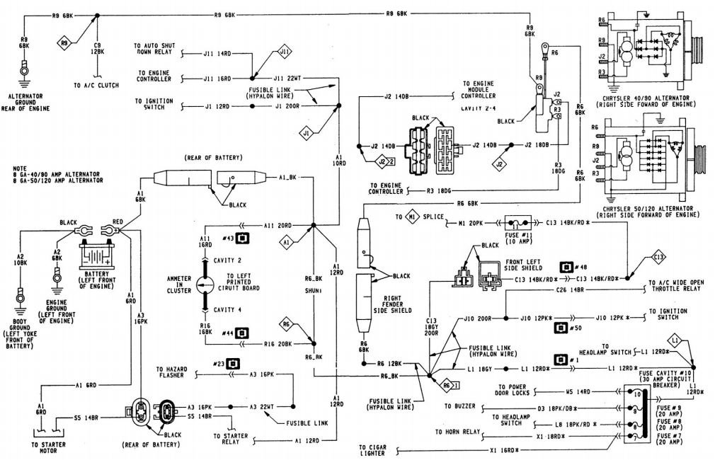

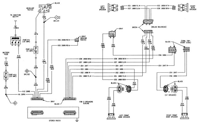

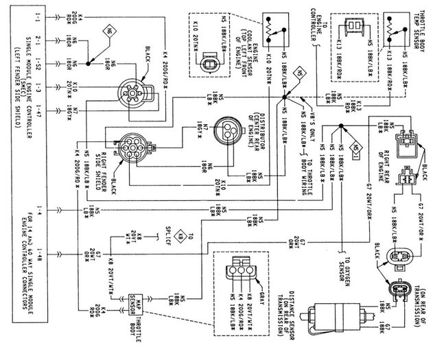

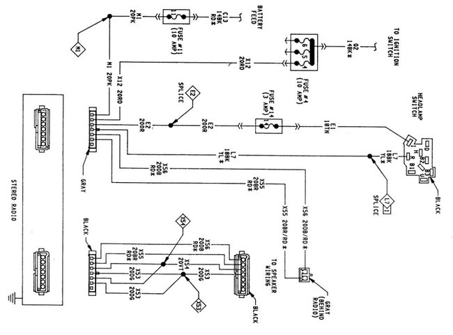

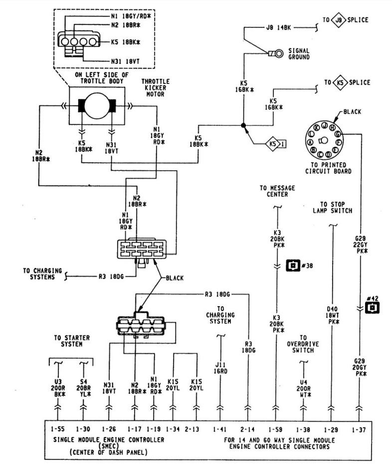

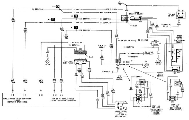

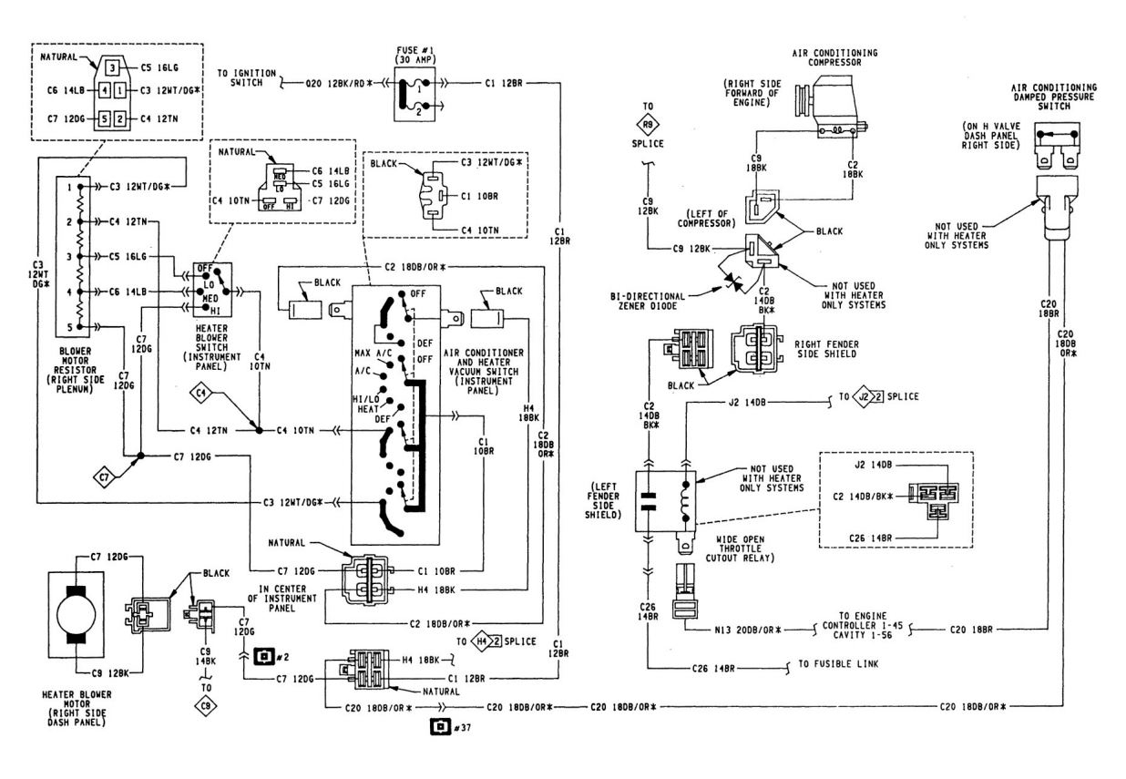

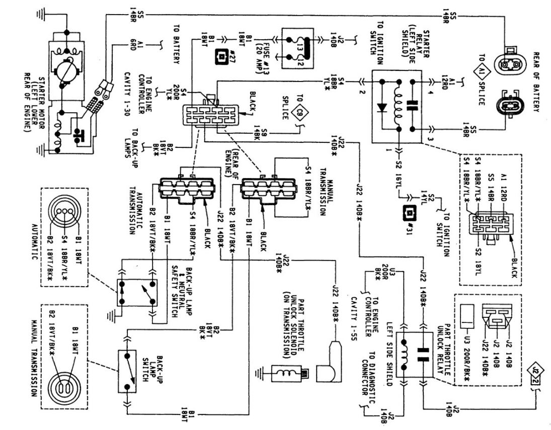

Try these. Just ignore the items that you do not have.

So the other day I was changing out the starter fuel pump relays, put in some new ones. Well, I accidentally put a third one in the thinking about it now, I have no fuel pump, no starter, no anything. Smell smoke burnt spot on the fender, but I cannot find the wire. Did I fry the ECM ECU out or something else? Thank you, I would appreciate it very quick responses and try to get this thing on the road.

It sounds like it, I would go over all the engine computer wiring before plugging in a different one.
