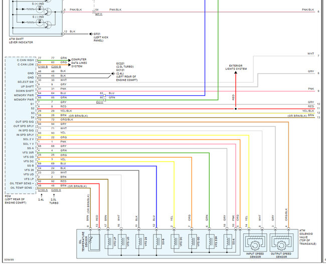

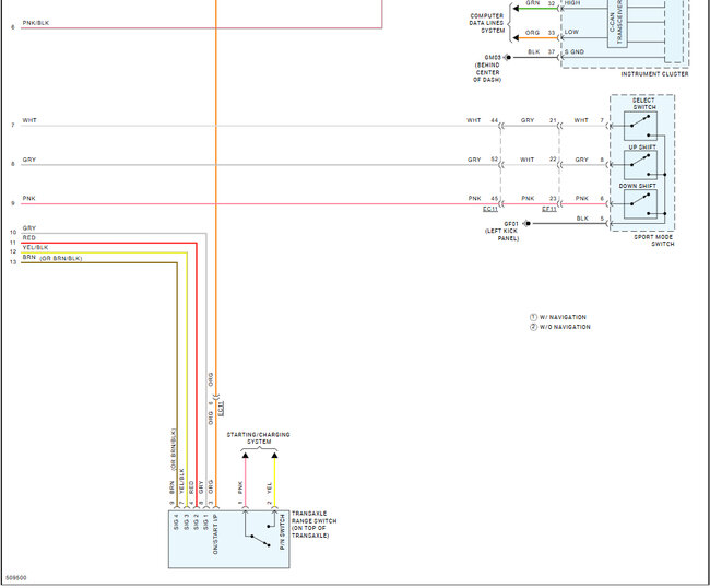

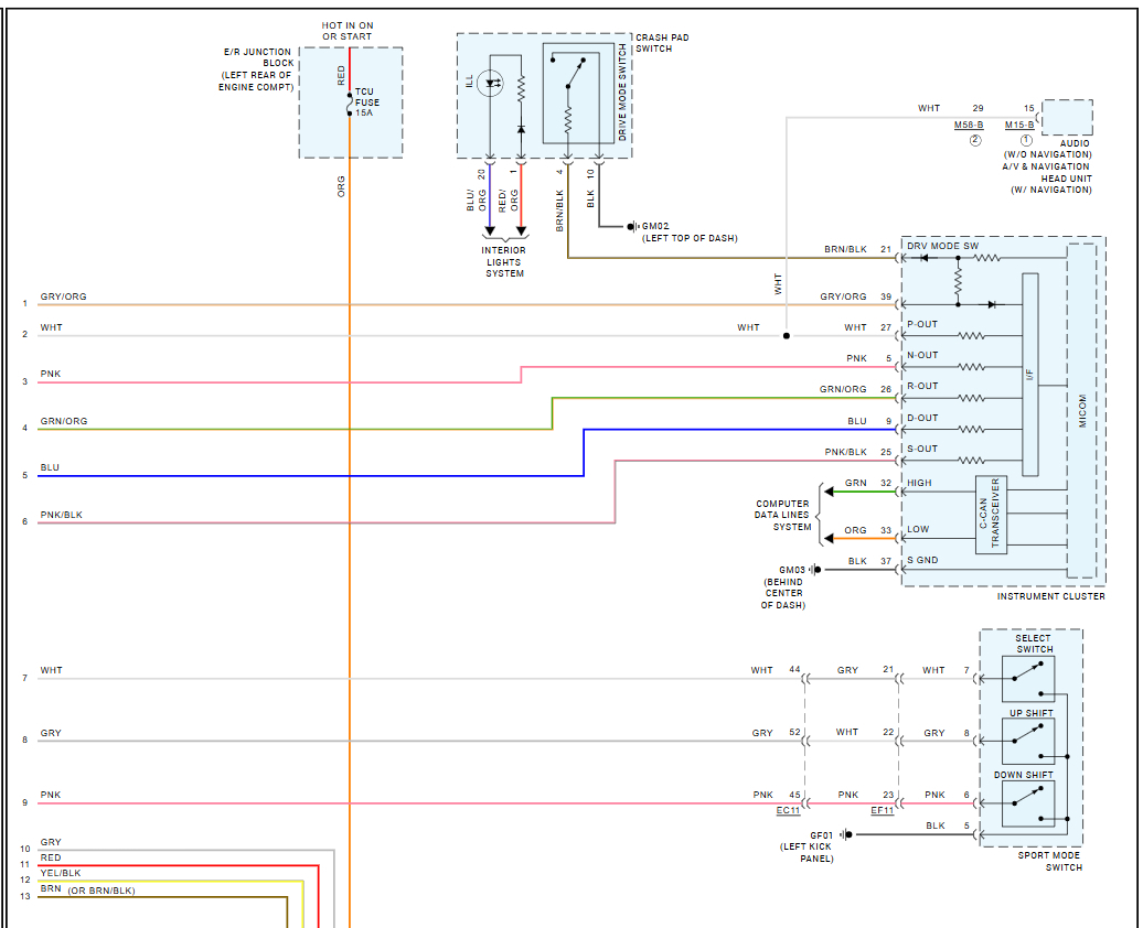

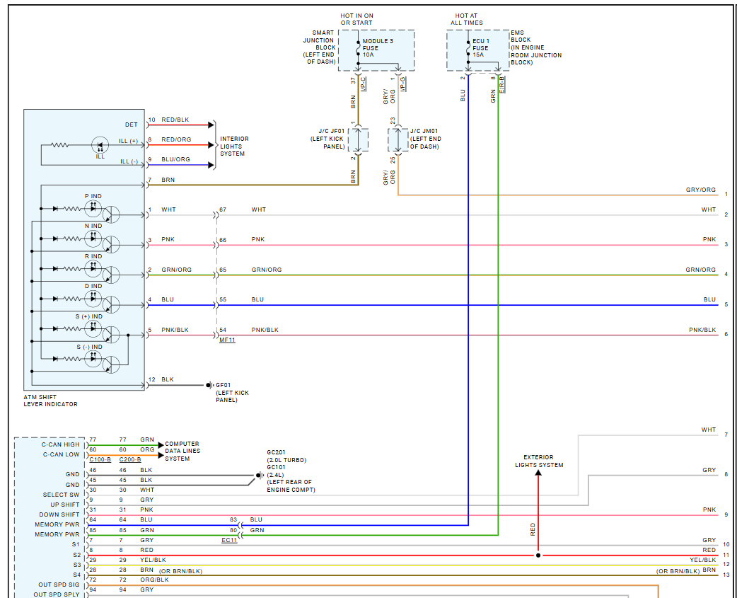

please need Diagram for transmission connector and the pinout for transmission switch range sensor. Thanks!
Jun 28, 2025 at 7:37 AM
  • 55,770 POSTS
They don't give us the pi outs bad here is the wiring daigrams for the transmission which include the range sensor. Check out the images (below). Let us know if you need anything else.
