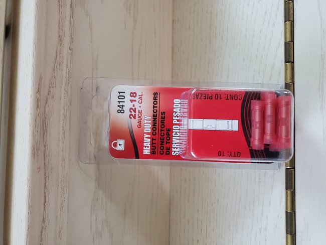

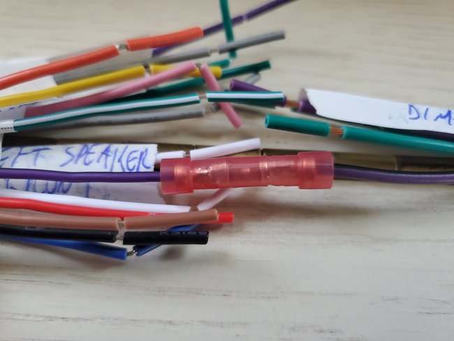

I just purchased the butt connectors with solder in the center. Since I had previously purchased butt connectors, I made one connection which is not tight so I wanted to shrink that with 'Teflon' sleeve and do the rest with the butt connectors with the solder in the center.
Jul 8, 2020 at 11:12 PM
Why the Teflon?
Can you post some pictures of the ones you have?

I would not use the first ones at all. They are not good connectors.
Solder and shrink wrap are the best way to join the wires.
