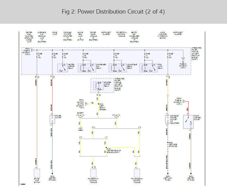

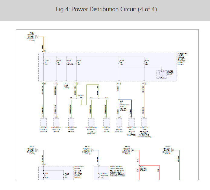

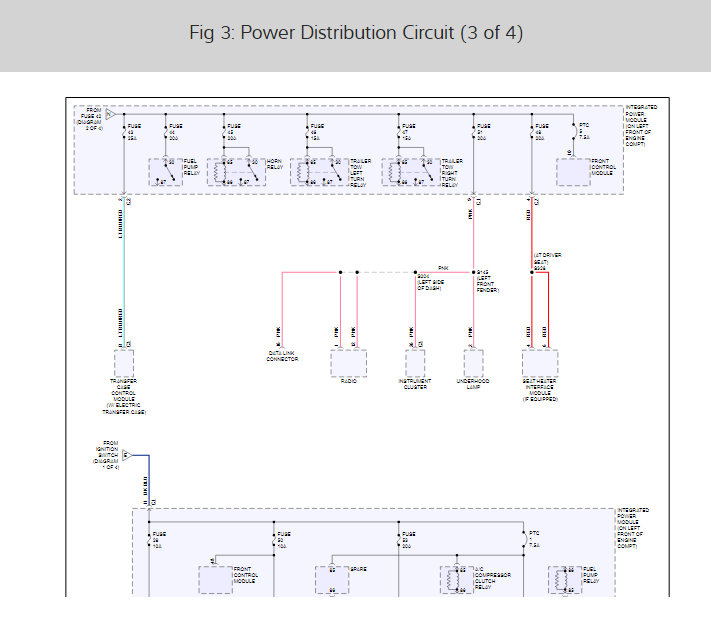

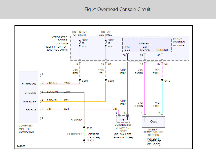

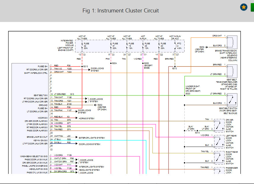

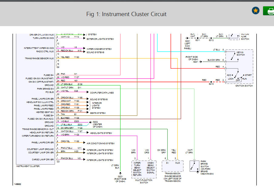

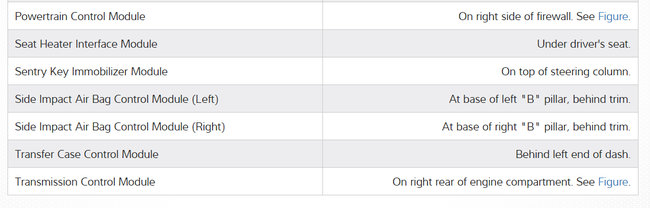

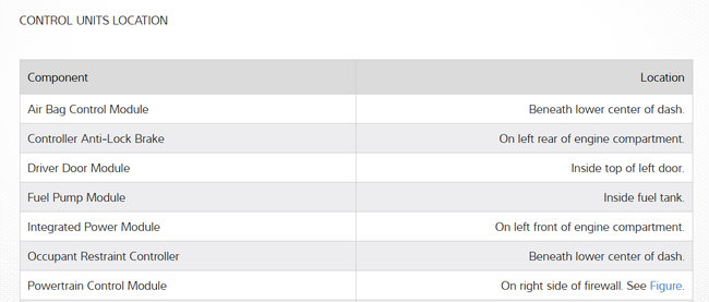

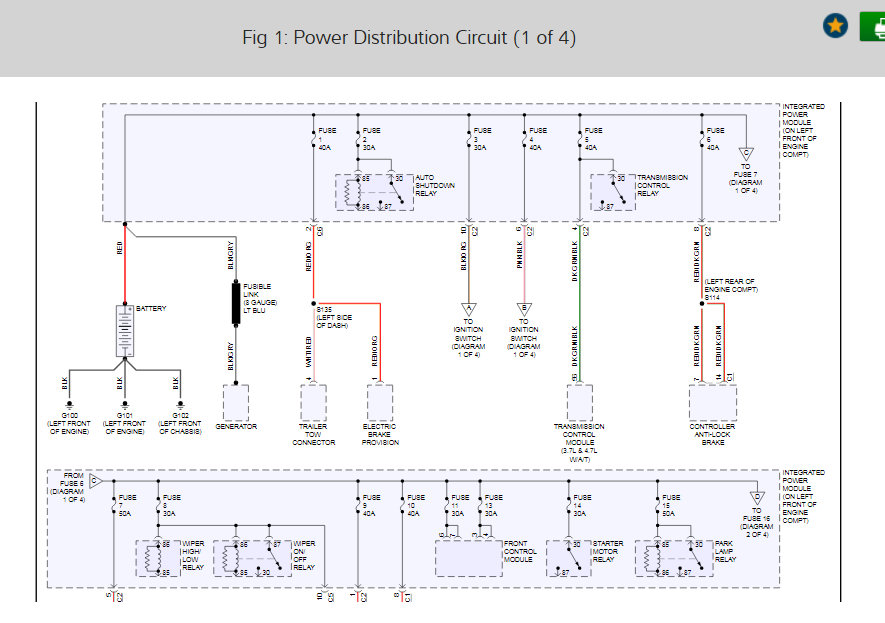

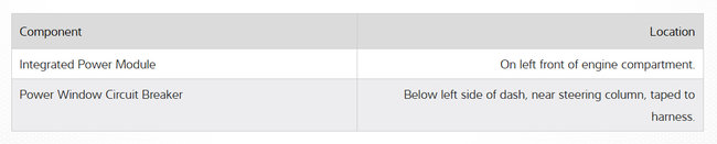

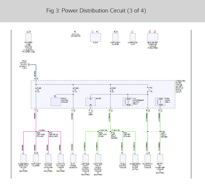

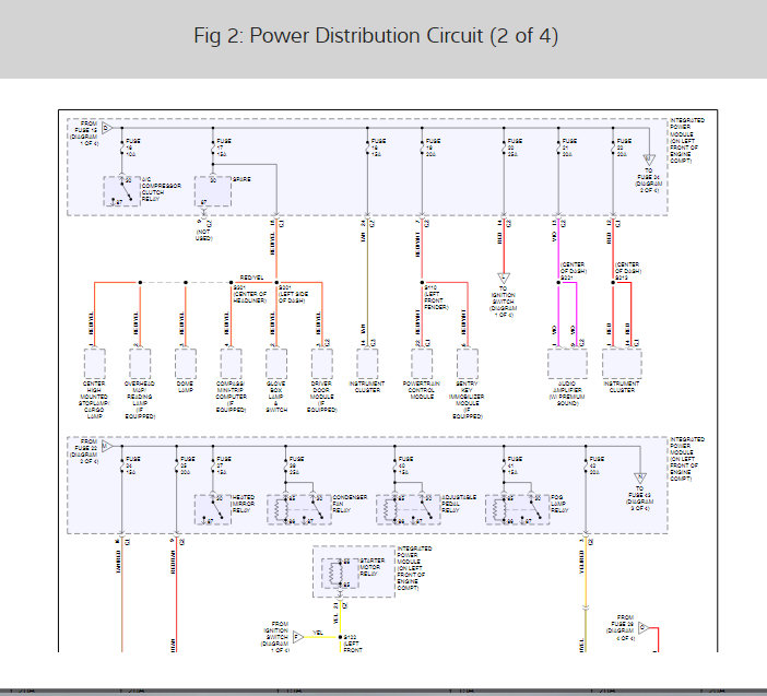

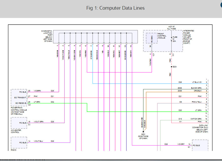

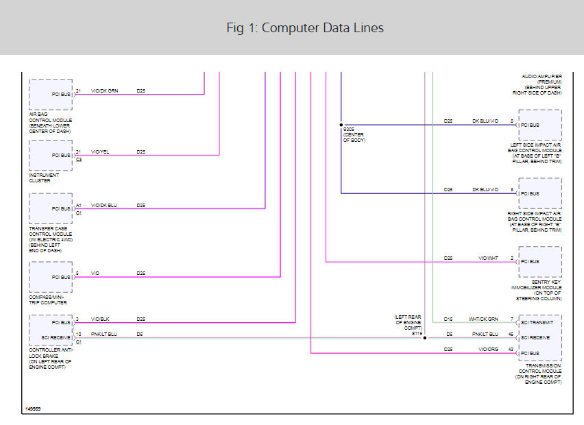

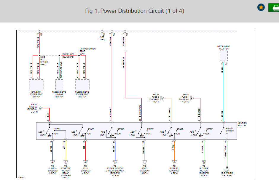

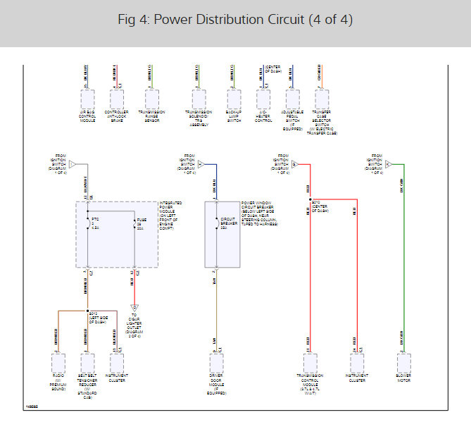

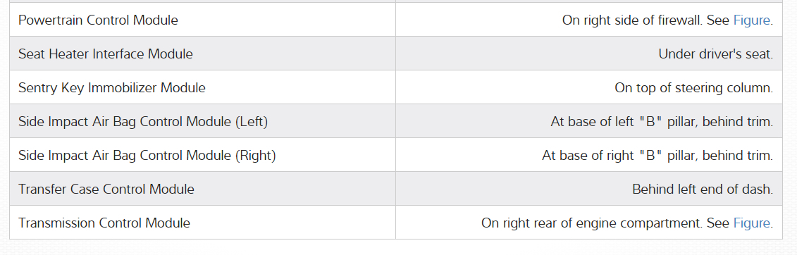

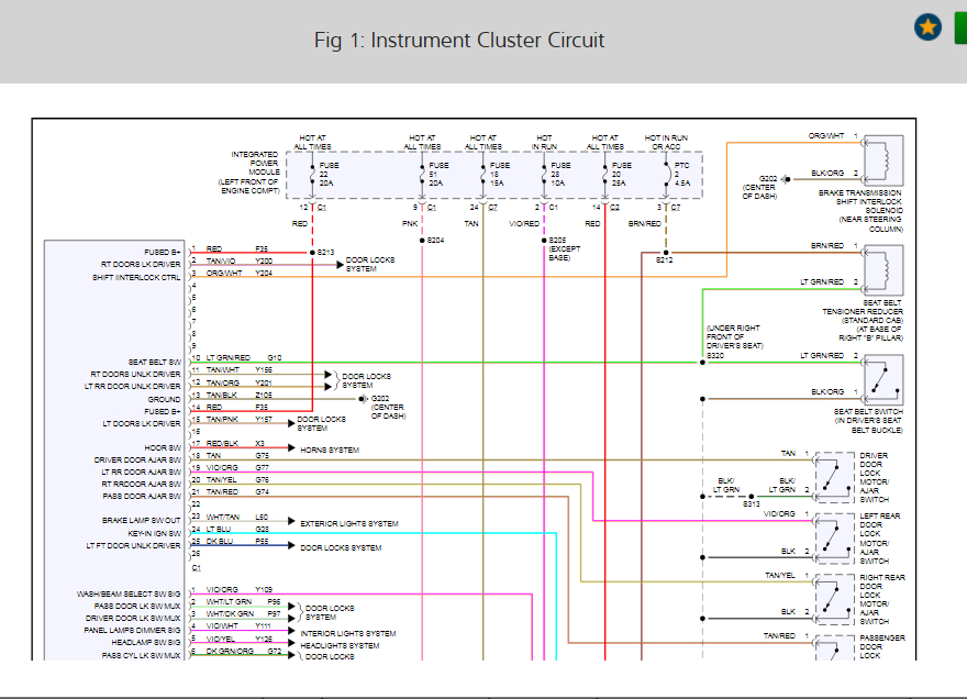

Hi, I am looking for the color codes for the BUS and the other wiring from the computers to the dash and fuse block. Also am looking for where the modules are in the My truck listed above is a 1500 SLT.
Aug 2, 2019 at 12:37 AM
SCGRANTURISMO
  • 4,897 POSTS
I have included all the information that you have requested in the diagrams down below. Please go through these wiring diagrams and component locations and let us know if you need anything else. That's why we are here.
Thanks,
Alex

Hi Ken, It is looking like a broken wire somewhere. Will update when I find it.
Sep 12, 2019 at 5:00 AM
ALTASNOWMAN
  • 39 POSTS
Hi Alex, thanks for the wiring diagrams. They will be a great help when I start tracing the bad wire.
Sep 12, 2019 at 5:12 AM
  • 55,214 POSTS
This guide should help:
Sep 13, 2019 at 3:16 AM
ALTASNOWMAN
  • 39 POSTS

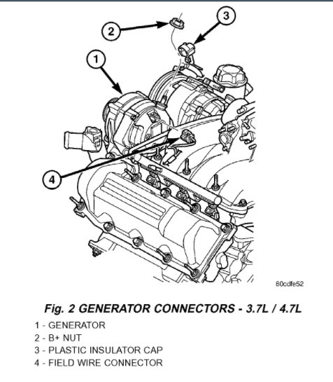

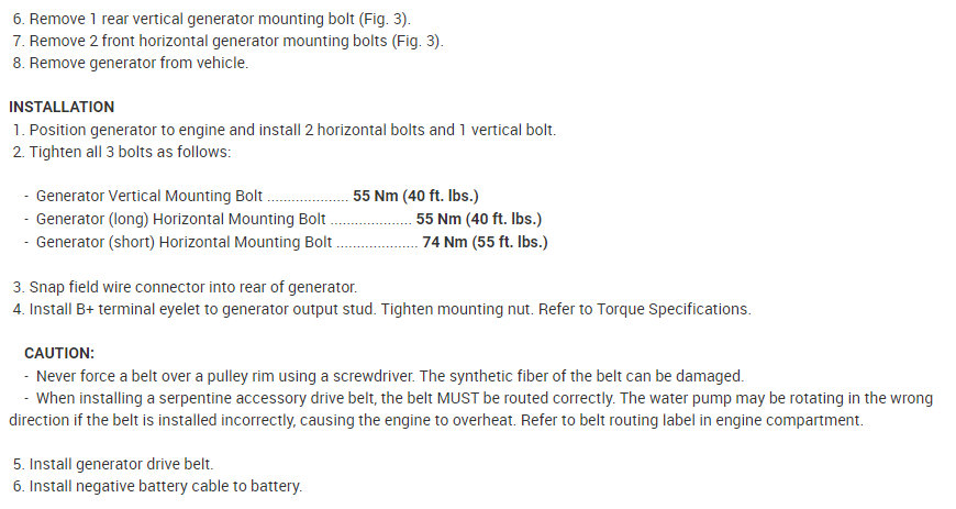

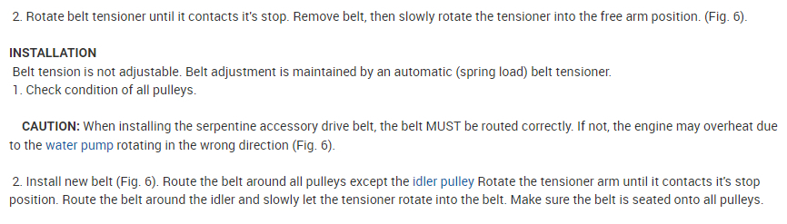

when I did some testing fuse #23 was pulled and all dash and Inst came back but now no remote starter,doorlocks and a few others. Sorry it took so long as truck quit on me and I think the alternator went. Will update soon.
Jul 29, 2021 at 9:01 PM
DANNY L
  • 5,648 POSTS
Hello, I'm Danny.

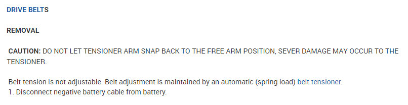

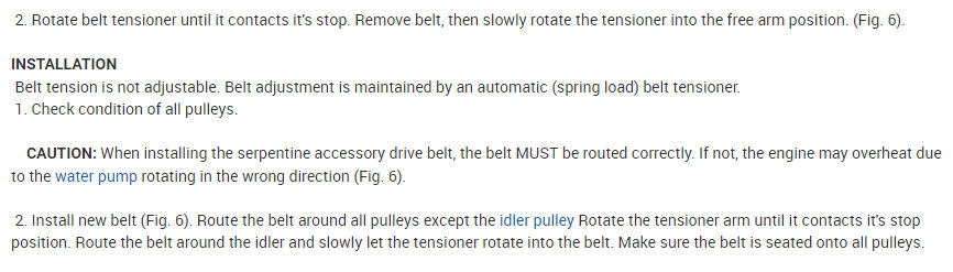

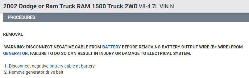

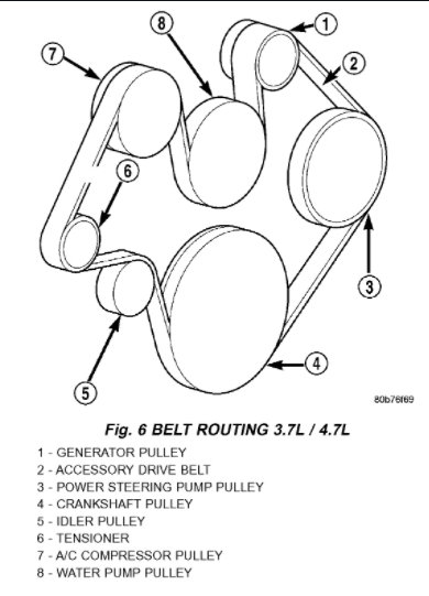

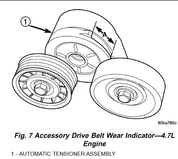

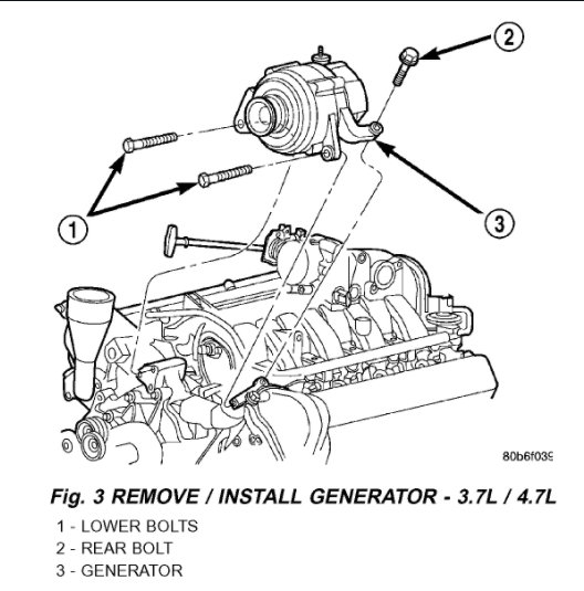

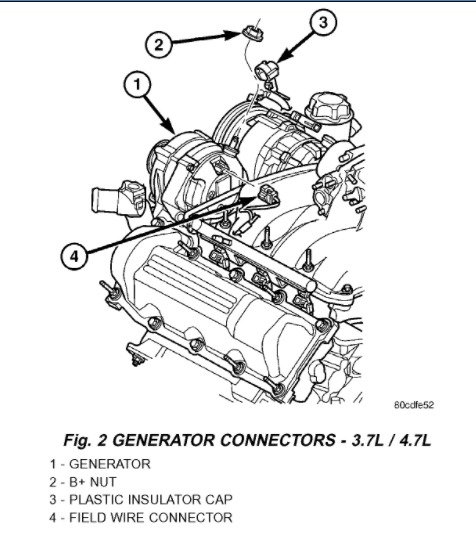

Let us know if you need any additional wiring diagrams as we're still here to help. Here are a few tutorials showing how to remove the serpentine belt and alternator you mentioned that may have failed:
https://www.2carpros.com/articles/how-to-replace-an-alternator
Most local auto parts stores will test an alternator for free. I've attached picture steps below on how to remove and replace the serpentine belt and alternator on your truck. Keep us updated. Hope this helps and thanks again for using 2CarPros.
