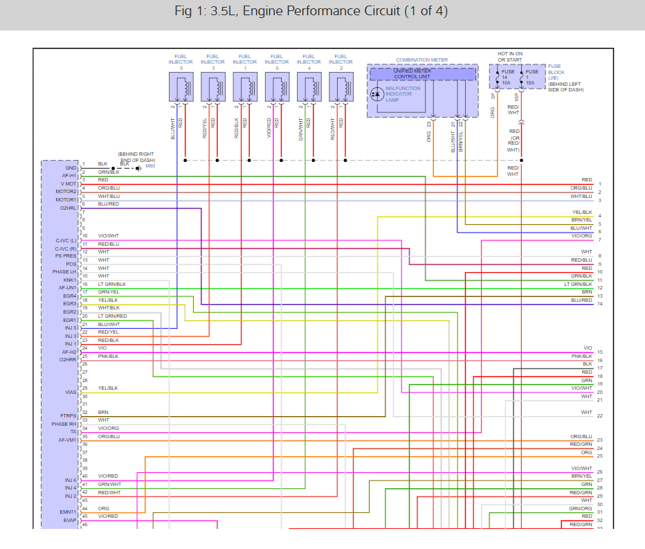

I found a wire that runs with purple wire, and it is ripped out. It is white with black stripe. What does it go to?

Can you tell us a little more detail of where the wire is located?
Also do you have any components that are not functional.
There are extensive wiring schematics for all the different components, and we will need to narrow down the search to figure out what this might go to.

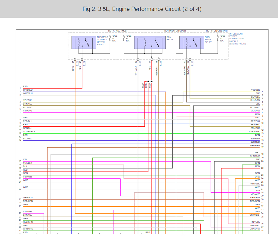

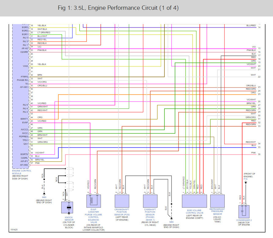

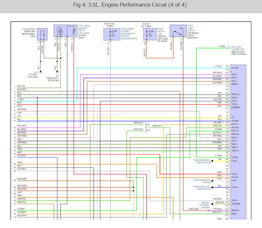

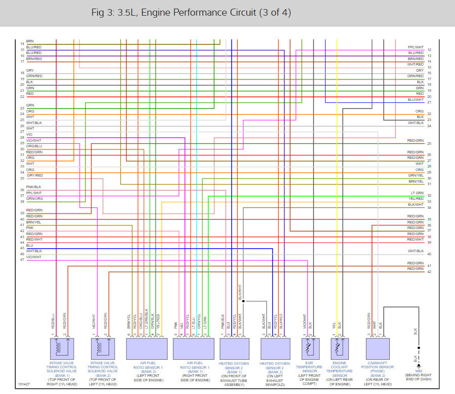

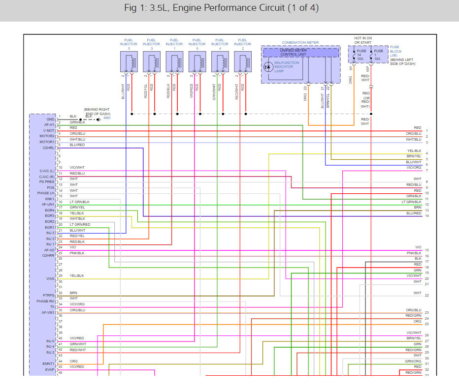

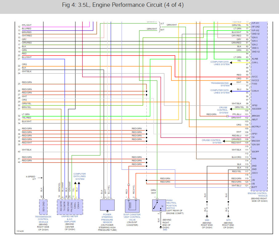

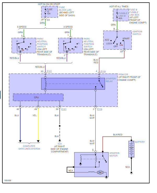

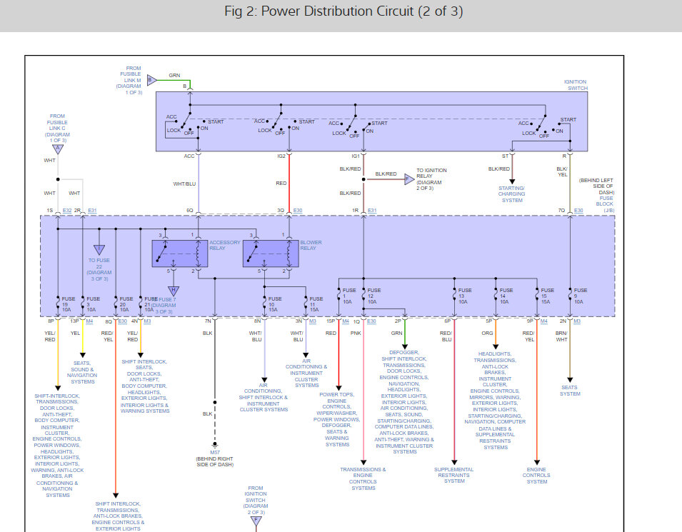

Replaced some of the wires on the back of my ignition switch harness and now I can't get it to turn over or the radio to come on. I've checked all fuses they are good. I've got a wire in the wrong spot. Please help me. I've asked this question before and never got a response. I need to know what color wire the acc and the starter and ignition are. I have six wires.
Oct 7, 2022 at 4:11 AM (Merged)
  • 55,694 POSTS
Okay, here is a guide to help you test the connections and the starter and engine wiring diagrams in the images below:
Check out the images (below). Please let us know if you need anything else to get the problem fixed.

I need the location of the wires and the color for the pin connector harness for the back of the ignition switch. I can't get the wires in the right spot for everything to work, especially my radio has no power after the replacing of the wires in the harness clip for ignition switch.

Yep, here are the ignition switch wiring diagrams in the images below. Please let us know if you need anything else to get the problem fixed.
