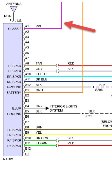

I need to know the color and what it stands for coming out of the harness. for a 2001 Chevy Cavalier
Jan 9, 2016 at 10:52 PM
CJ MEDEVAC
  • 11,000 POSTS
NEED ENGINE SIZE/ SUBMODEL/ WITH OR WITHOUT AMPLIFIER
THE MEDIC
Jan 10, 2016 at 12:11 AM
HMAC300
  • 48,601 POSTS
you can make things easier on yourself by buying an adapter...... ppl wire is form bcm and MUST be connected correctly
Jan 10, 2016 at 12:12 AM
WRENCHTECH
  • 20,760 POSTS
I really hope you haven't cut this harness. You really don't want to do that. There are numerous complicated and sensitive circuits involved there and you can do a lot of damage to systems in the car. They make plug and play adapter harnesses that should be the only thing used for aftermarket radios. https://www.2carpros.com/images/external/86274564.jpg.gif
