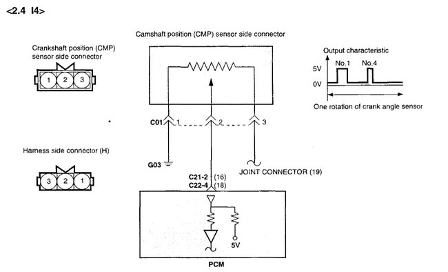

The following color are: black , orange, and blue. I need to know the order they go in on the new pigtail; 1, 2, and 3. Can you tell me the order please? thank you

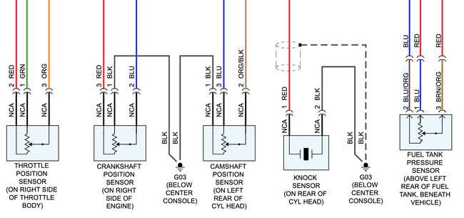

I have attached the wiring diagram which shows the colours and pins.
Hope that helps, let me know if you need any clarification. Check out the images (below). Please let us know what happens.

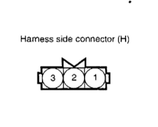

My cam is up front on the driver side. the three colors are black, orange and blue. there is no numbers on the new pigtail.

You are replacing the connector on the harness side right?

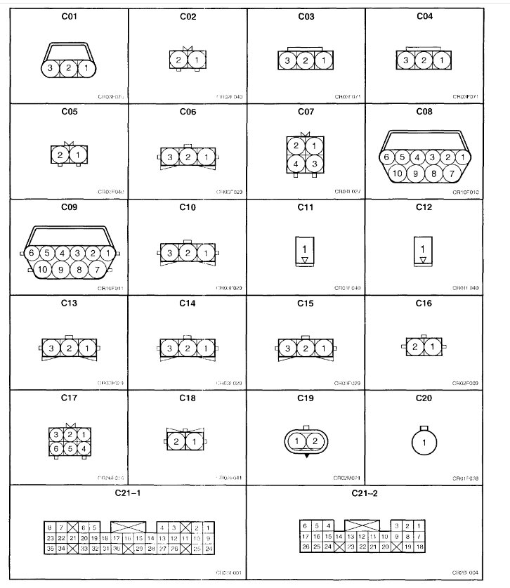

There may not be numbers on the pigtail but as you can see on the second diagram it shows the harness side that you are replacing with the pigtail. On the picture of the harness side connector you can tell the pin numbers by the latch on the connector and its orientation. I have cut just the bit you need below.
From the wiring diagram -
pin 1 is black
pin 2 is orange/black (orange with a black trace)
pin 3 is blue
Hope that helps, let me know if that still isn't clear and i'll try and word it another way.
