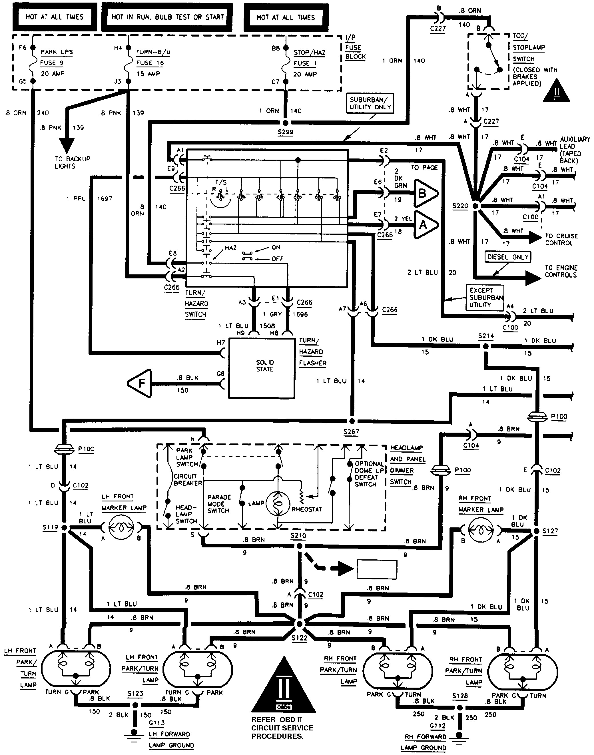

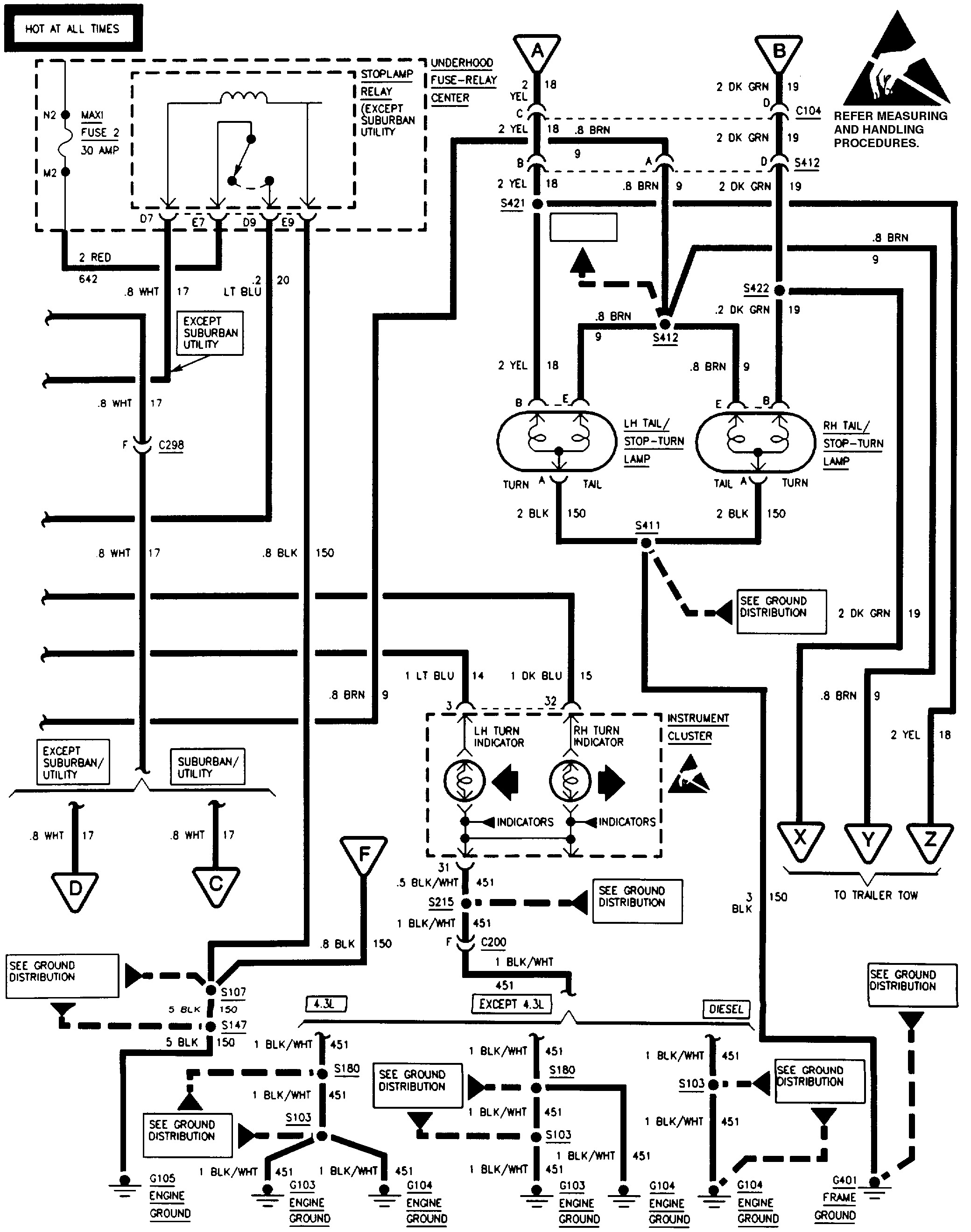

turn signals I need wiring diagrams

These are the OE diagrams for the exterior lights on that truck. What is the issue you have?
