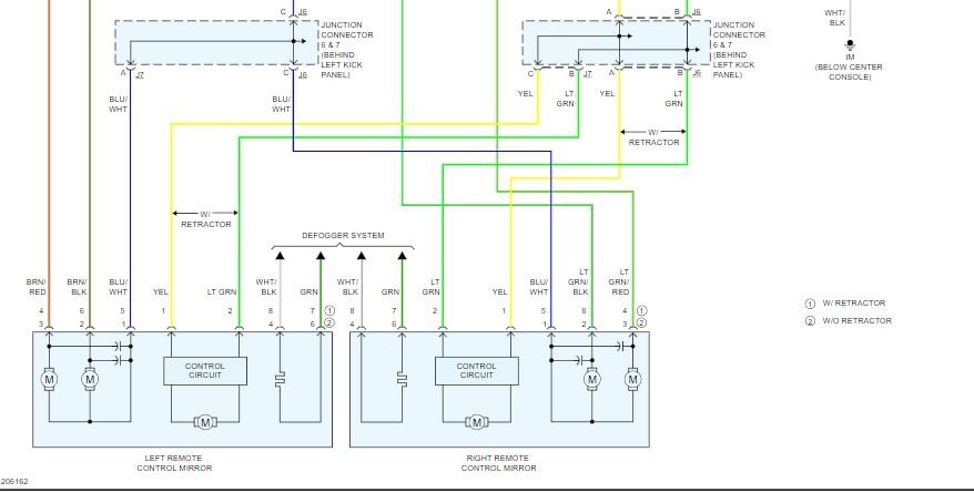

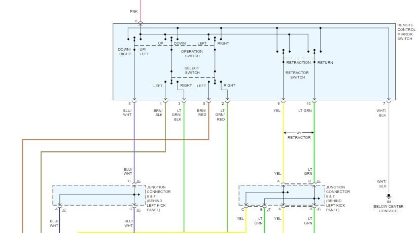

Wiring colors at the switch to control the mirrors
199,600 MILES • 4.7L • V8 • 2WD • AUTOMATIC
NICKBAR87
  • 30 POSTS
If possible I would like to know the wire colors on the pigtail for the plug going to the side view mirrors. I have the mirrors that fold in and are not heated. Thanks
Feb 9, 2019 at 11:07 AM
NICKBAR87
  • 30 POSTS
Sorry, I meant to add that I'm looking for the colors at the switch to control the mirrors.
Feb 9, 2019 at 11:10 AM
  • 110,251 POSTS
I have attached the schematic for the mirrors. I had to break the schematic into two parts because of size. I did, however, overlap them so you can follow it.
The schematic is for both folding and non folding mirrors.
Let me know if this is what you needed or if you have other questions.
