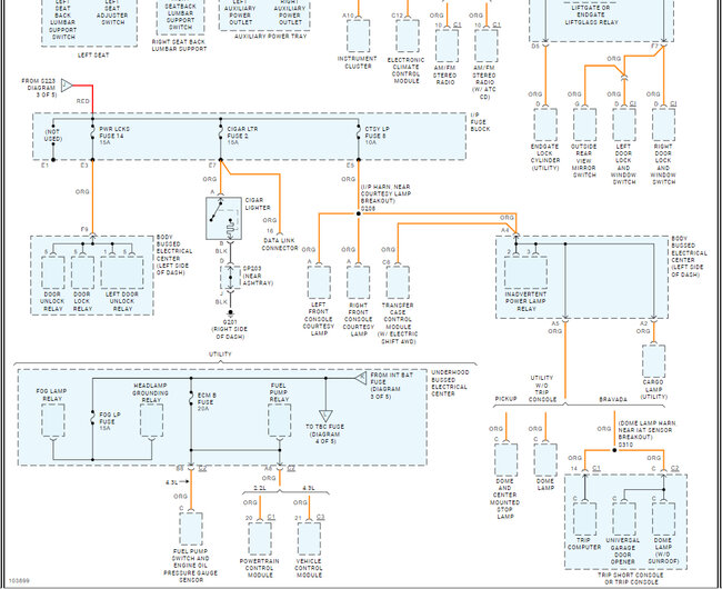

need computer and fuse block pinouts and harness pinouts for computer?

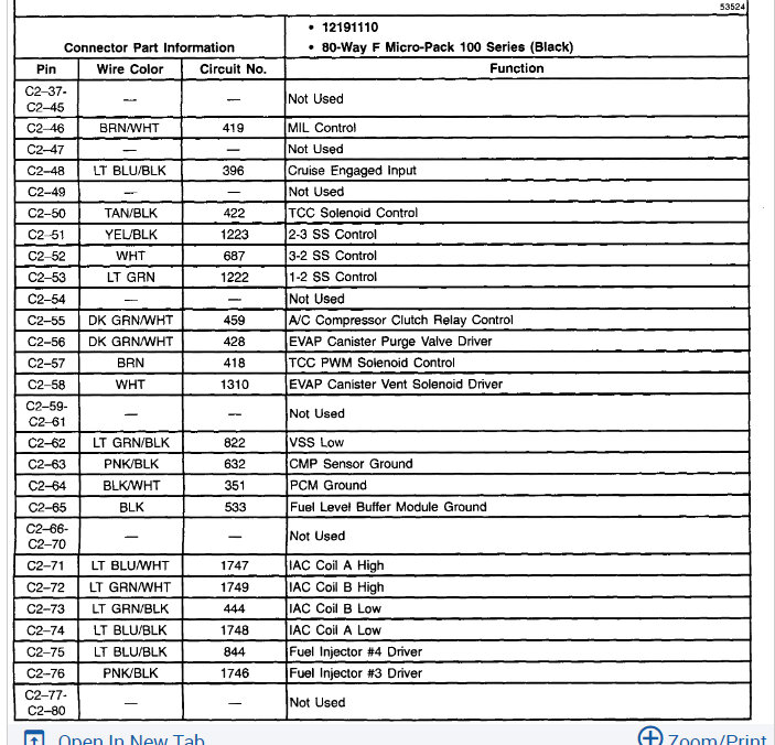

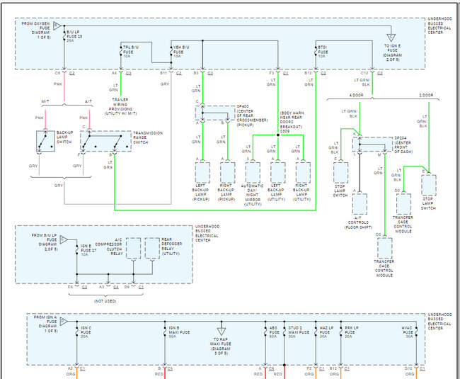

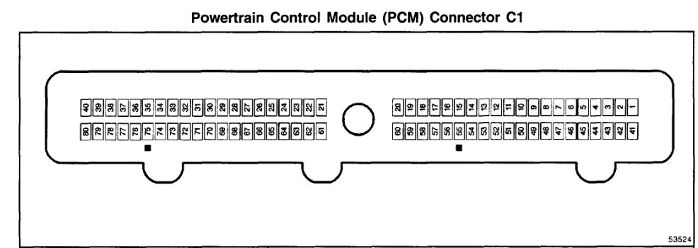

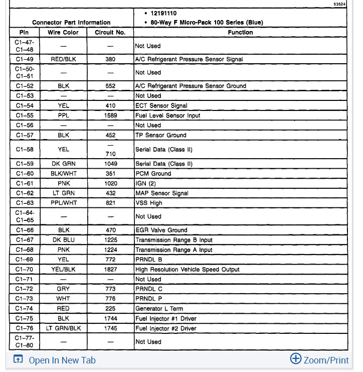

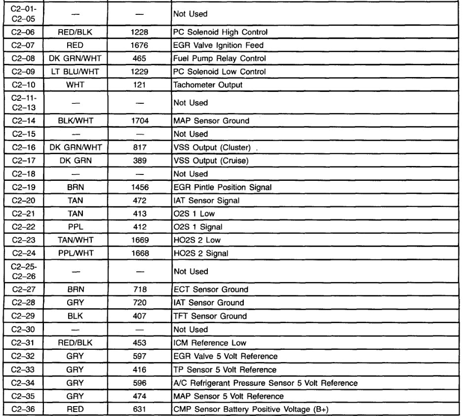

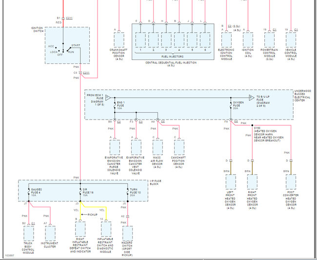

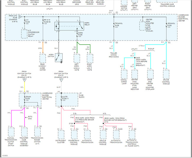

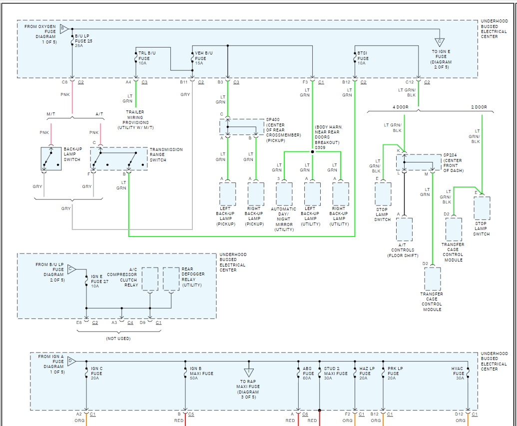

The wiring harness fried have a doner harness from a 2001 s10 2.2 and need computer and fuse block pinouts and harness pinouts for computer, please. any help is great.

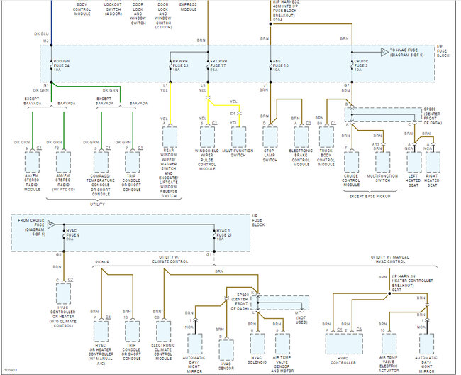

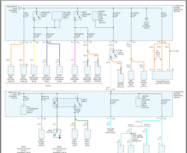

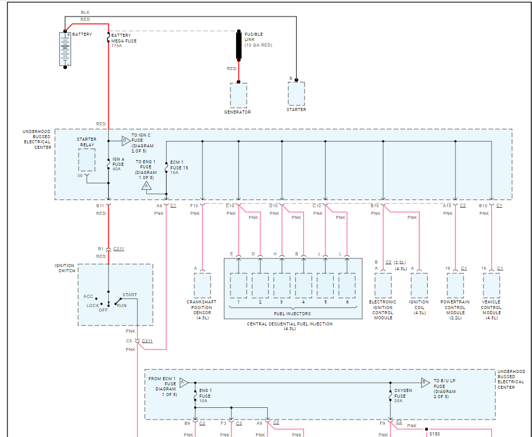

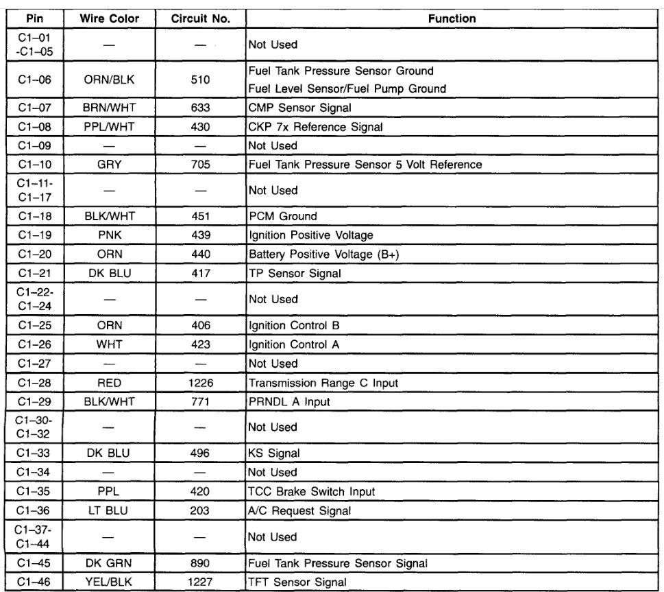

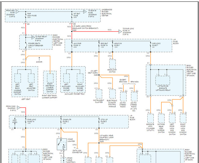

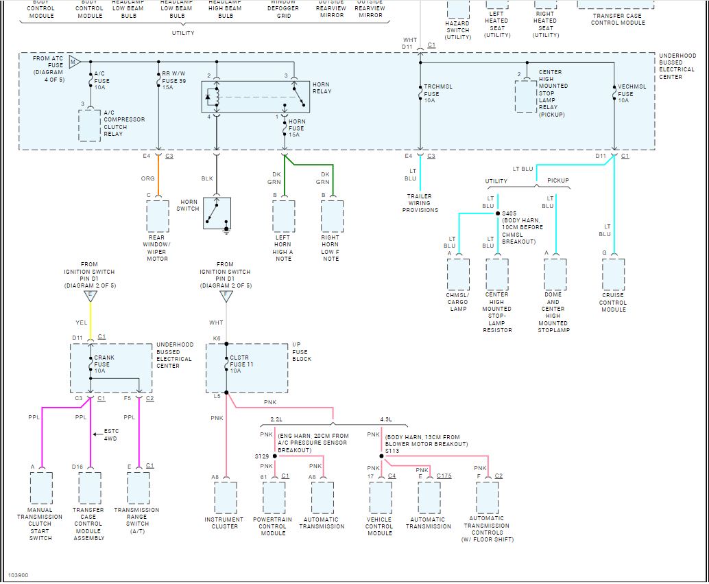

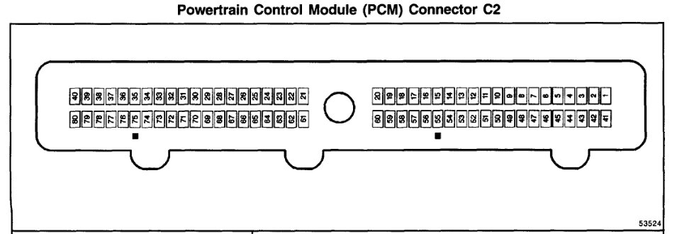

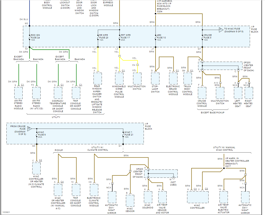

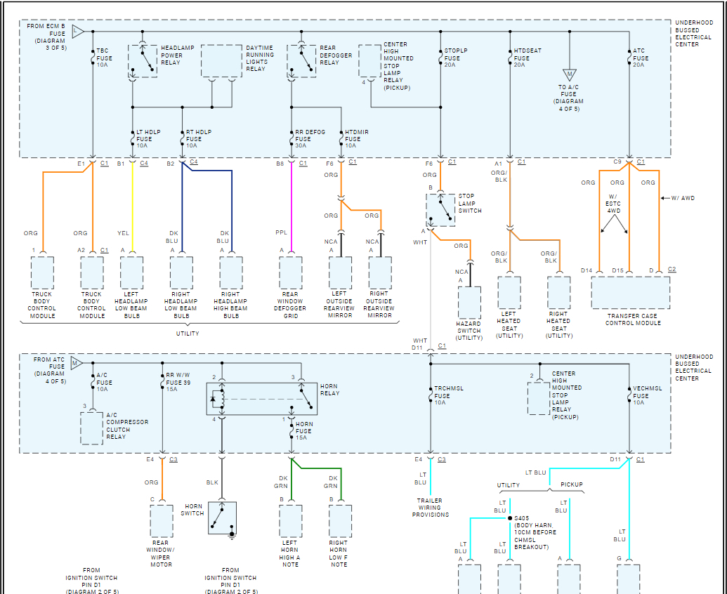

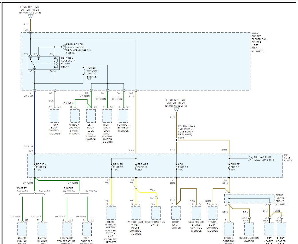

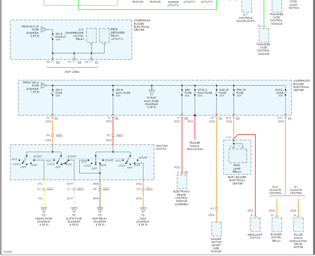

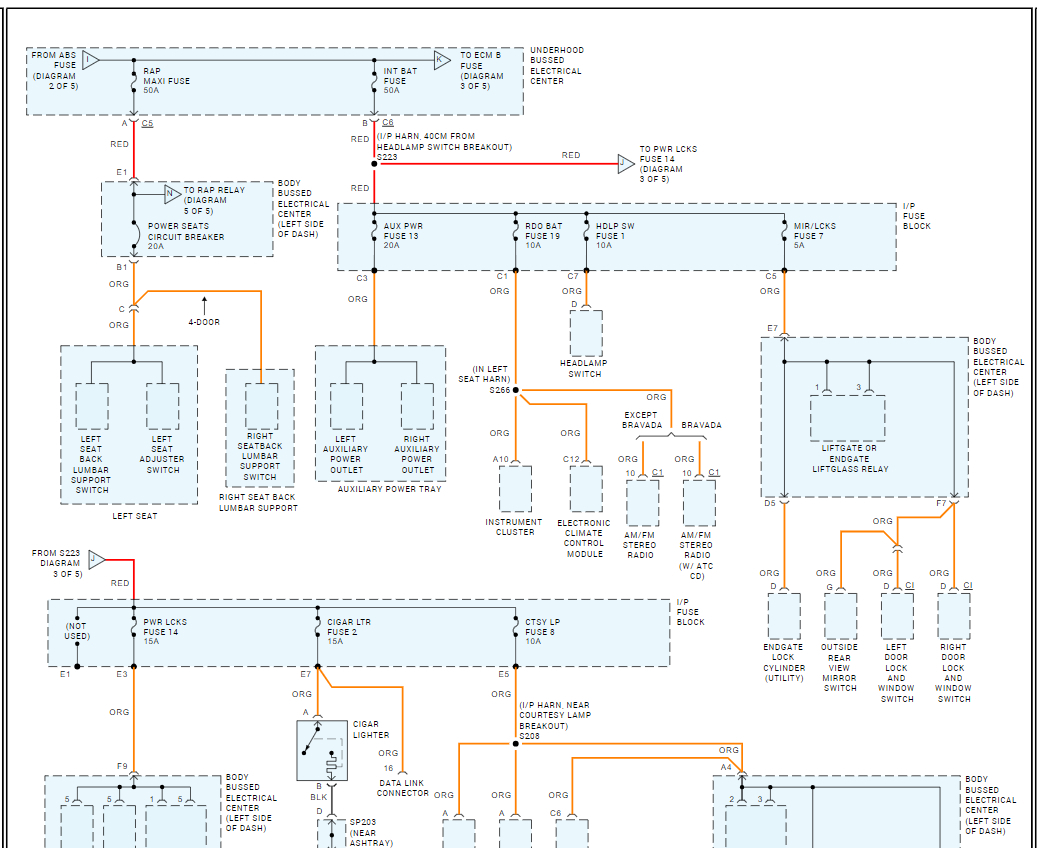

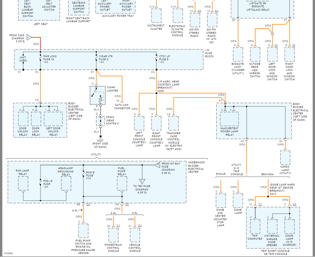

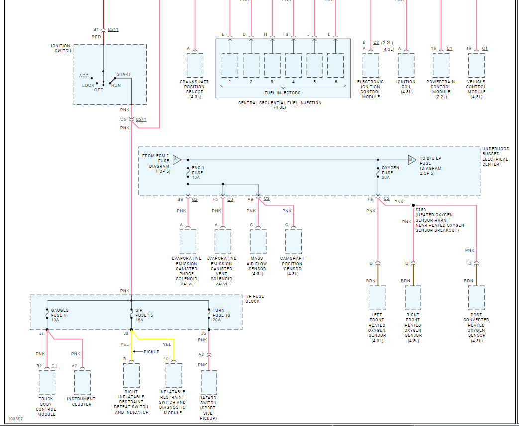

Here are the engine PCM connector views for the C1 and C2 pinouts. They don't have pinouts for the fuse panel, but I did include the power distribution wiring diagrams which can act like pin outs and show you how the system works. Check out the images (below). Let us know if you need anything else.

Hey, i appreciate your reply! Are the pictures for the 98 harness or the 2001? I need both to be able to merge the harnesses. thanks in advance.
Aug 23, 2024 at 4:35 AM
  • 55,224 POSTS
This post is for the 1998 CHEVROLET S-10
Aug 23, 2024 at 6:21 AM
