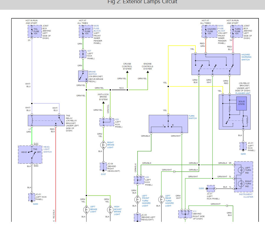

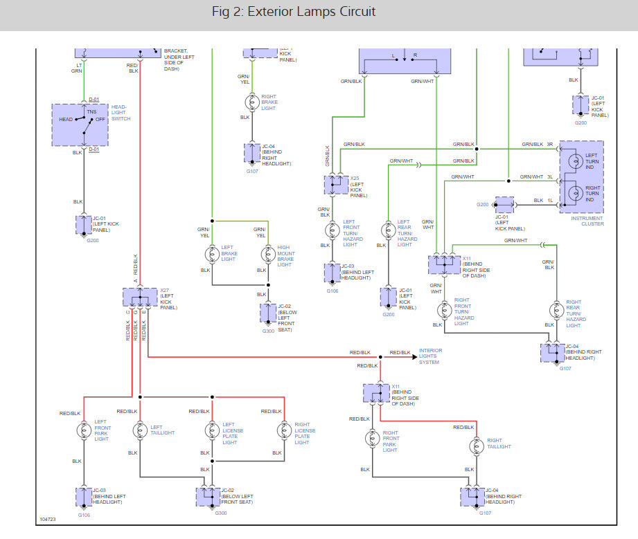

My brake lights no longer come on and it's because of the wires under the dash. I'm just not sure which wire it is. Also, the parking lights don't come on for the same reason.
Oct 18, 2022 at 11:53 PM
  • 55,711 POSTS
Here is a guide to help you check the wiring and the brake light and running light wiring diagrams so you can see how they work and which wires to test.
Check out the images (below). Please let us know if you need anything else to get the problem fixed.
