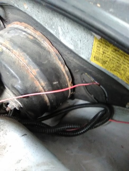

I did a tune up. After putting it back together I noticed a red wire from the firewall by the master brake cylinder hanging. I don't know where it connects to. Now when I start my car I put it in park and it stalls on me. Does this wire have something to do with that?

Chances are that wire doesn't. However, what you explained doesn't make sense either. LOL It only stalls in park? Are you able to keep the engine running if you touch the throttle when it's in park? When it's placed in neutral or any other gear, does the engine continue to run?
As far as the wire, take a test light and check to see if there is power to it. If there is, use electrical tape to insulate it until we determine where it goes. Also, if possible take a pic of it so I can see where it's coming from. Hopefully I will be able to identify it. One last thing. If you can, video with your phone what is happening so I can see and hear it.

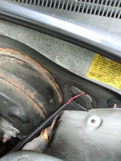

Okay, I took a video of what it sounds like. I also took another pic of that wire.This wire is about 3 feet long if that helps.Its color is red on one side white on the other. It's only one wire though.Thanks again for the help.

I hear the engine. Does it run normally in all other gears? Honestly, that really doesn't make sense. I do have a couple things I need checked. First, check to make sure there are no disconnected vacuum lines on the engine and the intake tube (from the air filter to the throttle body) is properly installed and not loose. Here is a link that explains how to check for a leak. Also, let me know if the check engine light is staying on when the engine is running.

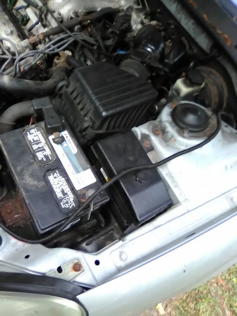

Next, that wire is not a factory wire. It looks like someone installed something aftermarket and that was running power into the vehicle or opposite. If you follow it (opposite of the firewall) where does it end? Is it near the battery?

I checked all the vacuum hoses. A couple were broke so I replaced them. I did that test on all the parts the site said to. I even cleaned the TPS and MAP senors. It seemed to work somewhat. It still sounds like it wants to stall but not as much as before. I have no codes on so I'm guessing the sensors are good. It only does it in park no other gear. The wire leads into the steering column. It's kinda hard for me to get to because I'm a big guy around the waist and they don't think of us big guys when they build these lol. I do appreciate all the help you've given me. I'm going to go buy some MAF sensor cleaner. I'll keep you posted on the outcome. Again thanks for everything.
