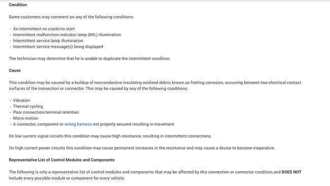

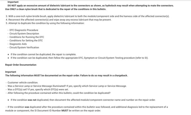

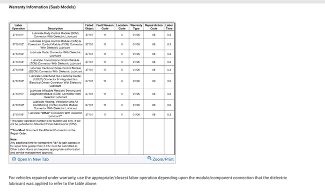

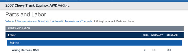

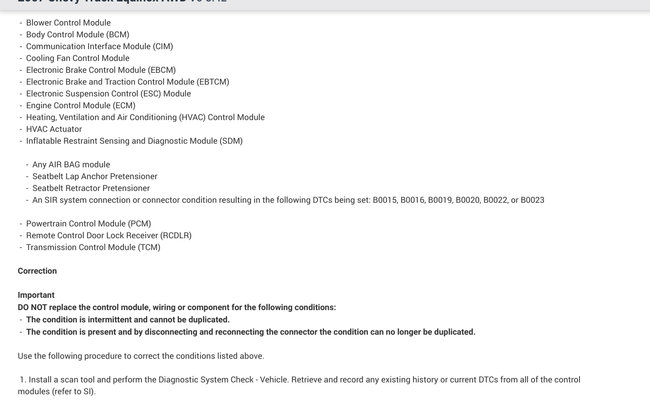

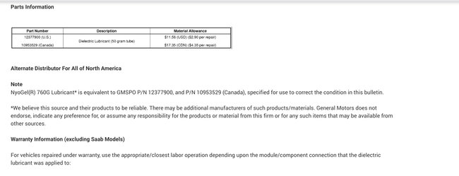

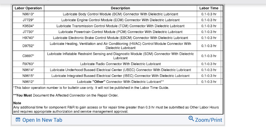

a rough estimate of how many hours max.
Dec 17, 2019 at 9:19 PM
SCGRANTURISMO
  • 4,897 POSTS
Hello again,

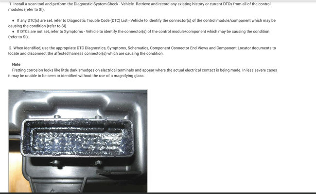

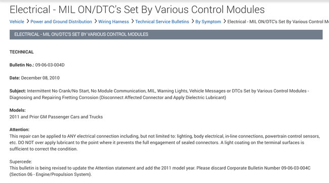

It is hard to track down exact times because I'm not sure of the systems that might be damaged, but this is what I was able to glean from our reference guide for wiring harness labor times in the diagrams down below. I hope this helps, but I could be a little more specific if I knew exactly the areas your mechanic was working on.
