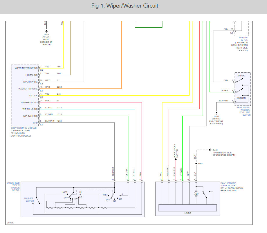

Wiring diagram needed that shows where the wires from the steering column attached to the motherboard in the wiper control switch
140,000 MILES • 6 CYL • 2WD • AUTOMATIC
DREW SMITH
Girlfriend's dog chewed the wiper control switch off . I’m attempting to reattach it, but I need a wiring diagram that shows where the wires that come out of the steering column attached to the motherboard in the wiper control switch.

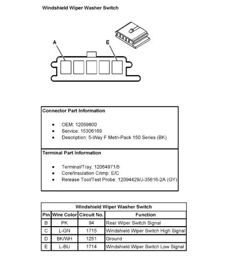

If there is a section of wiring visible there should be a wiring connection/plug that will be with the new switch.
Can you please send us a picture of what you have left from the old switch and the new switch with the wiring you have?
We should be able to work out from this what you need.

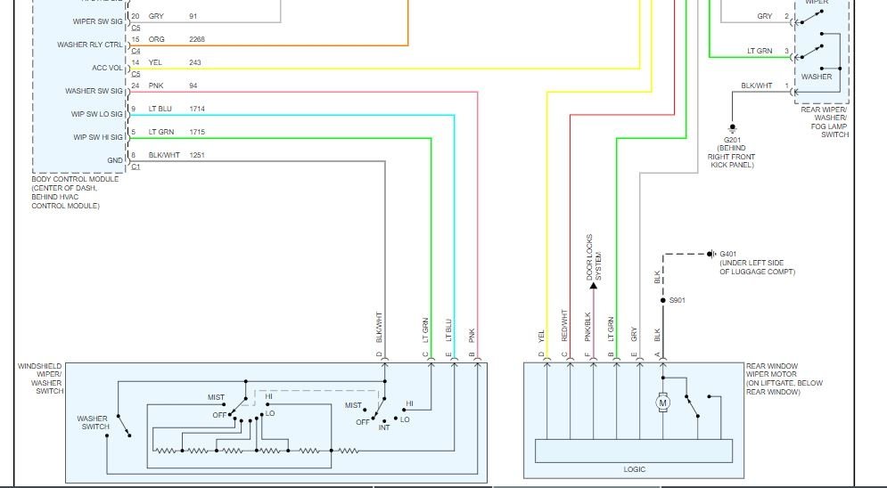

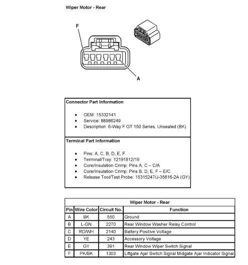

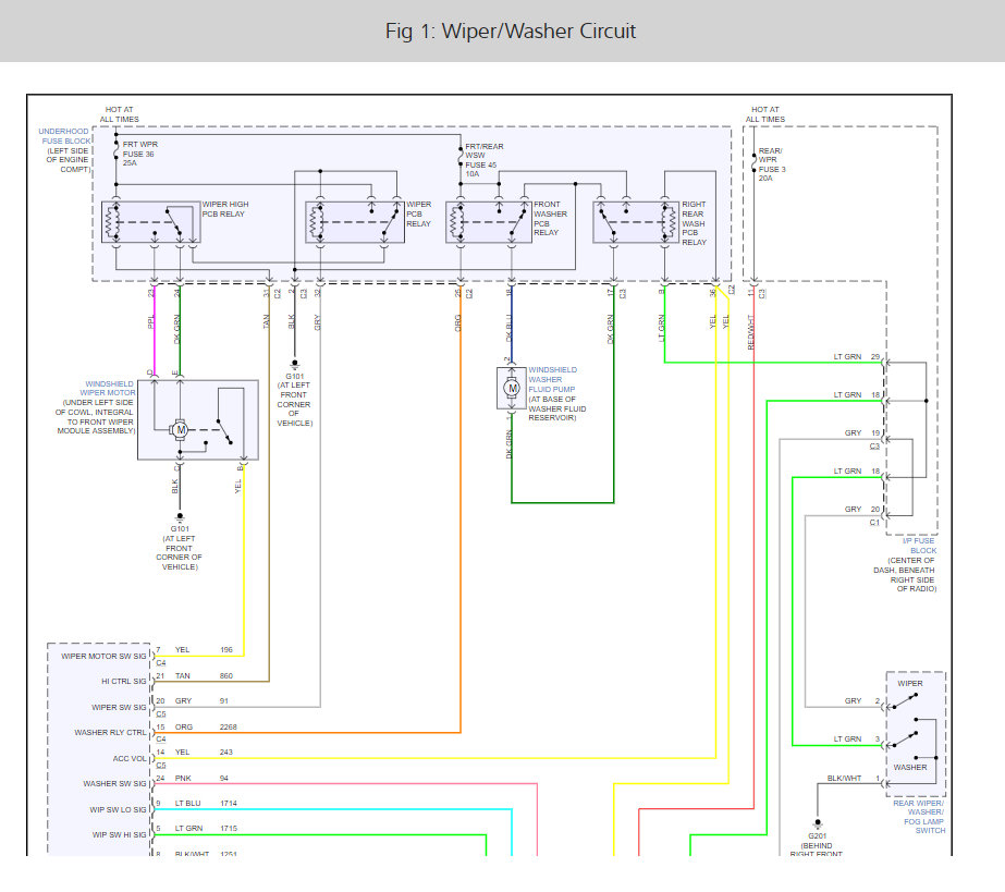

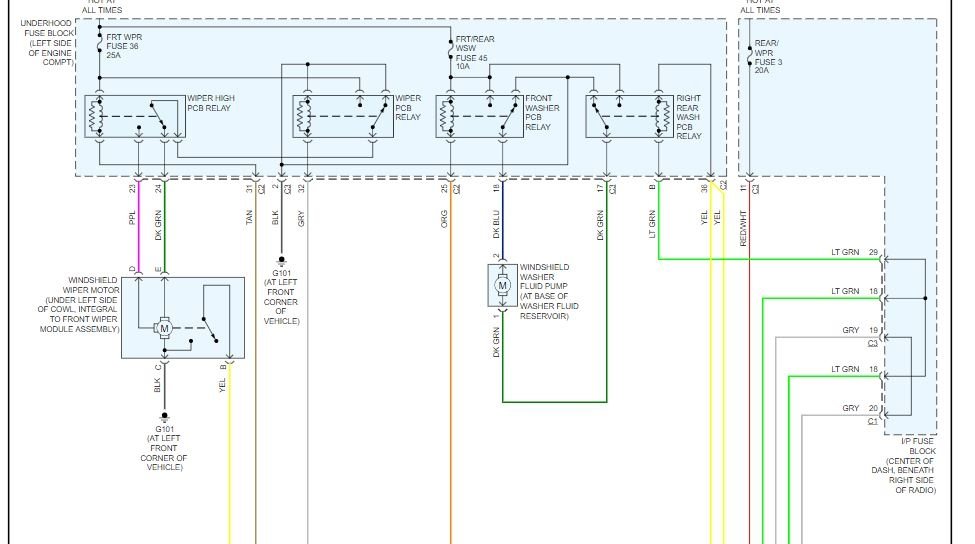

Here are the wiper wiring diagram and a guide to help you test the connections when finished with the repair if needed:
Feb 17, 2020 at 6:14 AM
Good afternoon,
Okay, I attached the diagram as well as the connector diagram with wire colors and where they are located.
