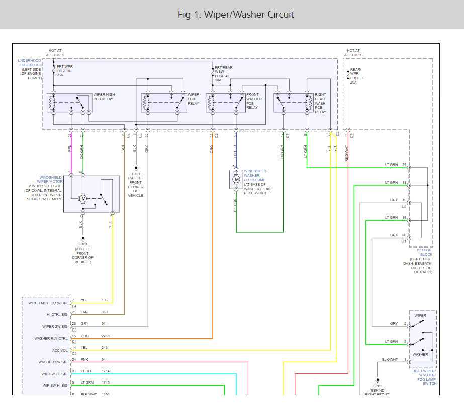

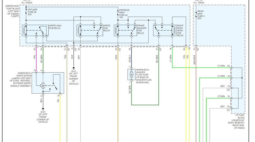

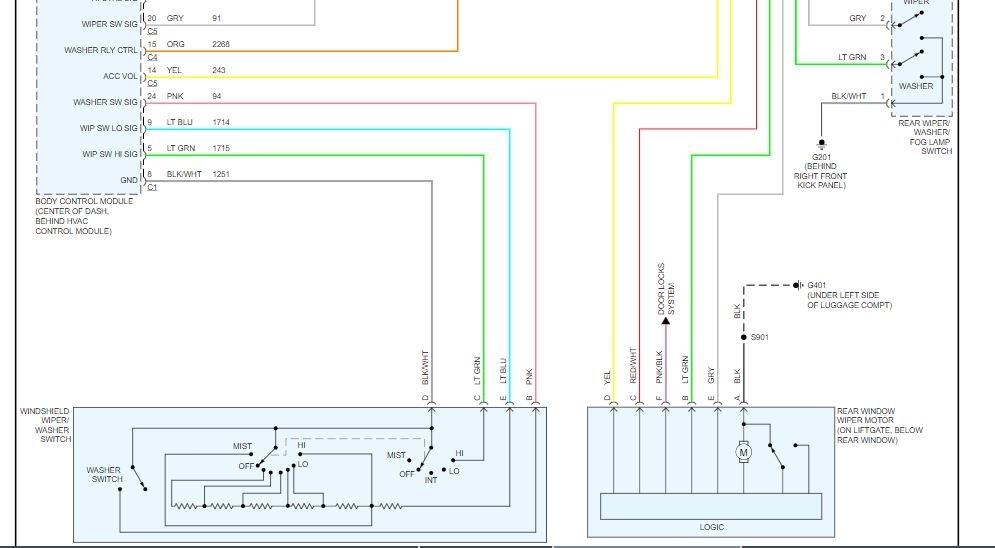

Wiring diagram needed that shows where the wires from the steering column attached to the motherboard in the wiper control switch
2007 PONTIAC TORRENT
140,000 MILES • 6 CYL • 2WD • AUTOMATIC
DREW SMITH
Girlfriend's dog chewed the wiper control switch off . I’m attempting to reattach it, but I need a wiring diagram that shows where the wires that come out of the steering column attached to the motherboard in the wiper control switch.

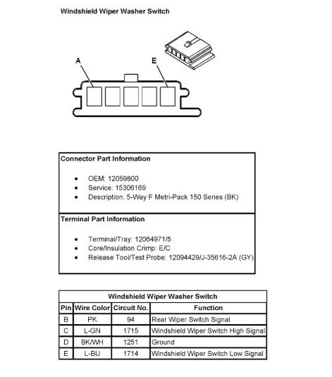

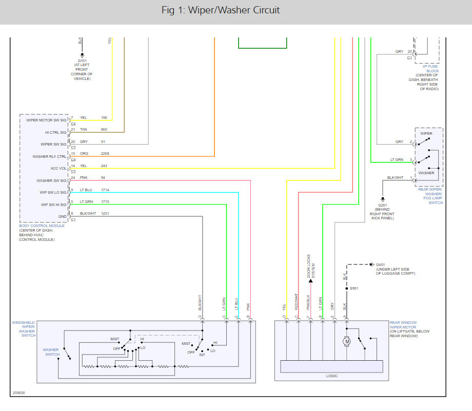

Here are the wiper wiring diagram and a guide to help you test the connections when finished with the repair if needed:
Feb 17, 2020 at 6:14 AM
Good afternoon,
Okay, I attached the diagram as well as the connector diagram with wire colors and where they are located.
