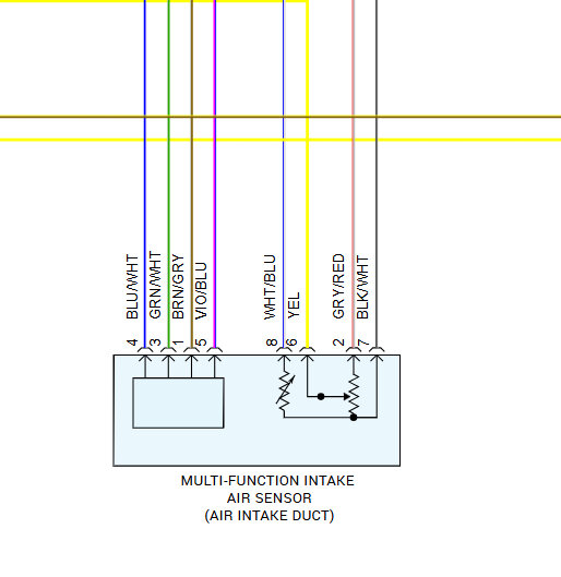

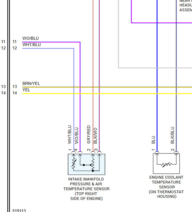

Air mass sensor wiring harness diagram?
2016 CHEVROLET CRUZE
116,555 MILES • 1.4L • 4 CYL • TURBO • 4WD • AUTOMATIC
LALLEN1980
MEMBER
1 POST
Apr 11, 2026 at 5:53 AM
Experienced Mechanic
55,710 POSTS
This car does not have a MAF sensor it has an intake manifold pressure sensor and a multi function intake air sensor. Here are the wiring diagrams for both. Check out the images (below). Let us know if you need anything else. Ken
