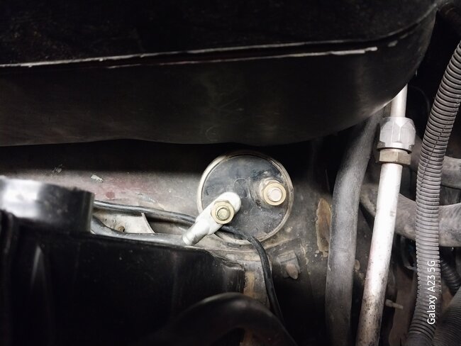

What dose this connect to or connect to it?

Thanks for the image and video, it looks like that is an aftermarket device I don't recognize, does your vehicle have dual batteries? also if you can back up a little when doing the pics and videos it will help me see more fo what's going on.

Okay, I hooked my positive up to the alternator, starter, and fuse hub under the hood my neg to the right fender well and front of the motor so what's this and where is the 2nd wire for my starter.

Does that lead come off of the battery cable itself, because on aftermarket battery cables then have an auxiliary power lead that is used in some applications but not all. If you can back up slightly with the video or image so I can see the arrangement it will help me see what's going on.

Okay, that thing is mounted behind the battery on the fender well and that is the only cable coming off of it and I can't see another wire anywhere that would connect to it but I'll upload pictures when I get home in the morning.

It looks like it is a junction block for the battery cables that is why I asked if you had two batteries. When you upload more images we can continue.
