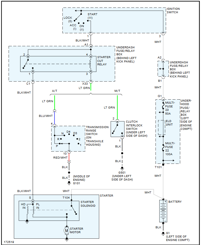

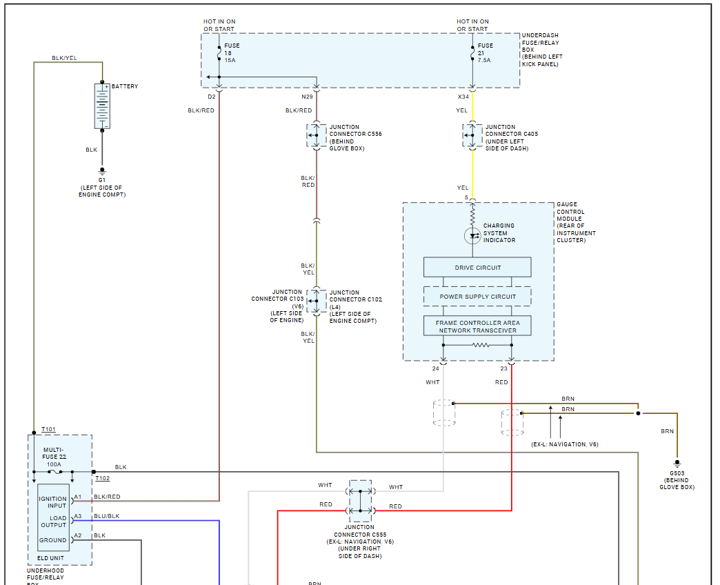

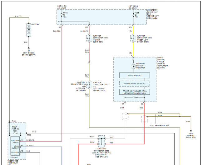

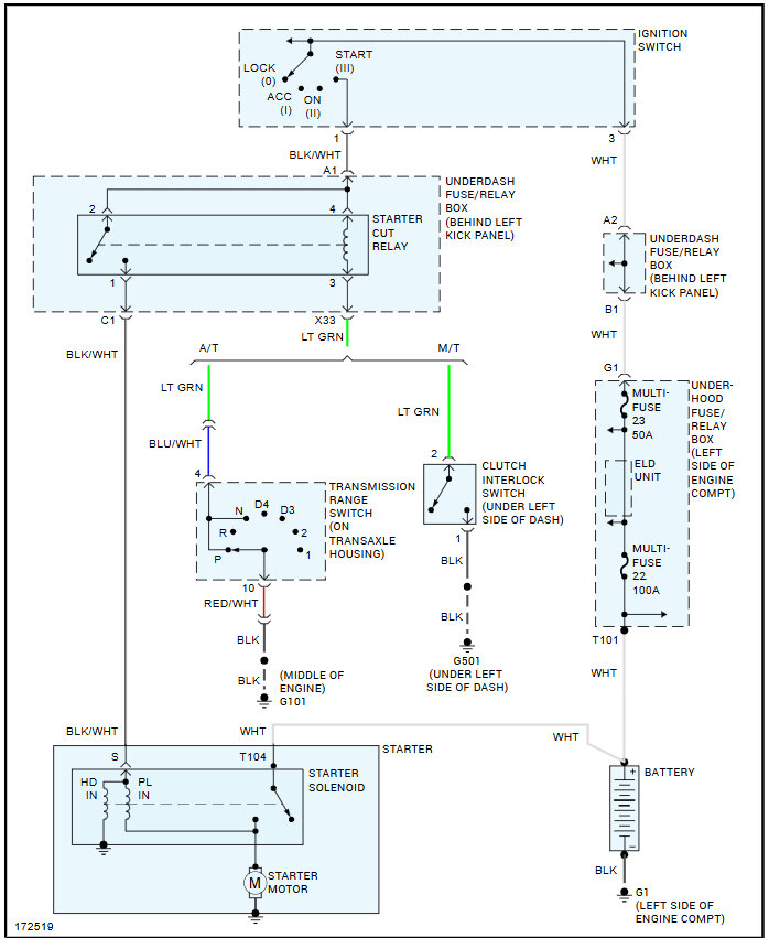

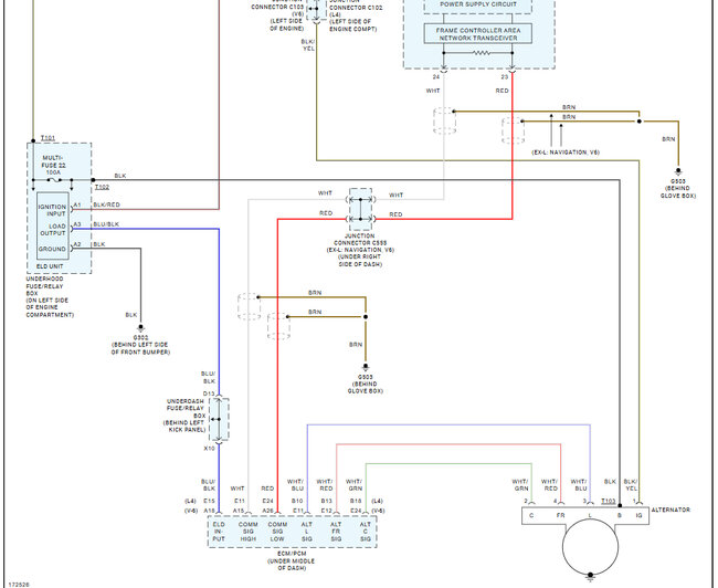

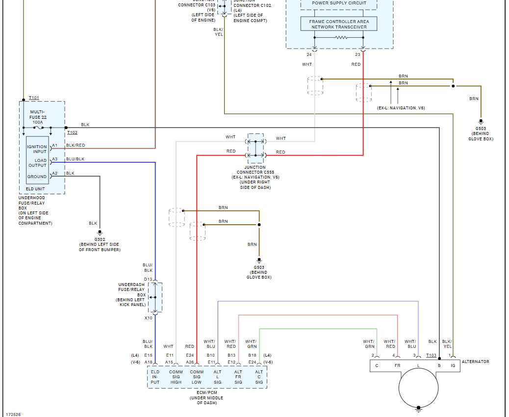

How do you wire from fuse panel in engine compartment to battery, starter, and alternator?
2003 HONDA ACCORD
207,000 MILES • 2.4L • 4 CYL • 2WD • AUTOMATIC
HOAGY56
How do you wire from fuse panel in engine compartment to battery and starter and alternator?
Apr 25, 2025 at 12:37 PM
  • 55,433 POSTS
Here are the wiring diagrams for the starter and alternator which show how the system is wires and the fuses involved. Check out the images (below). Let us know if you need anything else.
