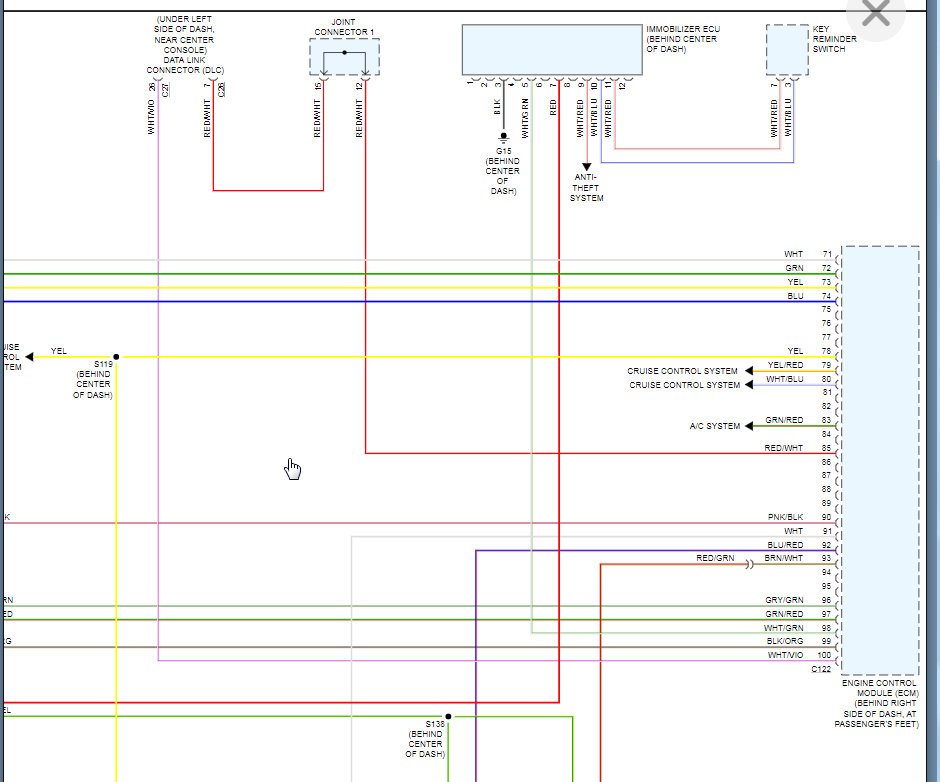

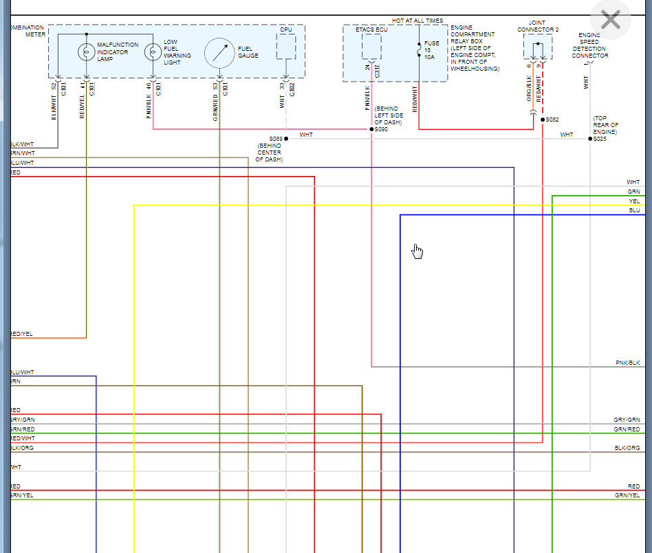

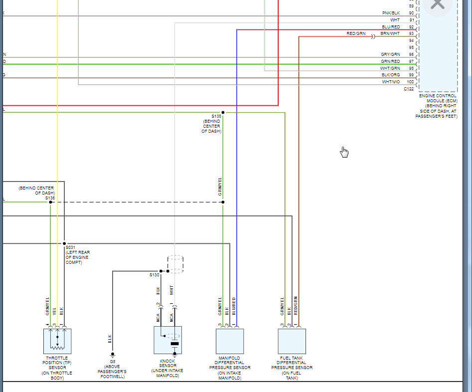

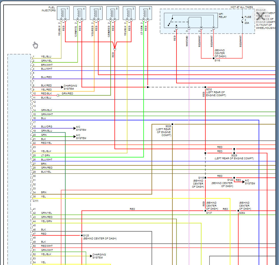

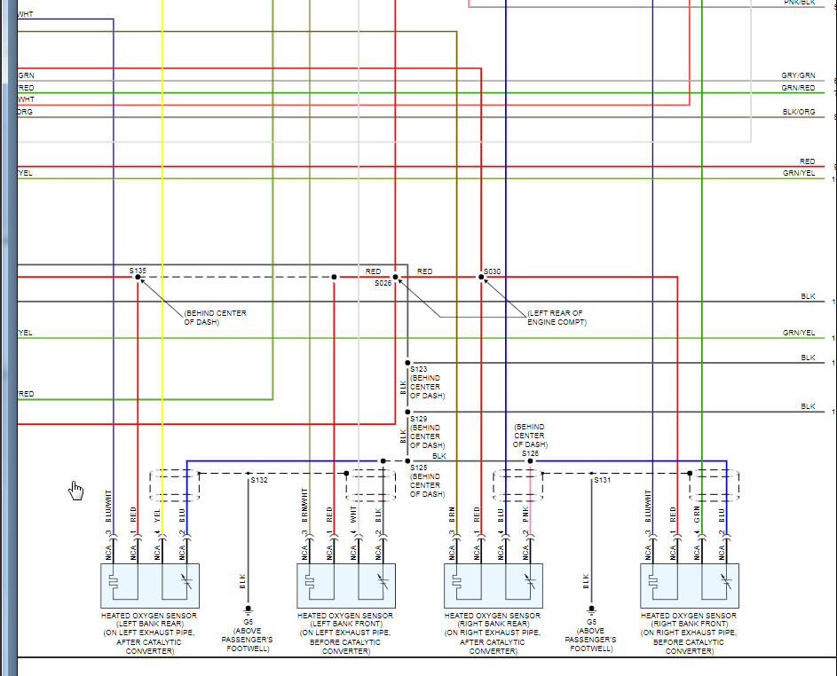

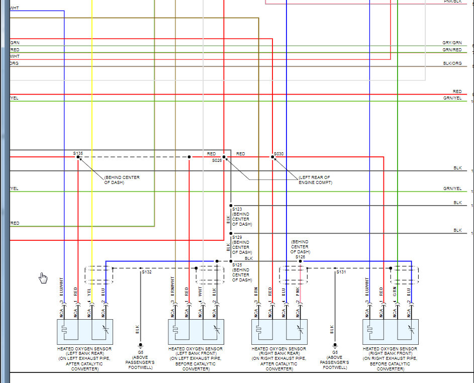

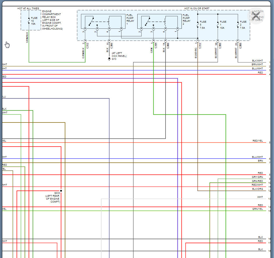

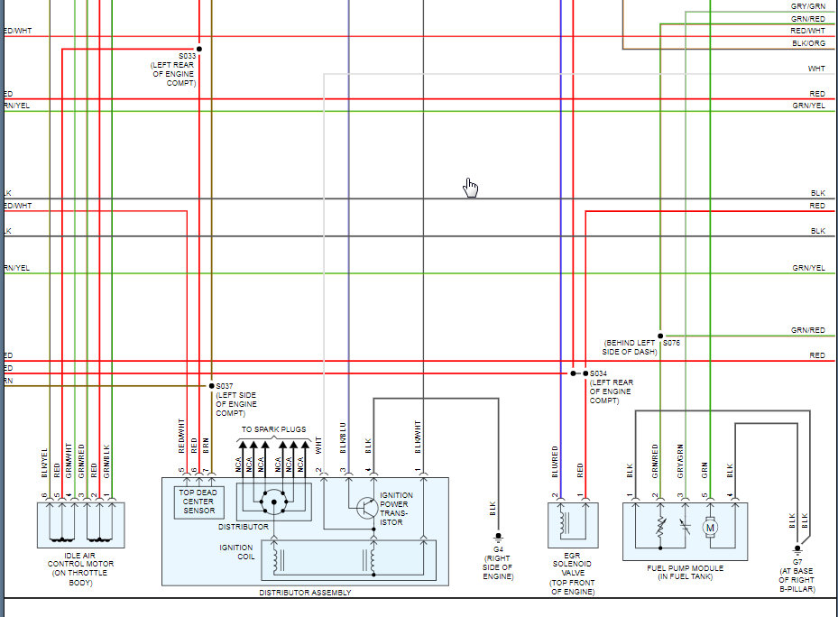

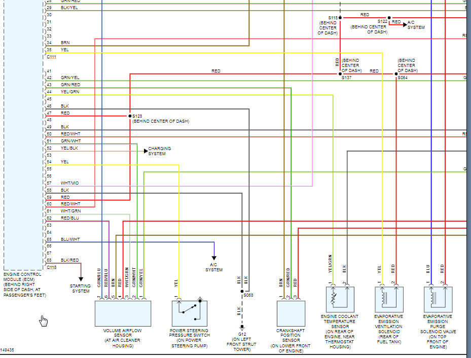

I am getting no spark and i replaced distributor 3 times already after the car has been sitting a while. ran on the first distributor, threw a cam sensor code, found out the sensor is in the distributor, now i'm not getting spark. i would like to check to see if my computer is bad because i am not getting a check engine light.
May 5, 2020 at 8:05 AM

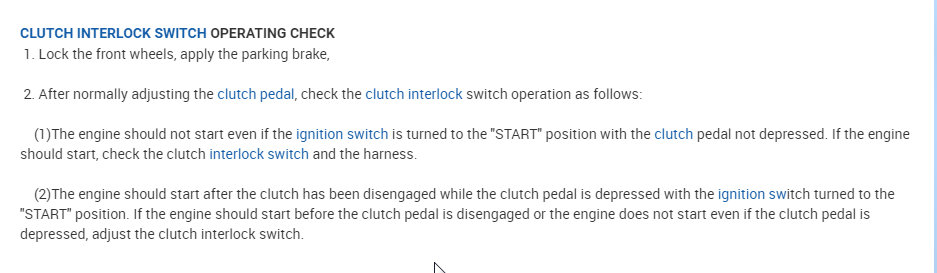

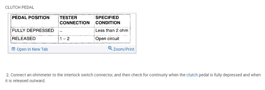

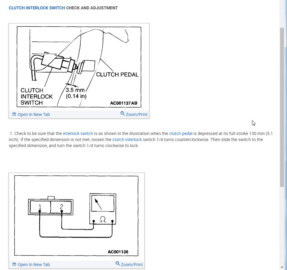

I attached the wiring diagrams for the ECM. Clearly it appears the distributor is the issue since it started after replacing one of them but have you checked the clutch pedal position switch? Maybe it was a coincidence that it started on one of them. Have you reinstalled the one that it started with and threw the code? If it started and threw that code and now it doesn't start, you can at least rule out a coincidence by putting that one back in and getting it to start and having that code come back.
I included the testing for the pedal switch. Let us know what you find. Thanks

Thank you so much. I do not have the old distributor, sadly, I thought about doing that, but after putting 3 brand new distributors on, i would think the distributor would be fine. i however had not thought about the pedal switch. It does crank and crank, just does not start and i did the spark test and they are not firing. I will definitely try that tomorrow though!
May 5, 2020 at 10:37 AM
Okay. Sounds good. Clearly that will cause a no spark condition so let's start there. If that checks out then we can move onto other things that cause no spark.
Let me know and we can go from there. Thanks
